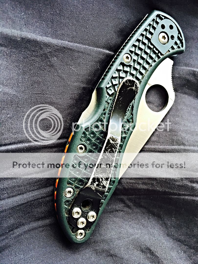

Yes, I like my ZDP-189 Delica just fine.
It's one of only three Spydercos I own and my main modern knife EDC.
I carried a ZDP189 Delica as my work knife for a long time and it never let me down .
I carry a HAP40 Delica now, but I wouldn't feel under-gunned if I went back to carrying the ZDP189 .
