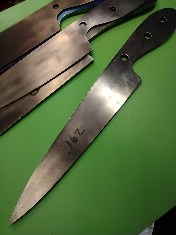

Ive made and sold 50+ knives with procut and had very very consistent results. Phenomenal edge retention and edge stability. 1550/cryo/300 comes to 66.5-67 every time, and for prybars (ive made 60 or so) 1700/cryo/ 400 comes to 61.5 every time. Just my guess, but delam and cracking comes from uneven temps when quenching not anything from the mill. My guess is they overheated the outside of the steel (probably using a forge) and didn't properly soak the steel and that caused the delam and cracking. Also why they poked it 20 times to get a hardness reading, they were probably getting numbers all over the place which is really unprofessional. Thats them trying to find one poke with a number that was acceptable so they could say it made spec. They knew something was wrong from the first 4 pokes, either they still have decarb or its under hardened.
I would think all the dimples would be from a carbide straightening hammer if I had to guess, not from so many Rockwell tests.
To my eyes, there only appears to be TWO hardness testing dimples, right between the two pin holes. I don't know what those dots scattered along the edge are, and they look different than the two dimples where people normally hardness hardness test, on the handle underneath where scales would be. If you blow the photo up, the two dimples between the pin holes have a brighter sort of "ring" around them, for lack of a better word.

The only reason to test hardness that many times is if the hardness readings were inconsistent. That typically happens from a heat treating issue. If the hardness values are consistent then testing 20 times on the same piece just tells you the same thing 20 times.

If I was a betting man id wager they heat treated it using a forge (TOPS knives do this too). This would explain the cracking and delam(inconsistent heating prior to quenching caused stress cracks and delam) and why they were poking at the edge as thats where the blade would have been the hottest, where it would hit the oil the fastest and thus give the hardest readings.

That ring is the steel "pushed" up. It happens when you poke very soft steel. They also would test at the edge if they used a forge to heat treat them because the edge would be the hottest and thus be the hardest readings.

Here is a old 8670 blank I dug out, I'm counting at least 13 test dimples. This batch is unbelievably tough, durable, holds an edge perfectly.

Maybe we're looking at 2 different pictures. The one I'm talking about the one with 20+ Rockwell indentations. Carbide hammer marks are much wider and more shallow.
Yeah I couldn't get the right pic to load at first and made an assumption based on the written description. I can see the pic now and it's obviously not a carbide hammer. My bad.
