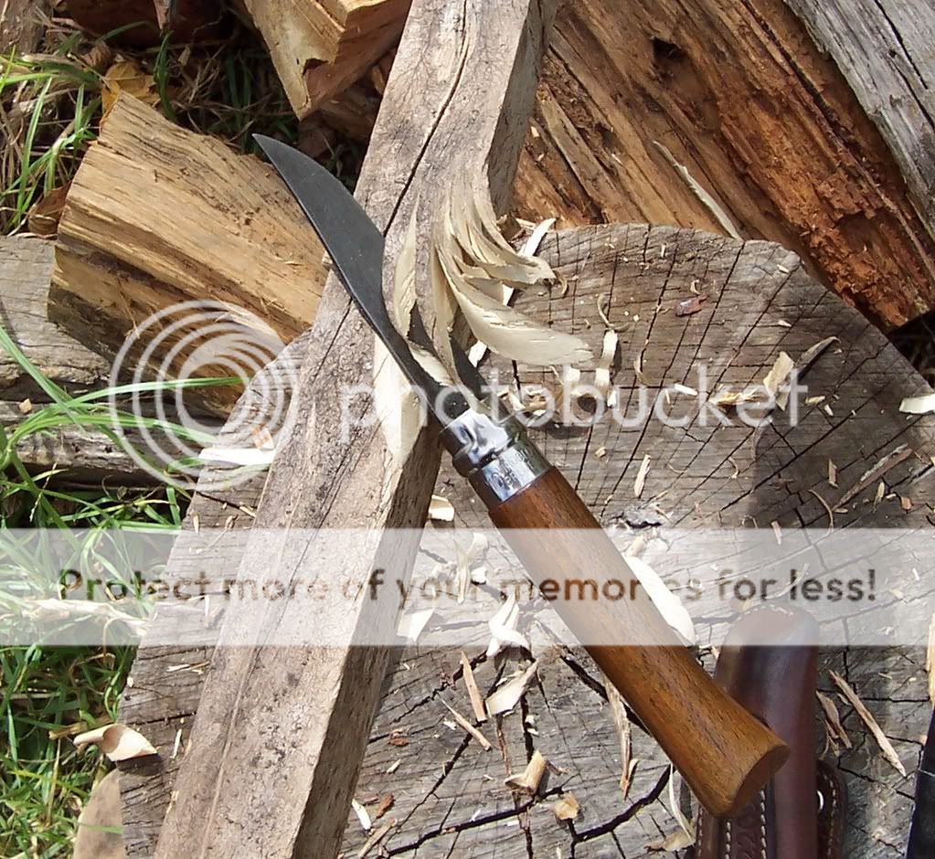

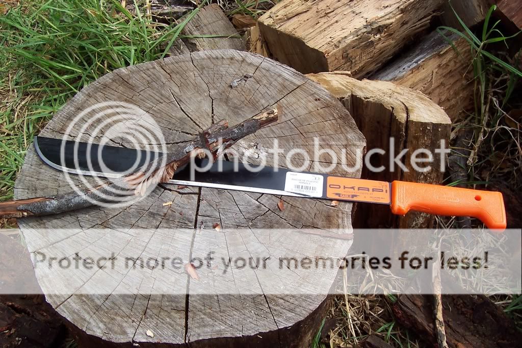

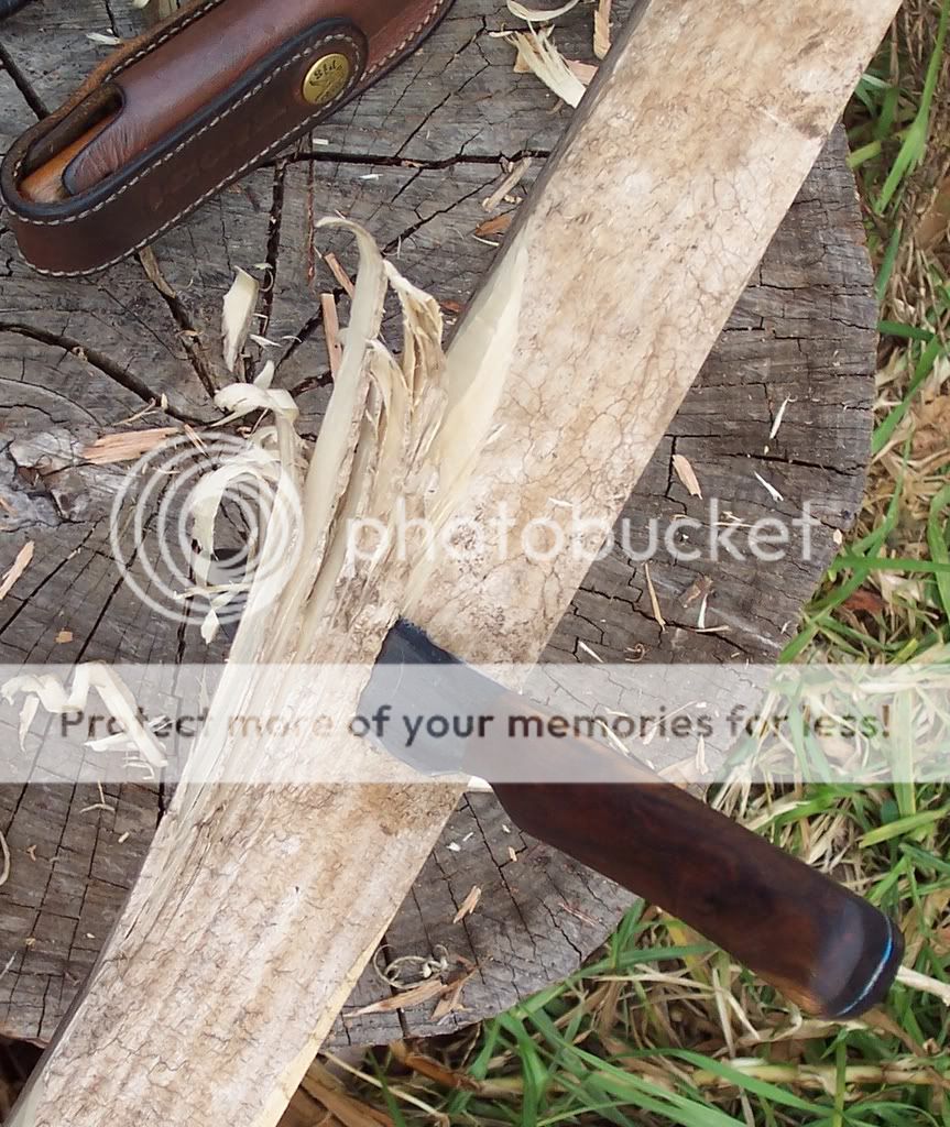

I was messing around with a machete making fuzz sticks for the hell of it
its a LOT easier with a smaller blade tho ...

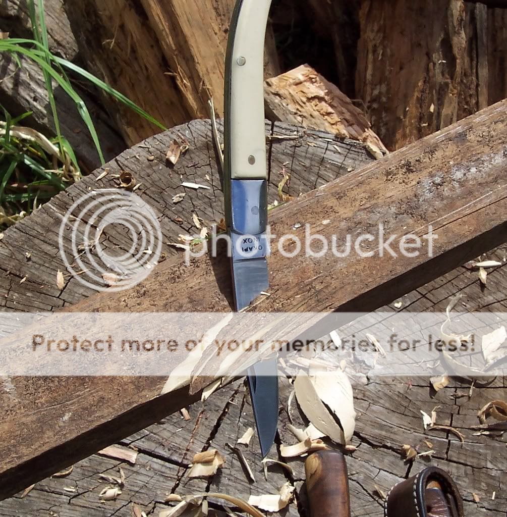

for the hell of it , and cos I had time to kill I figured Id do some research :)
I had a piece of cruddy plantation pine roofing batten , full of knots , horrible grain , brittle nasty wood , nothing uniform about the timber at all .
I also have a steadily growing collection of under $20 knives that I pick up from all kindsa places , so I figured I would have a go at making feathery stuff on the stick and see what worked best

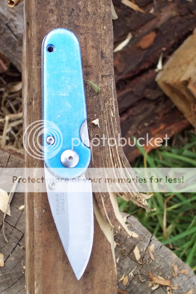

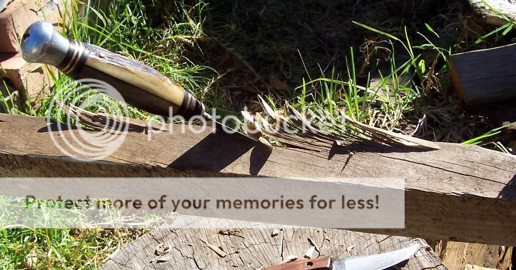

first up is an AU$10 Excalibur "Judge" it was actually a bra knife for my Mother but she used the knife that much the thing lost its clip and a screw or two ... now she carried a gerber in her bra ...enough about my mothers bra , this is the knife and the result :
it cut the wood OK , but the feathers didnt feather much , the knife is small and uncomfortable to hold in my kinda big hand it did OK but I probably need to practice more with it to do it any justice

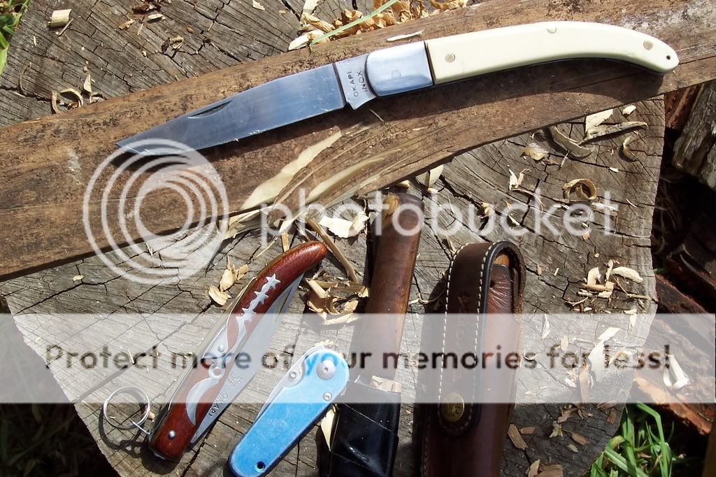

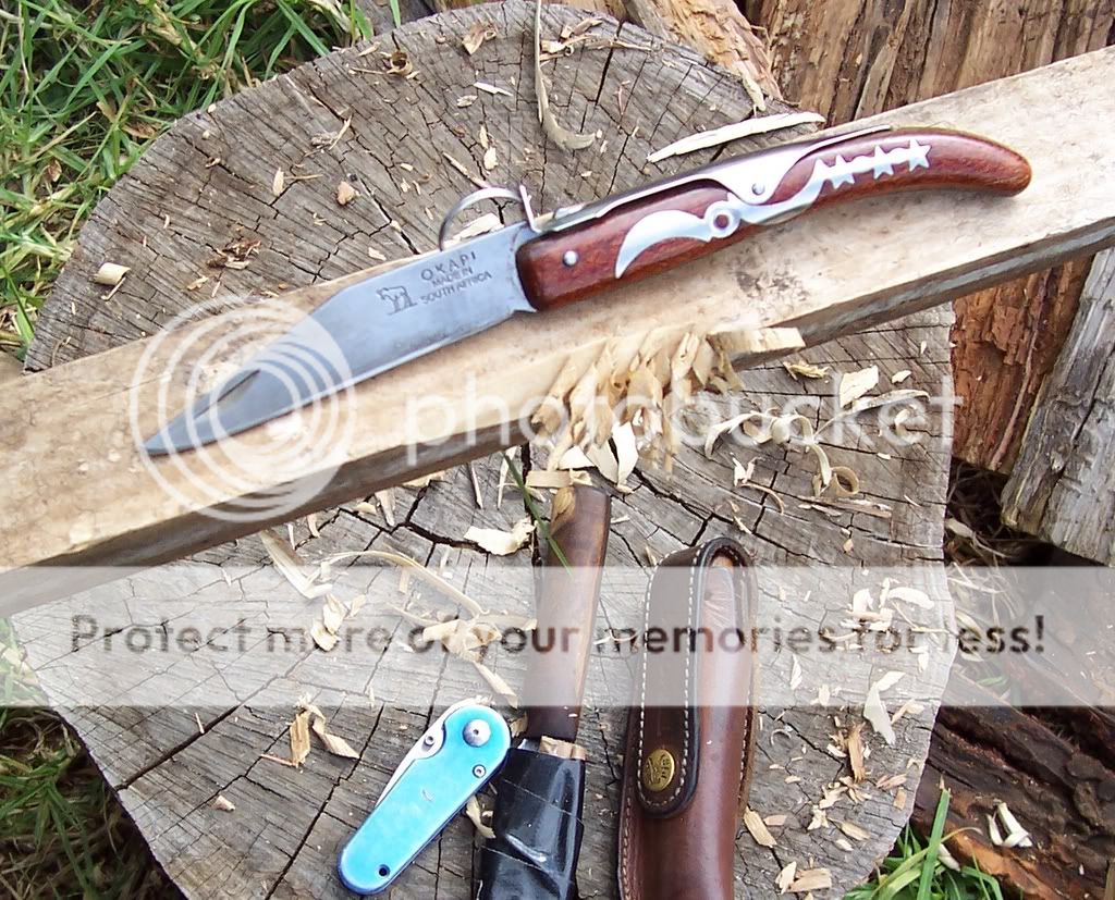

Next up was my Okapi , AU$12 it did OK , the wood seemed more brittle than the rest where I tried it , but it took off curlies OK , a lot more dropped off than hung on but anyway , here is the result
my eating knife , another Okapi , a slip joint , about AU$15 worth , it did OK suprised me actually , I got more respect for it now .

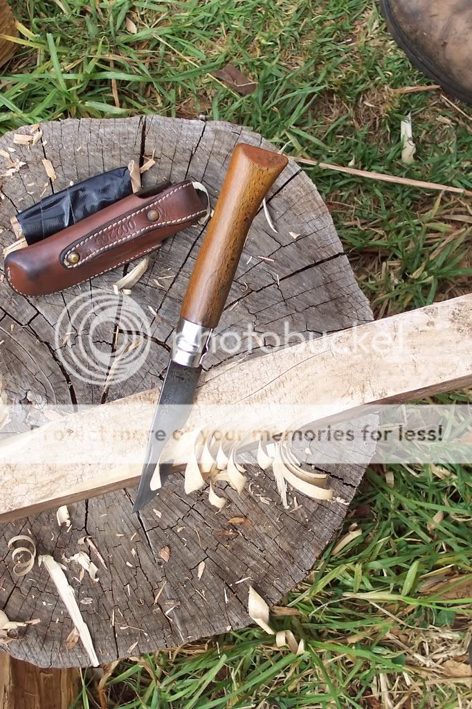

My opinel volunteered next , its a little #10 , and cost me $5 IIRC a few years back now .

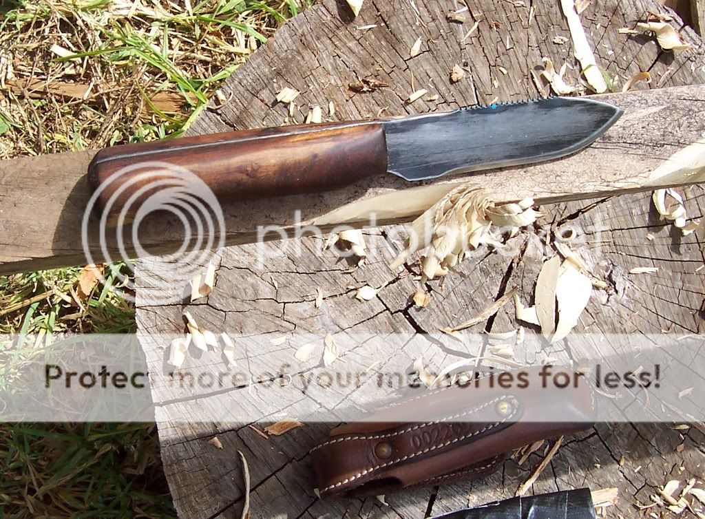

next up is a little thing I made myself , it wanted to have a go so I gave in and let it , it seemed to put in a good showing for itself
work in progress , limited by how many pics I can stick in one post ..to be continued

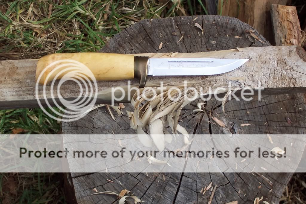

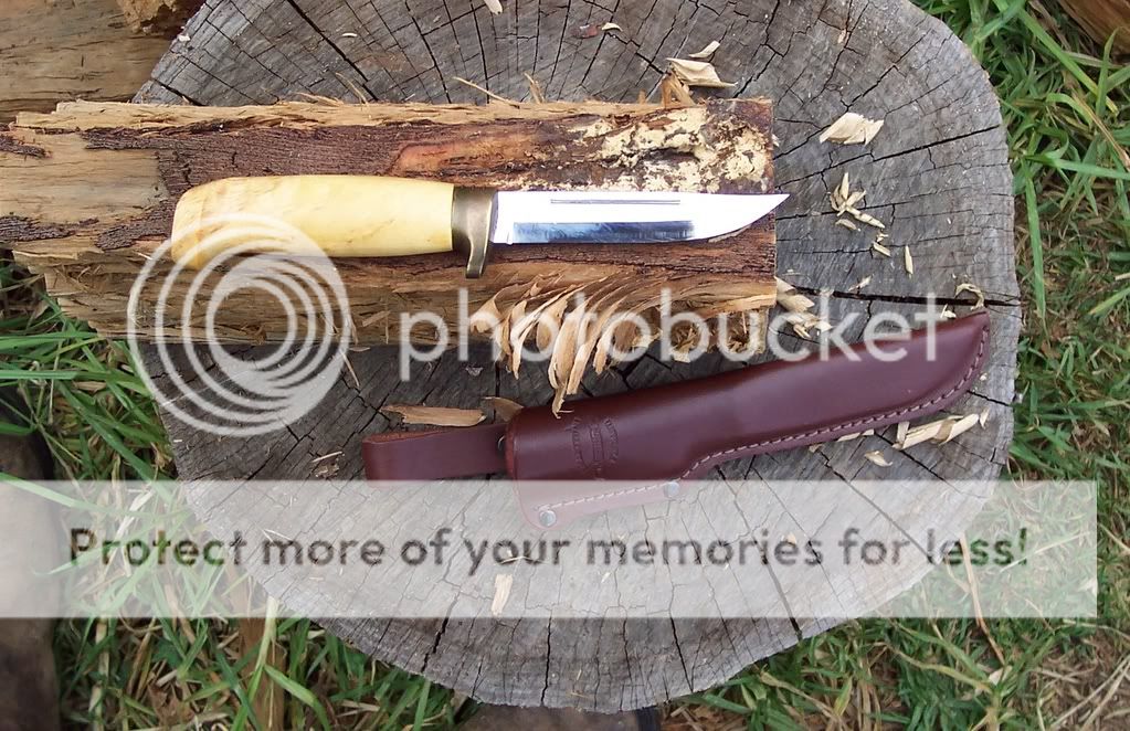

I have a marttiini that needed exersize , I want to mention that I have been hesitant to use it much because its a cheapo stainless job that cost $15 on ebay , it is however a good knife , as much as I am not a fan of stainless , I am impressed with this little knife .
still more to come but the pics are still uploading and I gotta go get the kids from school :)

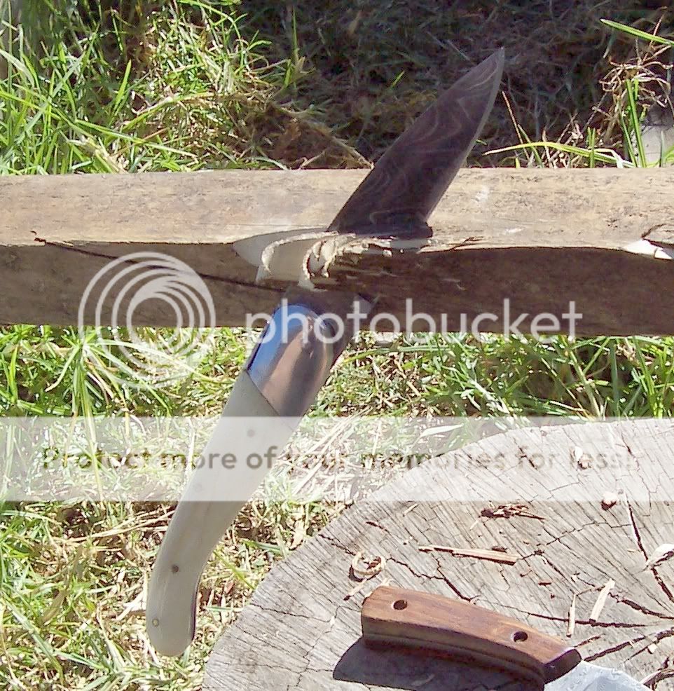

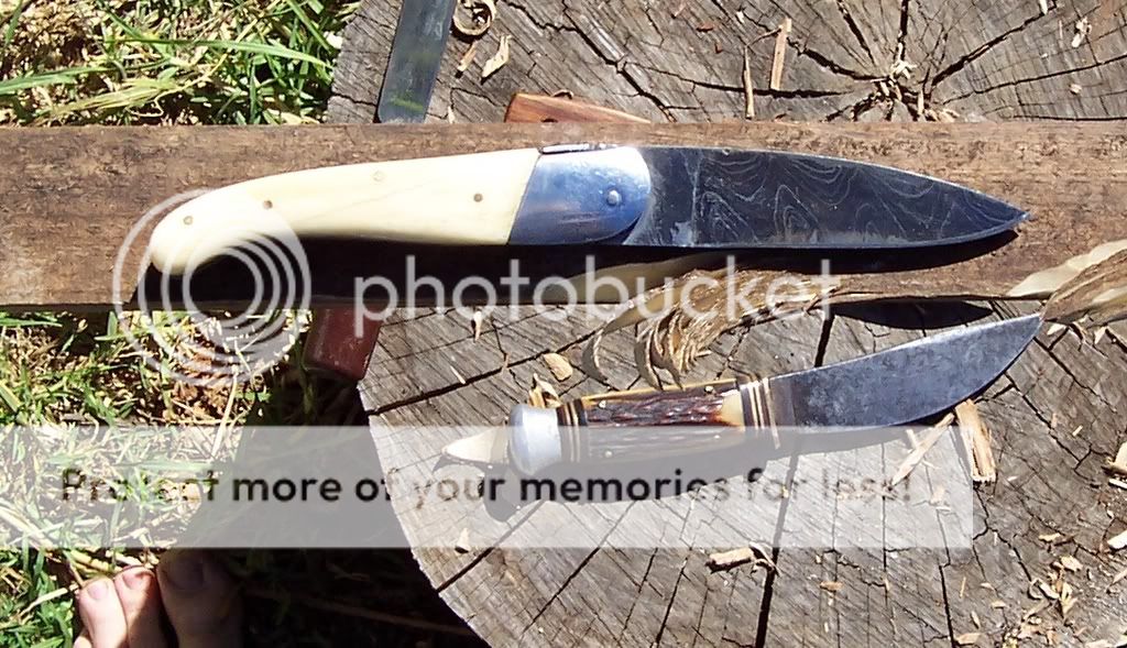

Ok the saga continues ... this is a damascus liner lock , camel bone handle , nice to use , seriously nice to use and a tad shy of $20 to buy IIRC.
it was actually easier to use than the Marttiini was .

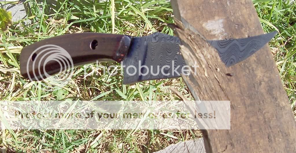

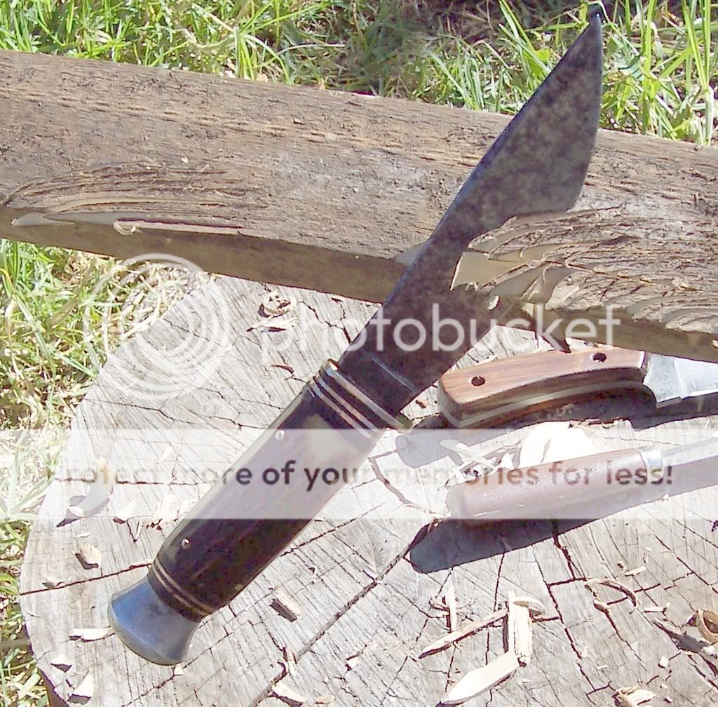

Next was a damascus knife that I picked up cheap , actually got a bunch of them and gave them away , they cut seriously well , now Im regretting having give them away , shoulda sold them instead :)
I cut the slices , but they didnt curl out so I actually went back and shaved them into smaller slices , I dont know if I could have done that with any of the other knives I tried out ...

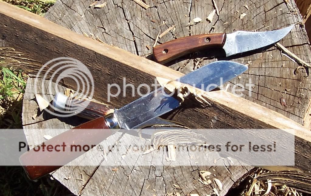

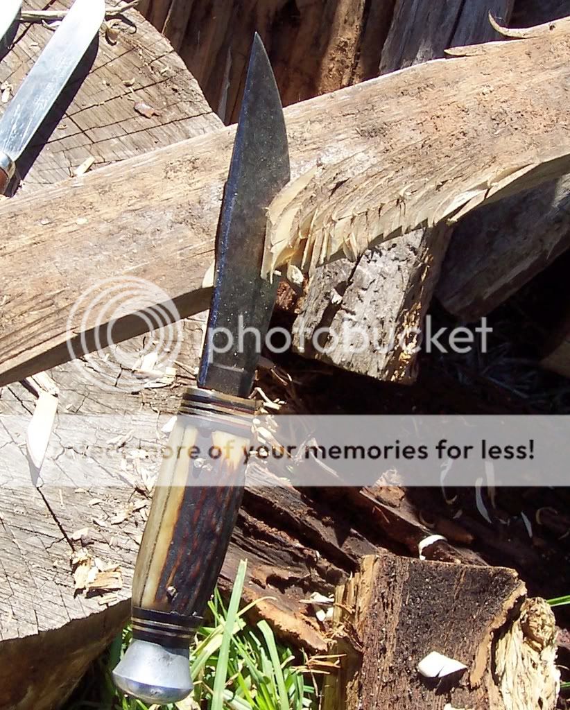

Someone mentioned that a thin blade helps , I figured I dont have a much thinner blade than my okapi GP .. so I gave it a go it did OK
finaly the one that was easiest to use , cut the best , and was all round winner I guess ... its an old thing that looks like a marbles job that I got off ebay for a bit under $20
well , thats my contribution anyway ...
maybe itll help someone ...

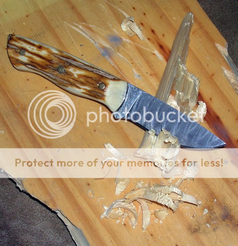

here is a fuzz pic of my little and only damascus
with mammoth bark scales :)
