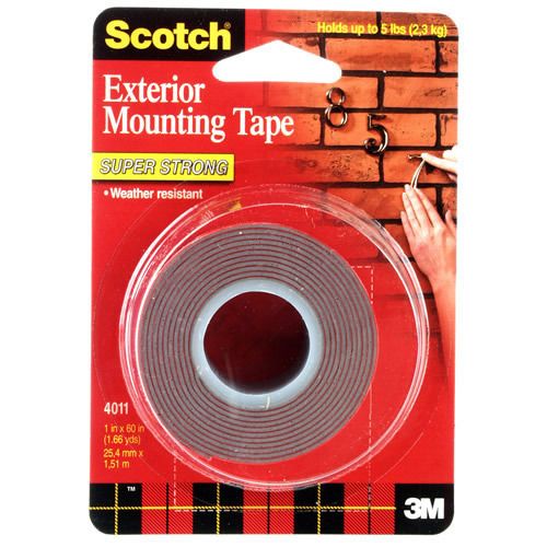

Don't use glue. Use double sided exterior mounting tape.
Weld a small ledge on the bottom of the platen - no matter how you put it on - for when TSHTF.
Keep in mind that nothing is ever going to try to PULL the platen off. You're always pushing against it.
If you must remove the ceramic, you can cut through the tape with a coping saw and keep your ceramic intact.
I've used this method for over a decade on many platen arrangements and sizes.

Thanks Karl. I'll look into that. But I'm looking for a quick change type deal. So I can profile a blade without the glass, then start doing bevels with it. I think I am just going to have to build another removable platen. I also really want a wheel attachment! :eek: Just don't know if I want to spend $300 on one.

The double-sided tape Karl described makes a whole lot of sense... :thumbup:
