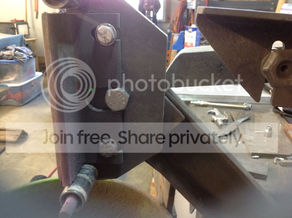

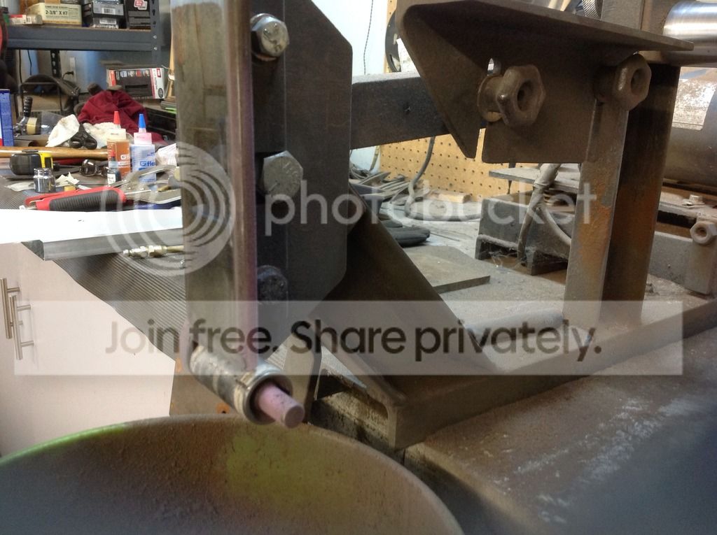

You could make another platen for your ceramic. I made mine removable so I could use the slack belt for handle shaping. Not sure how you made your grinder but here are some pics of my setup. It's just 2" mild angle with slotted holes. Don't mind the mess I'm cleaning up today:D
What do you have on there for wheels?
Water pump bearings. Jockey lot for $ .50 a piece new. I have taken a bunch apart for different size wheels. I'm sure you can order some similar. These are 1" O.D.
