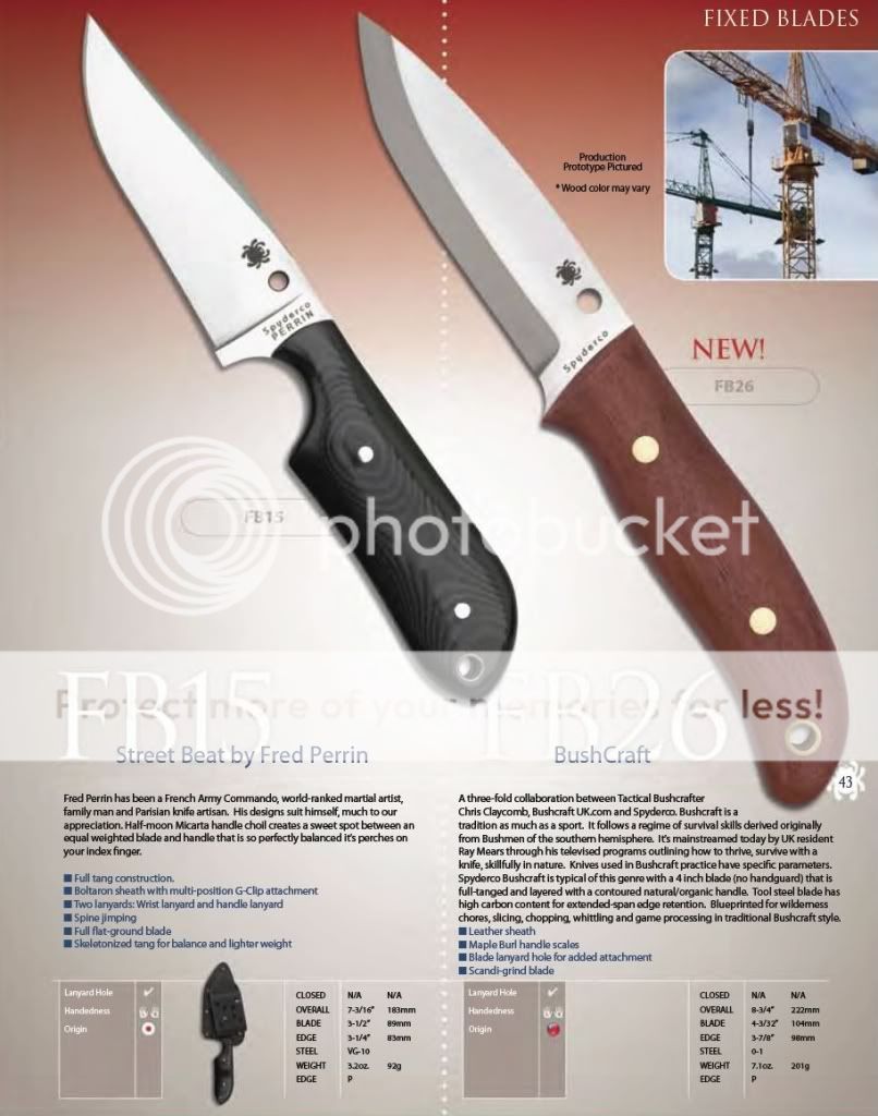

you can go to spyderco website and download their new '09 product catalog. its in there... no price but its in there!
Spyderco 2009 Catalog pg. 43
