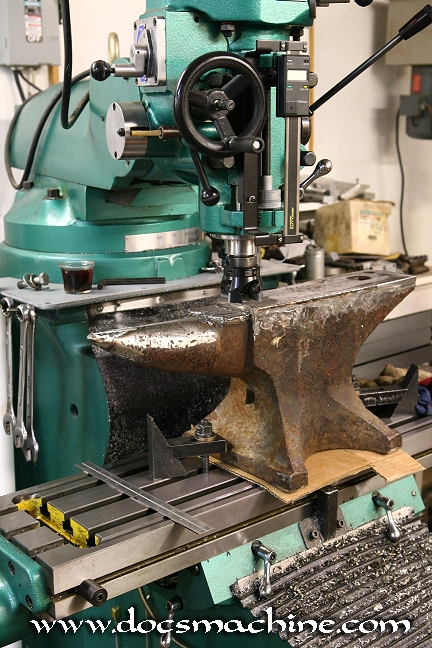

A huge word of caution for ANYONE thinking of milling the surface of an anvil flat... LEVEL THE BOTTOM FIRST. Most old anvils do not have paralell faces with the top and bottom. I know someone who ruined a perfectly good anvil because they didnt realize this and while they had a perfectly flat face... they had no 'face' on the whole rear of the anvil because it was milled away.
