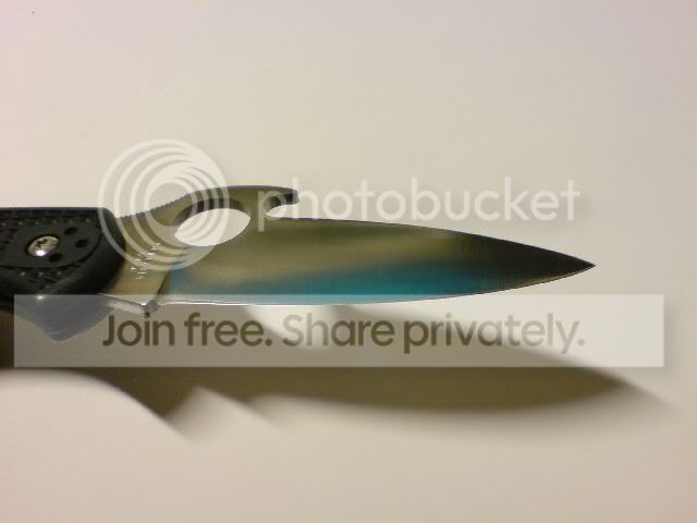

Overall the D4 is an excellent knife . However the grinding on the edge is imo improvable. I prefer theD3 grindings; bladeshape-wize. For this size knife i prefer a more accute tip and flat or full flat grinds and the sturdinous of the d4 handle combined with d3 bladeshape and flat grind.
Here;s my D4W full flat grind;
Maarten, nice looking knife. Was that done with a belt sander?
