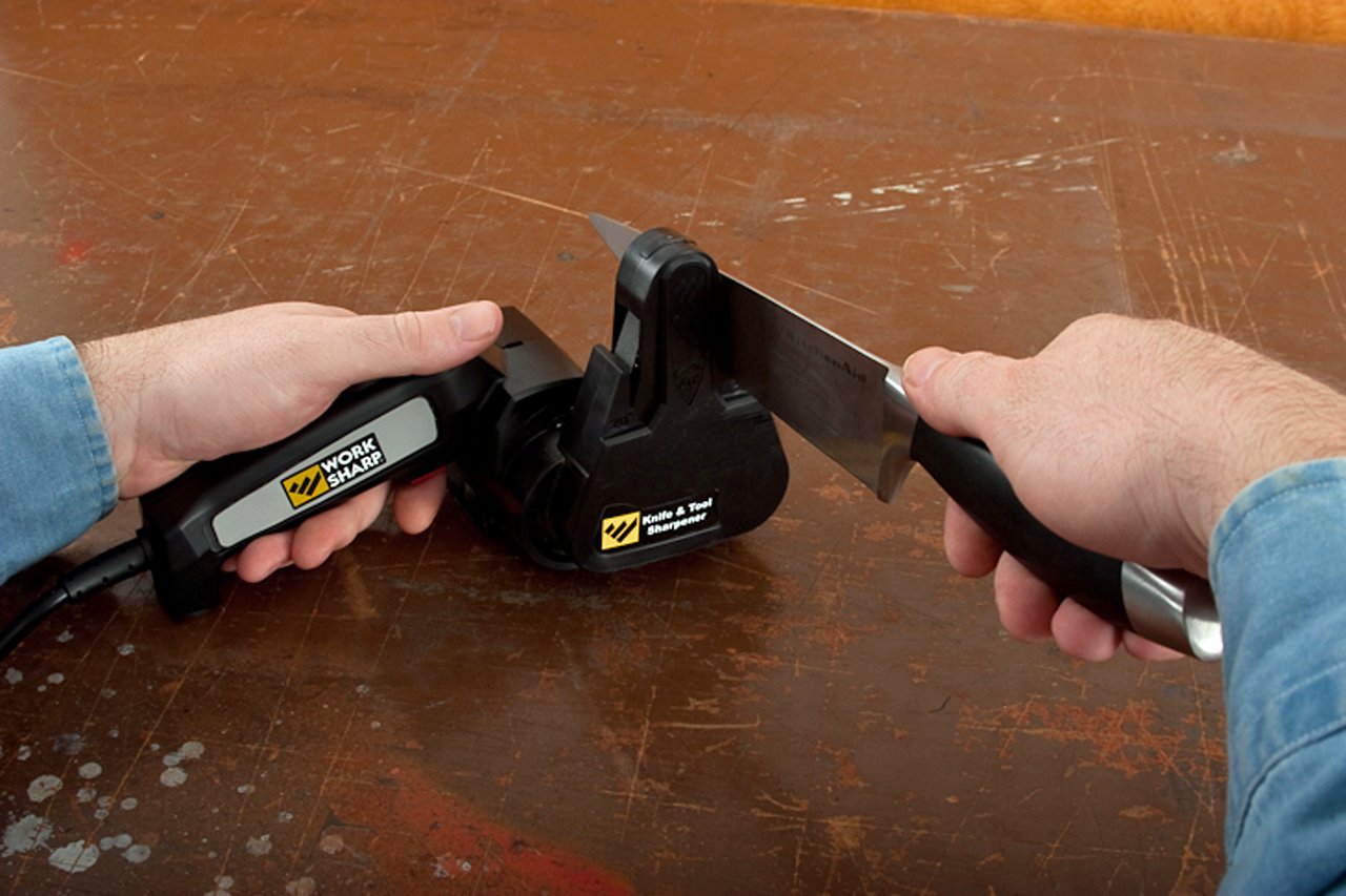

Anyone ever use one these to sharpen your knives???
Nov 8, 2014
11
Work Sharp WSKTS Knife and Tool Sharpener
And yes I know the Wicked Sharp is way better the price for this one has me looking at it.

It's worth the price to upgrade to the ken onion edition. Its even more worth the price to get the blade grinder attachment.
I would get the ken onion model too. it seems a little beefier build and it has variable angles. If all you were doing was kitchen knives the original would be fine. But for someone who wants options the ken onion model I think is best. Not as good as the wicked edge? that is debatable. I would take a work sharp over a wicked edge. I prefer factory edges. And until the work sharp it wasnt the easiest thing to achieve. And even if you prefer high polished V grind edges I am weary of any sharpening system that actually clamps the blade. They do that to maintain a consistent angle but if your knife is really long that angle can drift as you work your way to the tip. I like the fact that by clamping you keep the blade perfectly straight at all times but you lack the ability to draw the knife back like say with an edgepro apex. While its a bit harder to keep the blade flat on those at least you can move the portion of the edge you are working on to maintain that consistent angle. Ill tell you though, I have strongly considered selling my apex to pick up a work sharp. I just worry I could even screw that up, lol.

If you get it make sure to get plenty of belts. They wear out quickly and are nearly worthless once the grit is gone.
Just learn to sharpen. That will benefit you in the long run.
I've used about everything, and I've never seen a contraption that is easier to screw up a knife tip than the work sharp.

Big differences between the original WorkSharp and the WSKO:
1. WSKO is variable speed in 14 steps from pretty darned low to full speed.
2. WSKO uses 3/4" belts instead of 1/2" so they have more surface area.
3. WSKO has more belts included with the system (5 grits instead of 3) that are spaced more reasonably, so you aren't jumping from 220 grit to 6000 grit like you are with the original.
4. WSKO has more belts available for it in different grits and abrasive types.
5. WSKO has an adjustable angle guide. Wider range of angles, but it's also spring loaded, which means it doesn't provide a super firm surface to run the blade against. This might be a negative depending on how you look at it. I've never used the angle guide, so I couldn't tell you for sure. I use the WSKO freehand.
Whoever here said the WSKTS is dangerous is probably right. The combination of the included 80 grit belt, plus FULL SPEED only is a dangerous combination. It's one BIG reason I waited for the WSKO. Sure you can still destroy a blade with the WSKO, but you've got variable speed so you can at least turn the speed way down to be safe as you are learning. That's what I did, and I haven't messed up a blade yet.

Just remember that if you're only sharpening to use the gray belt as it won't completely reprofile your knife
I dont like work sharp because it is a slack belt system. There's so support behind the belt, so it bows as you work on it. Great for convex edges, horrible for anything else. If they made one with a flatbed support I'd probably buy one.

I have the ken onion edition and I recommend spending the extra. There are a lot of features that make the extra cost worth it in my opinion. It takes a little to get used to so don't start out doing super high end knives. I can get my knives razor sharp with a mirror finish. It takes a bit of practice, but I find it to be a very good quality sharpener. The only complaint I have is having to practice quite a bit before getting efficient. Yes the belt do wear out, but expecting a belt to last as long as a stone is like apples and oranges. Overall, I find this extremely useful and I use to with all of my knives.
What is to be done with the integral bolster on the knife in the original post. Would you use another part of the belt to grind it down when needed?
