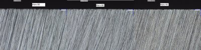

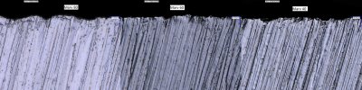

I apologize. Detergent = dish soap. Lost in translation. Loose grain on the dress might have been enough. However, I have access to a microscope.
Photo of the surface after grinding new/dress.
More than 500 passes
Currently, the photo of Atoma's new dress is identical.
There are black dots in the 0.5μm stone, but it does not appear to be agglomeration. It is more likely due to adhesion. The submicron particles are so small and both surfaces (stone and edge) are so smooth that they stick to each other and the diamond stone tears a piece of material from the steel. Here is one example where I deliberately tried to show what I mean. Mostly, these are just individual thin scratches, but they are visible to the naked eye.
In the manufacturer's words: "The black spots are a regular occurrence on this stone, you do not have a faulty one. It is part of the manufacturing process for this one. The mixture is so abrasive that part of my mixing equipment gets abraded. As I use disposable mixing equipment to avoid contamination, this is not a huge issue. The equipment is made from PET-G, so the hardness is comparable to the resin used."
He also stated that most testers are very satisfied with the 0.5μm stone and that the problem may be my KMFS Vantaedge grinding set.1000024820.jpg
