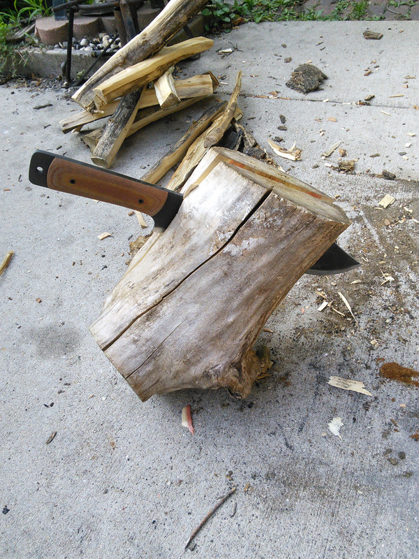

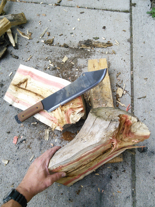

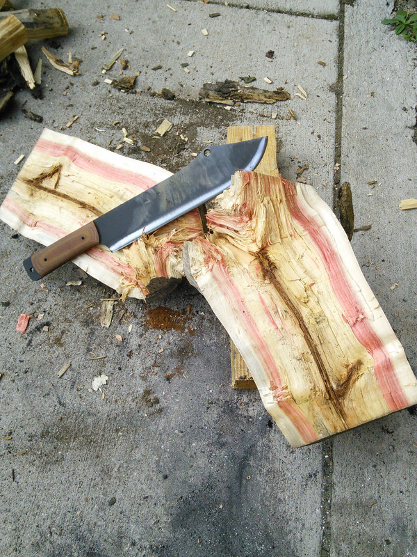

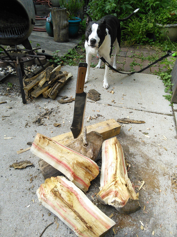

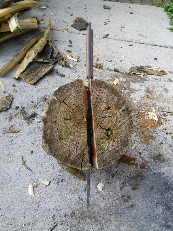

Something from when I bought one.....
Love the large, awkward blade, but the handle needs work.

I'm glad that's working out.....
I've never been lucky, and always have had to catch & release his because of the small, thin handles. I stopped buying them for now. Unless I could maybe hold them in person, I doubt I'd find a fit I'd like, but I know people seem to like the looks of Bill's knives, he gets lots of praise

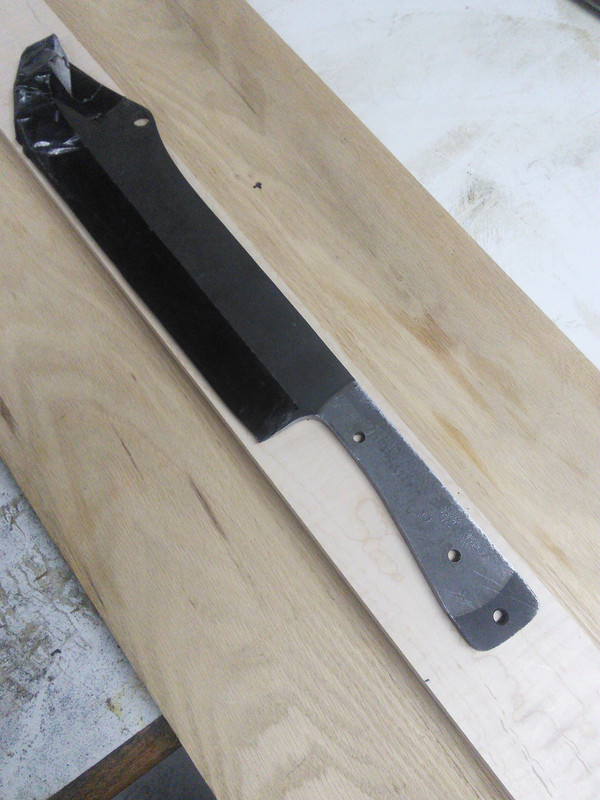

Taped up, working on the handle grinds, with maple underneath... thinking of using something old school...maple, and brass? Idk?

Wow that’s a monster!!
Lamb Splitter yeah?
You might already be planning this (and maybe why you removed the scales), but since this is differentially hardened it would be easy to drill a new, centered hole for the forward pin to keep the handle more aesthetically pleasing.
And yeah maple and brass would look awesome I think…
I’d also do some extra rust-proofing on the handle unless you plan to make the new scales removeable…
Not sure, I was thinking of making the front pin hidden?
That would work but it might look a bit off…You know what might look good and keep it balanced? Two smaller holes/pins (upper and lower) slightly forward of the original front hole.
Haven't tried, I might need carbide?
