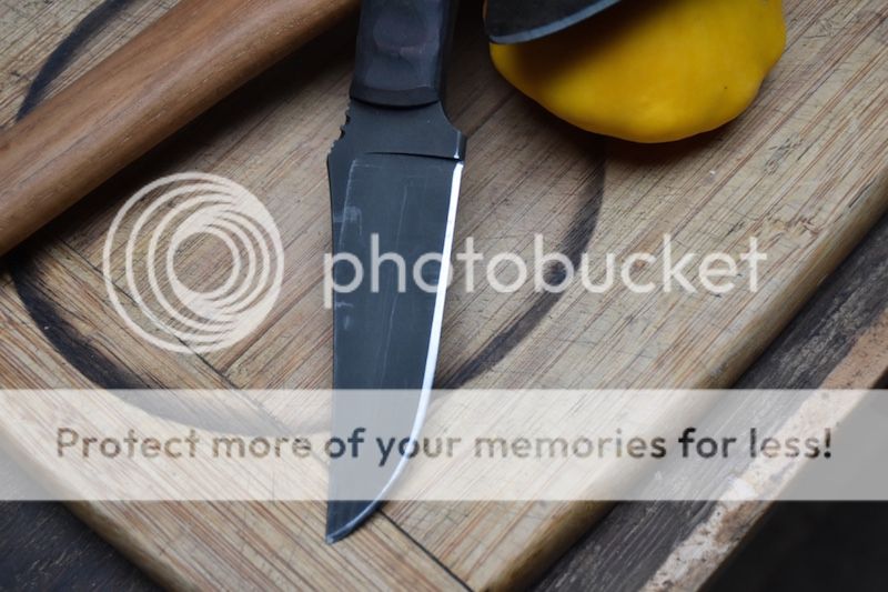

While I have no doubt what you say is correct that it takes that long to turn blue, I have my doubts about there not being any damage whatsoever prior to that point. The reason being is because there are many factors involved, such as is the steel stainless or carbon? Stainless will take longer to oxidize/change color, even though the damage may already be there. You also have to consider, by the time it gets too hot to touch w/ your fingers the apex of the edge is MUCH hotter because it is so much thinner. Even if it's just the last few microns.
For example (image wise) This part of a knife will get hotter so much faster than even 1/16" above the bevel.
I'm not saying the temper gets damaged on all steels when you grind dry, there are just a lot of factors to take into account, more than I can even comprehend (over my head) at this point hehe.
OP, I would just recommend to keep your knife moving, use sharp belts (trash em when they start not cutting well), and dip in room temp water (cold water could cause micro fracturing as you quench a hot edge).
As far a heat goes its all about pressure and technique. Which takes time to develop. Pressure using a belt grinder is your enemy. You have to find that fine line in your technique to get the best results. I've been sharpening for many years and I still find errors and little things in my technique that improve results. I sharpen hundreds of knives a year so I have that advantage.
I completely agree friend I was just debunking the thought that as soon as a belt grinder is switched on the temper will simultaneously be ruined on all the knives in the drawer☺. And yes the edge will heat much quicker than say the spine. My belief though is. The edge is also attached to the rest of the blade and the rest of the blade is a big heat sink which will pull the heat away from the edge. I wasn't telling him to hold a knife still on the belt just showing the heat isn't bad as long as you watch it and use proper technique. Also I do wish I had a wet grinder I think that would be awesome but my favorite belts(trizact) can't be used wet so no go. And I find they run cooler than other belts anyway. About damaging the edge even without changing edge color knives sharpened on the grinder last just as long as those done by waterstone for me. I'll agree though that a wet belt grinder would definitely be safer
