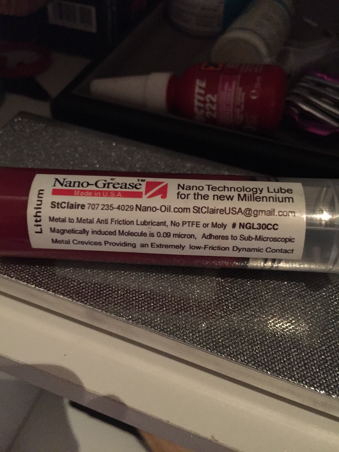

I use the nanogrease. Same company that makes the oils also makes a red grease comparable with the original CR grease. So no drying out.
Same advice goes for this stuff, use very sparingly.
