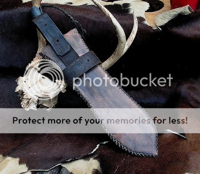

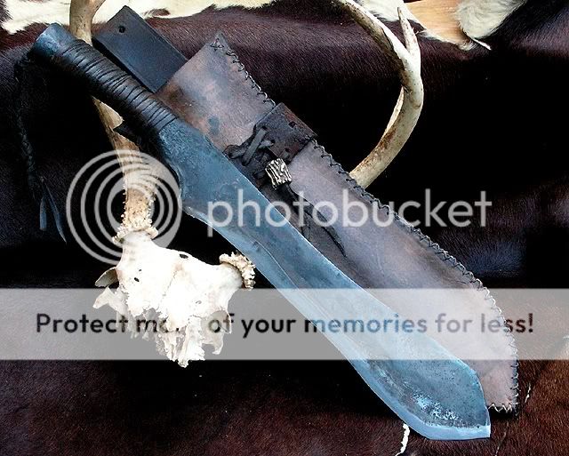

This is my interpretation of what could be done with minimum tools and materials readily available after the Apocalypse, I call this one Judgement Day
Steel from Diamond Rio truck leaf spring, forged in a homemade charcoal forge
Hot cut and filed. No electricity used. Quenched in brine water and tempered on the forge.
Socket handled with shellacked leather thong wrapping and a little braided lanyard.
17″ overall w/ 11″ sharpened
Sheath is from a leather clothes bag, Hardened with hot water and sunshine, stitched with linen and the Mexican style belt hanger is from an old horse harness w/ an antler button. All finished with shellac.
I batoned this one threw a stick of firewood just for old times sake ..Randy
