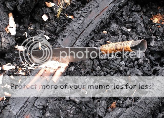

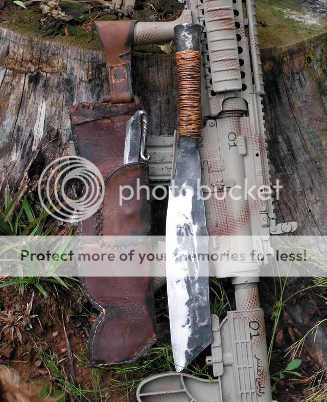

I watched ” The Book of Ely”, “2012″ and “The Day after Tomorrow” and they scared the crap out of me ’cause they all could happen, ANY DAY! So a couple of weeks ago I was out at the Redbud Forge wondering around, glad the winter was over when I thought of the ” Apocalypse”. I grabbed a chunk of old bush-hog blade, lit the fire and started hammering. This is what I came up with, no planning, not really thinking that much about it, I just made the most of what I had at the time.

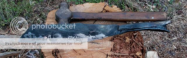

This is what I ended up with that day, Socket handle so it could be used as a spear if need be, plus there is nothing to break. 17″ overall with 10″ sharpened x 2 1/4″ wide. 1/4″ thick at the spline would take some abuse if you had to beat on it. I quenched the cutting edge in salt water and drew the back and handle softer so it will bend instead of break.

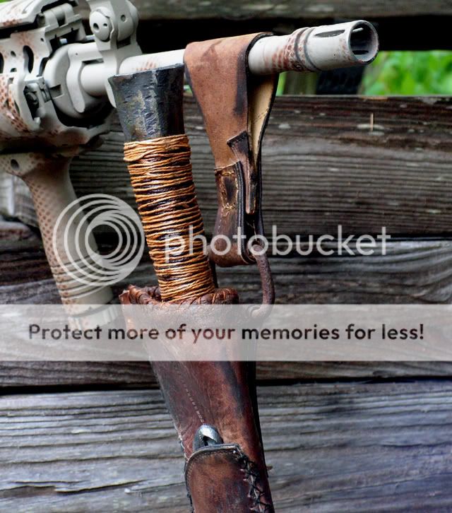

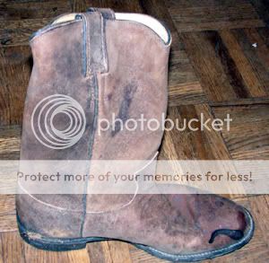

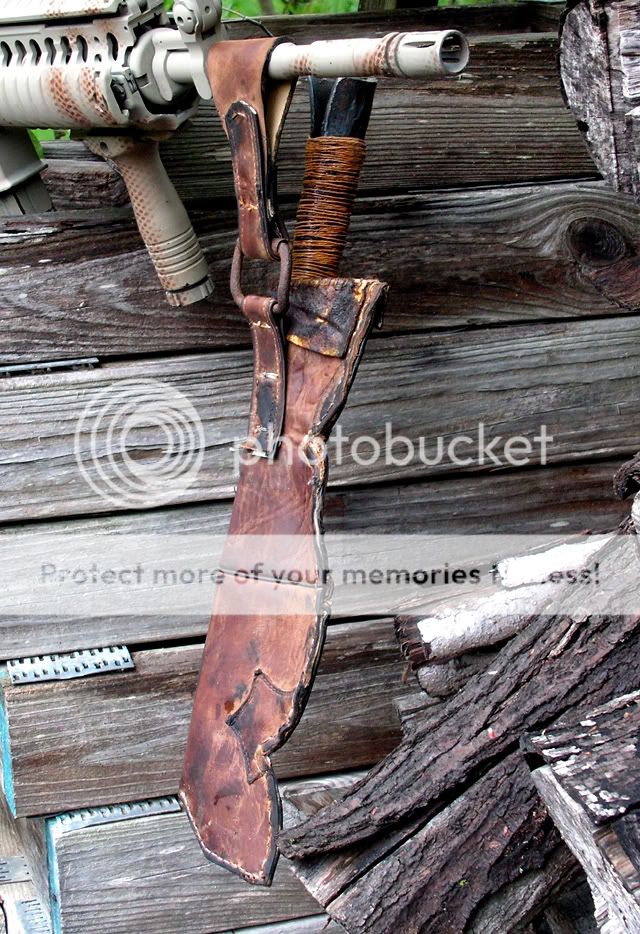

To carry on with the Apocalypse theme I decided to make the sheath out of what was in my junk leather pile, a pair of yard sale ladies Justin boots.

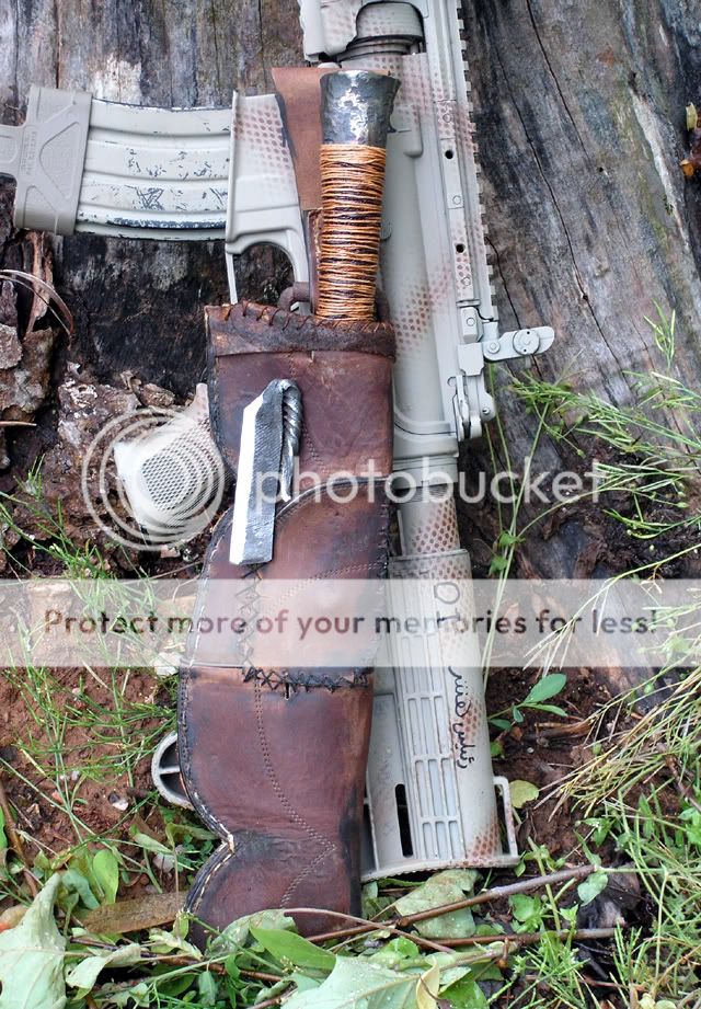

So here is it and it’s little buddy in their new pants.
The handle is wrapped in hemp cord and dipped in varnish. The little buddy knife is chisel edged from a file.
Everything except the rawhide throat, some harness stitching cord and an old roller buckle came from the boots
A little workout in the charcoal pile. It weighs over two pounds, chops nicely and it will still work when the bullets run out. Apocalypse is looking brighter……..Randy

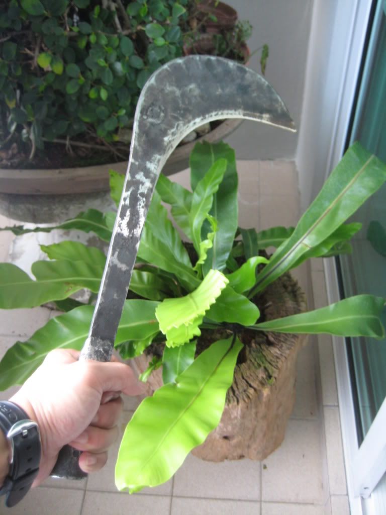

Here's my coconut cleaver forged from spring steel:

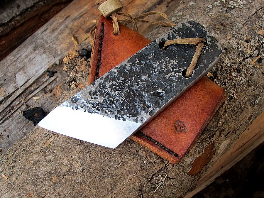

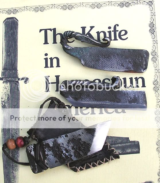

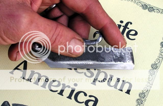

Here's the little knife. It was a evolution one. I was thinking of adding a firesteel on a thong and I kept reaching for my pocket Kiridashi to make cuts on the leather so I stuck the firesteel in the vice and filed a chisel grind on it. Sort of a mini Ulu. Tough filing considering it was already hardened. Now you can start a fire, have a small slicer and sharpen the large chopper with the file edge.
Firesteel on top
Little buddy in center
Pocket Kiridashi on bottom
And one in hand

I filed down a nail and used it as an awl and lashed the pouch to the sheath. Creech wrote " In the days after the rapture, desperation and ingenuity will be your savior "

Did you make that Kiridashi, and from a file? Looks a bit like the one I got from Scott Rousch...
Yes I made that one. I have been trading and giving them away for a couple of years. Probably got the idea from Scott, he is a great craftsman. I carry one in my pocket all the time. The guys at work throw worn out files on my bench instead of the trash so I make firestarters and pocket Kiradashi's out of them.
Scotts look a lot better than mine.......Randy
