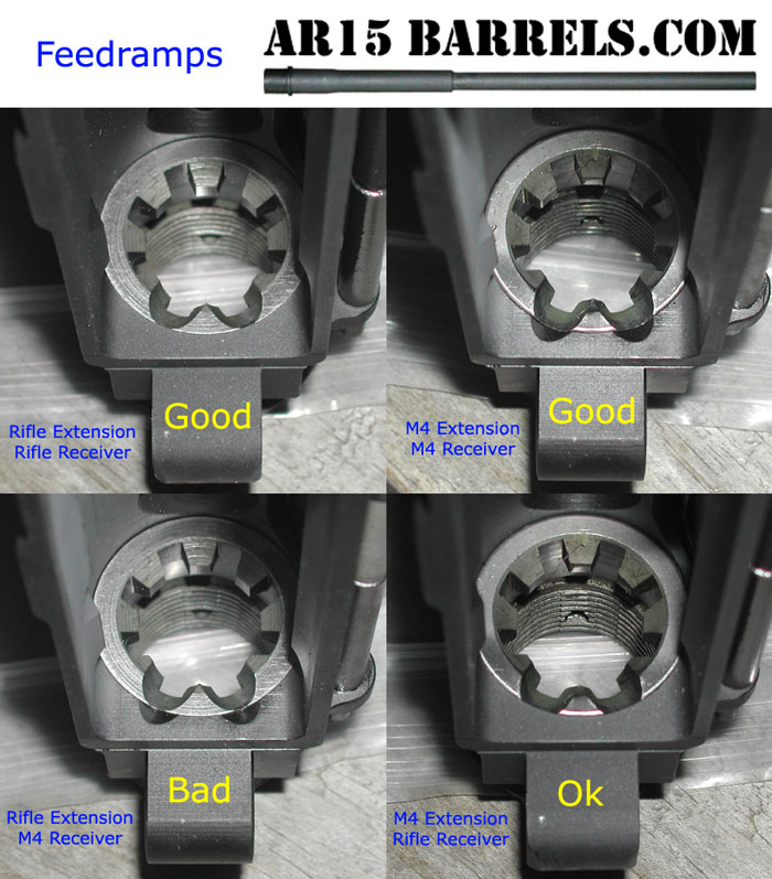

One thing to keep in mind when building/purchasing your upper parts..."m4 feed ramps" or "no m4 feed ramps". You want to buy the upper reciever and the barrel to match. If the reciever has the feed ramp cuts, then you want to buy a barrel matching feed ramp cuts.
