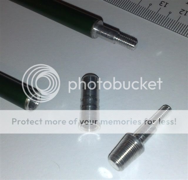

Not just a take down bow ... the takedown arrow :D

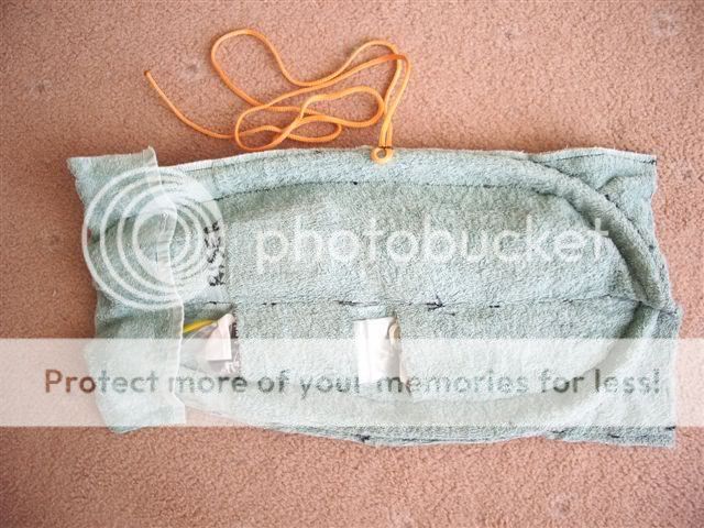

And I had to build a kit ...
All rolled up ...
Since then I made the wrap out of leather ... the towel was the template.
Very nice. What did you use to couple the two shaft pieces?
I was thinking an arrow insert for the female side but I'm not aware of a male equivilent. Any ideas?

Flix - I used an arrow head insert for the male, put it in an electric drill and filed it till it fit in the shaft then glued it in with the arrow screwed together and splinted with other shafts till dry. They said it wouldn't shoot straight ... but it does and with a 60# bow. I'm not going to win any comps but it hits the score zone. Just make sure you screw it together properly before it drys. I use a bit of thread tape to keep the joins tight including the screw in head.
Thanks! Sounds like a good approach.
I don't yet have a take-down bow. My favorite traditional is a 72" yew longbow I had a custom bowyer make years ago. So as you can deduce, I'm not yet focused on shortening my arrows. Got to work on a more compact bow first.:o But when I get that taken care of, I'll try your technique.
Much appreciated!:thumbup:

Thanks, dartanyon. If you get the chance, I'd love to see close-up of the male insert.
