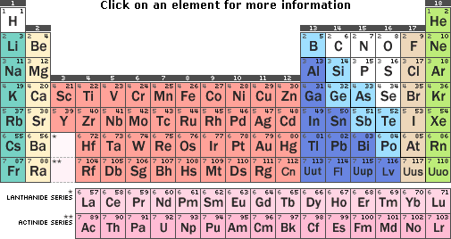

Good stuff guys. Thanks for your efforts. HardHeart, I couldn't get the chemistry table to interact. DM
