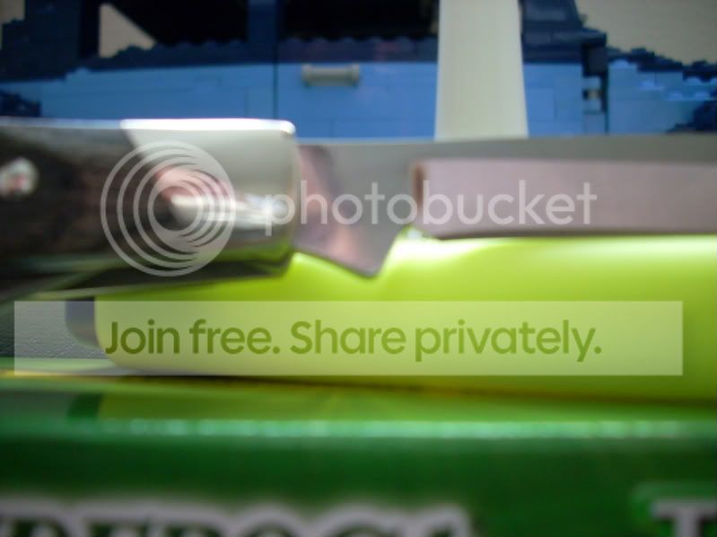

I just got a new 301 from Knifecenter, and had a few concerns...
First off, the spey blade sits proud of the liners, with the point about 2.5mm above. It can't cut me when using the other blades, but looks unusual. Is this just how Buck does theirs?

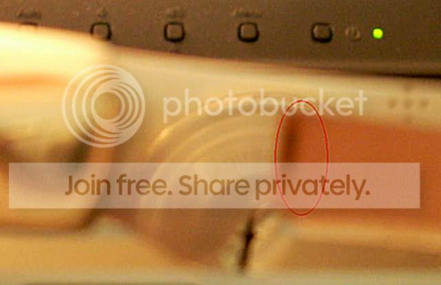

Second, have a look at this.
There's a stain on the sheepsfoot blade, about the same brownish color that I see when polishing too aggresively. It looks, in all honesty, like a small burn mark. Should I be concerned?
Love my 112 and 450, just want to make sure these aren't major problems.

:eek::eek:...Whewwww...If you can make anything out in that picture you have FAR better eyes than most humans...:cool:
Pretty much, most 301's I've bought NIB in the last few years are like that. It's never gave me any trouble.
I did the best I could. Camera isn't the best. Maybe my scanner still works.
It's like a brownish line- I can circle it if you like.
Here's best I can do at the moment. It looks like a heat mark.

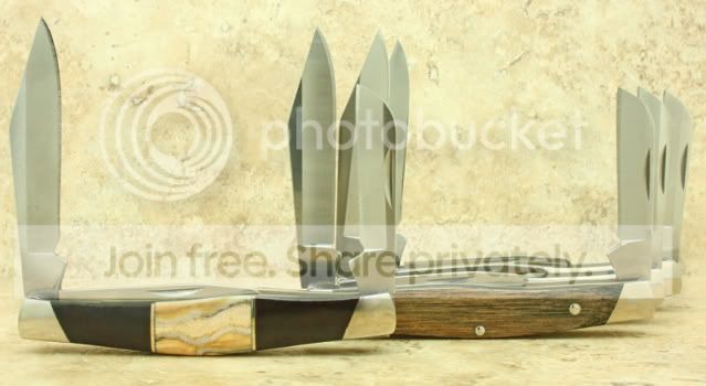

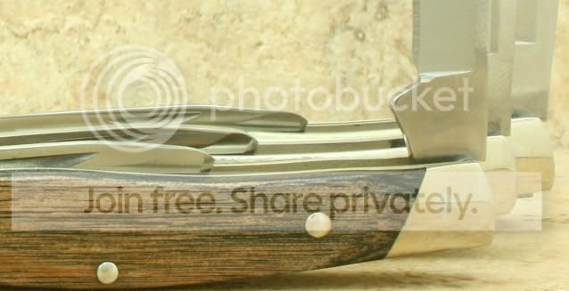

Let's have a do over. It looks like you were too close for your camera to focus and you hand held the shot. Tomorrow go outside and set the knife on something in the bright shade, unless its cloudy, about 2feet away from camera and brace camera against chair or other support and snap the pic. We can blow it up on our own screens. Then Joe Houser will be able to see it and make evaluation. I will have to dig out some knives to see about the spey issue in my house. 300Bucks
Fired up the photo lights, got out new 301 Dymondwood, LE Elk Tracks,two other 301 LE's. If fit and finish are going to be to design standards you would think LE's would do that. So, have a look and see what you think. Even though as you say it does not cause a problem I would prefer the spey tip below liner level. Notice the left LE ironwood and mast tooth is ground with scale swell to the opposite of the clip blade and it covers the spey tip. And the other have scale swell TO the clip side. The swell is most likely placed to give surface area for shield....no shield on LE's .. Interesting. 300Bucks
I never noticed that until now, but mine has it to. My bone and Malachite LE 301 however is the other way, and the Spey tip is exposed.

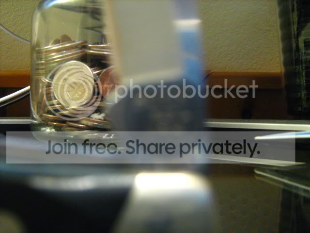

I'll do what I can. It's a mediocre little point/shoot camera, but we'll see. Just need batteries for it.
Edited to add pics. They're still fuzzy- this camera just isn't cooperating- but better.
Just for curiosity, what kind of camera are you using? Does it have something like Macro mode or somesuch?
I'm using a relatively inexpensive Cannon Powershot A460, macro mode turns this:
Into this:

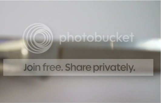

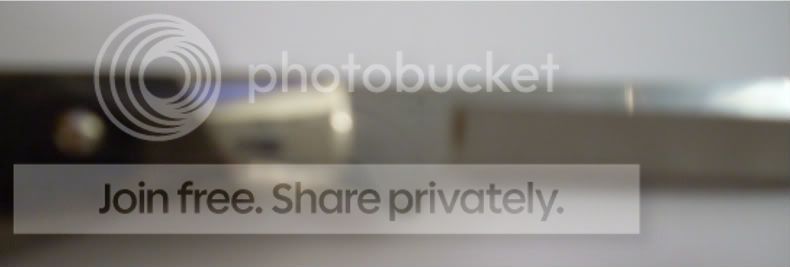

Try pencil eraser on the small spot, don't get agressive just some small light rubs to see what happens. If that helps then try metal polish like Brasso, Flitz or Mother's. Leave big one alone until you hear from Buck.
Does your camera take regular photos, such as person with birthday cake better or OK in you opinion. Some cameras have about a 3 ft minimum focus, unless using close-up macro setting. If it takes people photos OK, take one about 4 or 5 ft away (measure to be sure). We can blow image up on our computer screens. Like Psych suggests the general color looks like buffing burn.
300
Really hard to tell with the pictures if it just a surface discoloration or truly a mark from excessive heat. If it is a heat mark the knife needs to be replaced. usually we see heat marks along the edge where the blade is thinner. The shape in your photo does not look random enough, however if your blade was seriously overheated and then got cleaned up in the assembly process so that the little vertical stain was all that was left it definitely needs to be replaced.
This is much better. Ignore the random school supplies- only way I could get the knife to stand straight and not let the mark fall in shadow.
