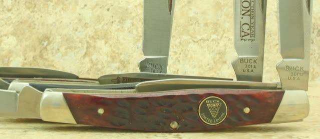

Short answer:I just got a new 301 from Knifecenter, and had a few concerns...
First off, the spey blade sits proud of the liners, with the point about 2.5mm above. It can't cut me when using the other blades, but looks unusual. Is this just how Buck does theirs?
It is indeed how Buck does theirs.
Long Answer:
This interested me when I first noticed it on mine and compared it to my old Camillus-made 303 that I bought ~1980. It comes from the orientation of the scales. The scales curve on a stockman. There is a high end and a low end. On the Camillus-made 301's and 303's, the high end of the scale is oriented such that it covers the spey blade. On the Buck-made 301, the high end of the scale is at the other end and the tip of the spey is exposed.
Longer answer, (or as we like to say in the Lean Biz: "Root Cause")
The Camillus 301's are a 2-spring design and the Buck 301s are a 3 spring design. (This is advantageous because, with a 3-spring design, you don't have to bend the blades, so you don't have to anneal the base of the blades to bend them. This removes several manufacturing steps and makes the Buck design less expensive to manufacture.:thumbup
This probably won't make much sense unless you have both knives to look at. 300Bucks should be able to see it, though. He's got'em all.
But, at the end of the day, it just looks a bit odd. It works just fine. I've carried my 301 quite a fair bit and haven't caught myself on that exposed tip yet.
