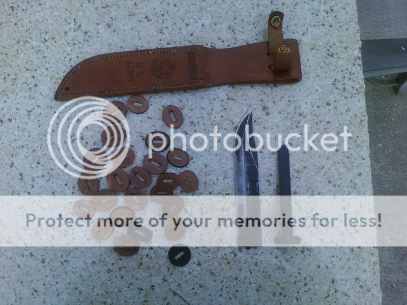

I do like hidden tang knives when done right. I just had my trusty Kabar fail on me while processing some fire wood. I was batoning through some hard seasoned wood and the blade just snapped. I think if the tang were a bit wider and maybe a nice radius at the 90 degree angles it might have survived. I think the next gen Kabar might have a bit thicker stock than the originals. I finished the firewood job up with my NMSFNO, no problems there :D
I hate seeing good blades break
I'd like to see a on piece version of the trusty Kabar design.
WOW I have never seen a Ka-Bar break and I have seen some dues do crazy stuff with them.
I started to take a bend a little while into it, although I'd like to add that I used this knife maybe half a dozen other times to do the same task maybe not as hard of wood. I love this design for an all around knife, I would really like to see one made from a solid billet of steel and with a full tang.
