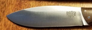

Pretty sure this is a convex blade. And I am here to tell you it is SHARP.
And then today, I decided to put a simple leather lanyard on it and the fargin bastage bit me right on the pad of my thumb. Took only the slightest bit of an error. I hate that POS non fitting non retaining sheath that BRK provides. A proper sheath is on the way made by Harry Savage. Had the knife been in that sheath, my thumb would not be wearing a bandaid.
