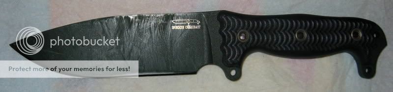

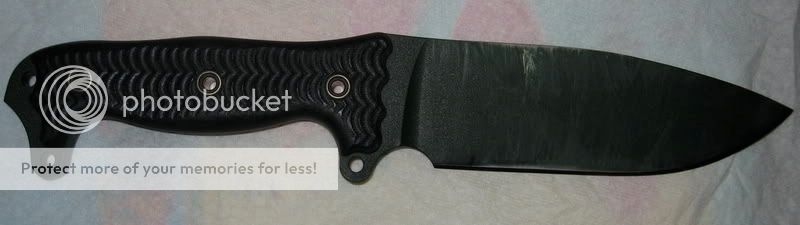

I just love DCBB and SATIN knives. Plain and simple. Nothing wrong with coatings. And if INFI didn't have such good corrosion resistance I'd leave the coating on. However, it's time to get nekkid.

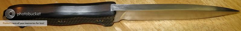

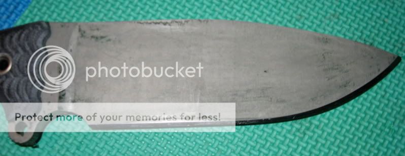

(1) Here are some shots of my ASH-1 with some coating wear. But nothing major.

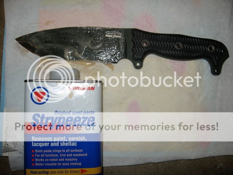

(2) Next, here is the blade coated with the stripper I used. Not the best but it worked well enough. I still had to do some scraping to get all the coating off.

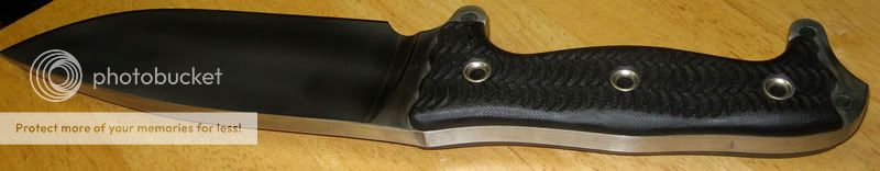

(3) Here are some shots of the coating gone. NO DIMPLES! :D God this thing is smooth.

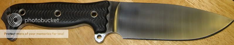

(4) Finally here are some shots after the scotch-brite treatment I always use.
Still a little more work to do here and there. This would have been much easier if I had taken the handles off. But I am very pleased with the out come. I'll probably do a little more work but not much because I'm going to beat on it later tonight any way. This be a USER!

FYI: G-10 owners be careful. I noticed that the G-10 became soft where the stripper touched it. Just a very thin layer. I could scratch it off with my finger nail. It is possible that it was just dirt from so much use this week and not the G-10 at all. Has anyone else run into this with G-10?
Anyway, I just went over the G-10 with the scotch-brite quickly then oiled it up and it looked perfectly new.
I have never had this issue with micarta.
Like I said, it is very possible that it was just dirt and not G-10 but I wanted to caution you guys just in case. ;)

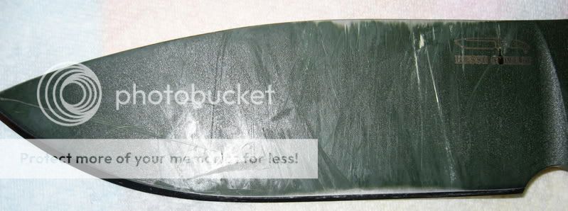

Is the logo gone after you buffed it out with the scotch-brite??? :confused:

Nope. It's still there. :D Harder to see on the satin as compared to the OD. I was careful not to do too much buffing on it though. ;) I'll try to post some pics later when I get home.
