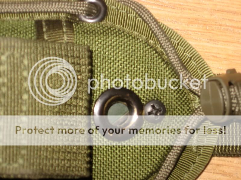

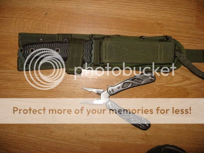

Inspired by foxyrick's thread I decided to see if I could get my ASH into a Spec-Ops as well. I just received an awesome kydex sheath from a fellow HOG for my BATACSE so the Spec-Ops was empty. It is the smaller/short Combat Master sheath.
First, I had to take the liner out, soak it in boiling water, and slowly work my ASH in until it was a perfect fit. Not too tight either. This took about 10 min. to get it just right.
Then I drilled a hole beneath the original eyelet on the sheath as the ASH blade tip reaches that far. I used a screw/tube & ruber washer from a tech-lock. I actually inserted the rubber washer into the liner, inline with the new hole, and slid it into the sheath. That way if my blade gets too close in will bump the washer and not the screw/tube.
Once the liner was in line with the new hole I just inserted the tube on one side and the screw on the other and tightened everything up.
The blade comes in and out smoothly. Works great. You can see where the blade tip is in the original eyelet. I plan on covering that part up with perhaps a couple pieces of kydex or something. I'll use PVC glue or something. But it's no biggy right now.
Thanks foxyrick, and others in that thread, for the great idea. :):thumbup:

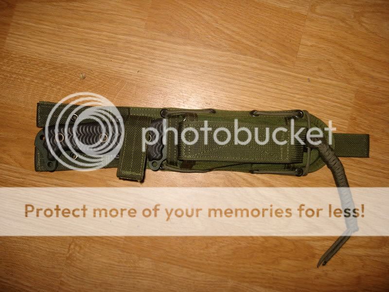

That's great work Tyrkon. The colours work together too, that ASH looks the business in its new pants. That's so important, especially to my wife. It's amazing what I can get away with if she likes the colours!
So, the ASH fits in the small sheath, I was wondering about that. I need to get one then, for when mine come!
I'm tending to think that the Survival Sheath is a little bit overkill with the clasp and zip on the pocket. I don't think it holds much, if any, more than the Combat Master pocket but is much bulkier in itself.
Covering the original bolt hole is a good idea. Great minds think alike indeed! Knowing me, the first time I take this out I'll end up falling in mud or something and getting the hole full of it.

Great job, Tyrkon! :thumbup: I'm in the "don't plug the hole" camp since realizing that draining = good. Now I wonder if that spare long sheath I have can be suitably modified.....:D

Personally, I would leave the open grommet as-is to serve as a drain point.
Hmmm, seems a lot of support for an open hole.
Are folks thinking of draining just water, like if it's raining or you take a dunk?
In that case, I would have thought it would drain reasonably well anyway given that the nylon outer isn't waterproof. Plus the water's got to get in there first, and there's not a lot of room left inside with the knife in. In its standard state, the fixing bolt would be effectively blocking the hole.
The only way I see the drain hole being useful is if mud/debris gets inside. In that case it could be flushed out through that hole. But it could just as easily get in through that hole I would think. So I would prefer to have a removable hole plug.

Good job TL. I would cover thathole in the plastic before the eyelet scratches your blade. I thought the blade was too wide to fit. Maybe I will buy a large specops for mine
Nice solution to your sheathing issues!
I don't think the eyelet can touch the blade. The plastic liner comes between them - you just can't see it in the picture.
You are right I mis spoke or miswrote or misposted. In any case I had not thought it out correctly. Thanks.
I would still buy the large one
If you guys get a large one then you shouldn't have the eyelet issue and will probably just have to mod the liner to fit. The liner is thin enough that boiling water worked perfectly. Just do it a little at a time as you ease the thick ASH blade into the liner. And BE CAREFUL! I kept thinking, as I was pushing the ASH into the liner, that it would cut through the sheath. But it worked perfectly. No plastic smell either. :D
