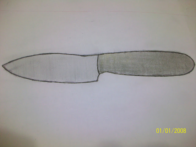

A few weeks ago, I posted a photo of a knife that I drew up and said that I was going to make it. The thought was to start saving up money and begin on it part way through the summer. At the time it was more of a dream or a thought than a reality. Then Stacy saw my thread and made an incredible offer that I could not possibly pass up. Let me just say this now: To all of you new guys and gals, fill out your profile because you never know what it may lead to.
The original drawing

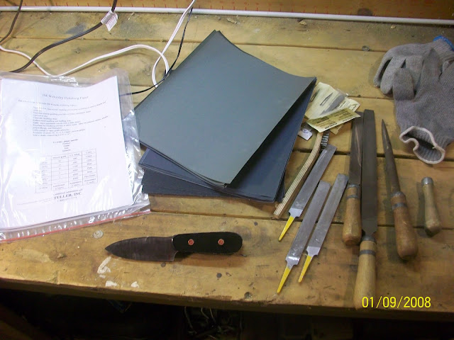

Here is the kit that Stacy sent me.

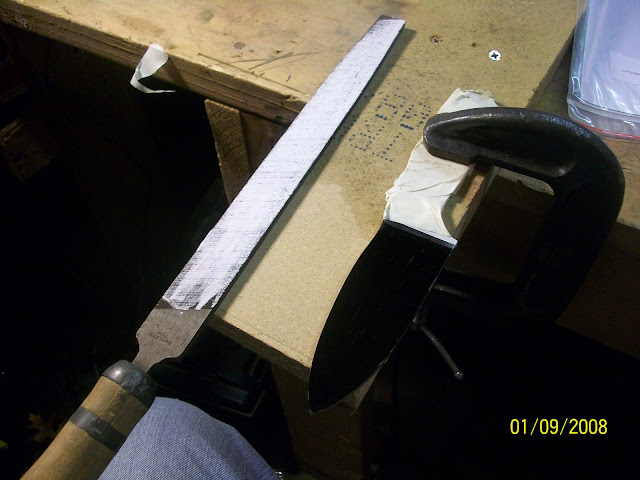

The file is chalked up, the handle taped to avoid dings from the clamp, and the blade covered so I can tell what the hell I am doing.
After a little bit of filing, I decided to call it a night
Feel free to send any questions comments and vulgar statements my way. I am sure that I am not doing something right, so if you notice please let me know

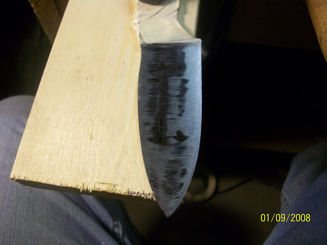

The only problems I could see was what I couldn't see, but I was able to fix that:p
Follow Stacy's instructions and you will do fine, be sure to get all of the scratches out from the previous grit, don't focus on one area work the whole blade. As in if you see a scratch at the tip don't just sand there, sand the whole thing from plunge line to tip evenly, or you will get low spots. Other than that, just enjoy yourself and don't rush it:thumbup:
Way to go. Take you time and have fun. This might be the beginning of a life long pastime.
OK, guys, follow him along and post your comments and suggestions. Often an experienced maker will make assumptions that a new maker will not, so many of you with "lesser" experience may be of more use to CB than my advise at times.
Looks good so far.
If you are working just one side right now, try and work the other side too. You will want to do a bit on each side instead of one entire side at a time, more likely it will end up even at the end. I did this on my first two and it worked out great, just required a lot of flipping the blade in my clamps, well worth the inconvenience though.
To go a step further I even made a filing jig to give consistent angles... it isn't pretty but you can get an idea for it in my WIP thread for my first two knives which are off at heat-treating right now http://www.bladeforums.com/forums/showthread.php/841837-New-to-knife-making
Other than that... I must say that's a pretty cool profile you came up with. Awesome that Stacy could get you going on this! I'm very new to this as well but it's already a lot of fun and I have the next 3.5 months of summer budgeted out time/money wise for knife-making already :D
Looking good so far, no file gouges or anything... nice! Filing is tough at first but after getting used to everything it goes somewhat quickly, very satisfying. Looks like you're getting it right to me. :D
Stay at it and it will be done before you know it. :)

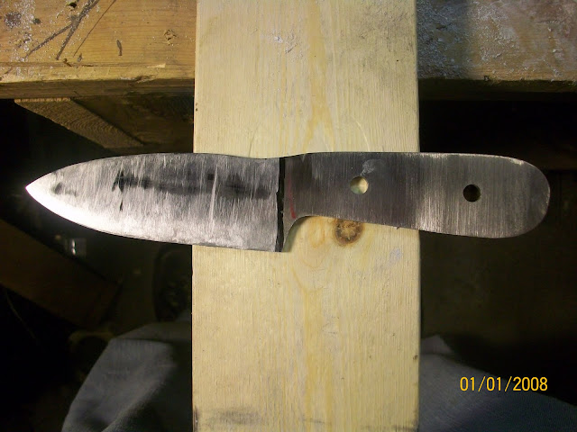

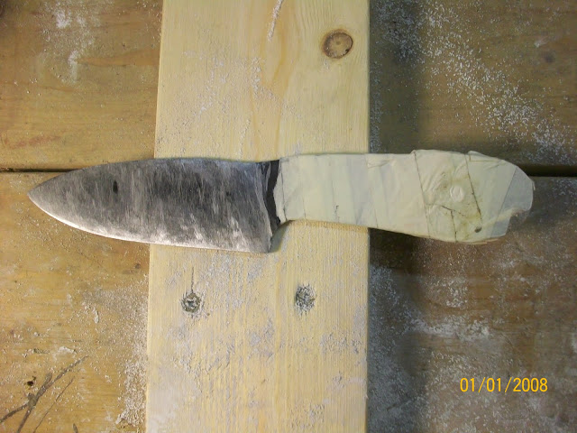

I spent a couple of hours filing tonight.
A little more
Time to change sides
Some more filing
Don't look, I'm naked! and kinda ugly
Problem!!!
I am not entirely sure how I did this, but I think that it is from accidentally tilting the file and running a corner down the blade..... there are a few more, but this one is the worst. They are not too deep, so hopefully with the filing I have left, I can even them out a little, then more with the sand paper.
wolffbite, for my next projects, I will more than likely build a jig similar to yours. For my first knife, I decided to make it complete with maximum human error, and it definitely shows. Hopefully the sand paper will even it out.
I measured the bevel with a nickel. At the ricasso, it is over a nickel thick, and sliding it forward toward the tip, it slowly narrows to just a hair under a nickel. Would it be wise to focus more file strokes at the ricasso and descend toward the tip to help even it out? I am also not satisfied with the plunge line, but there should be enough metal left to fix it, right? It may not be apparent in the pictures, but for some reason the sharpie is still there in the middle of the blade, but it has been been filed away near the spine and edge. When I file, I hold both ends of the file. Maybe I am pushing too hard, causing the file to bow?
Thanks for any thoughts criticisms.
The gouges should be lessened with more filing for sure. A nickels width is a good reference to get for pre-sanding, and then just thicker than a dime for the handsanding before HT. Once you have done all the perpendicular filing, you can move on to some draw filing (parallel) on the blade, which will even out the whole bevel and hopefully remove the remainder of those gouges. I wouldn't worry too much about them right now, you still have quite a bit of filing left to do from what I can see. But it looks great!
Don't know if this has been brought up or shown to you but this site is pretty much the grail of making knives by hand http://www.engnath.com/manframe.htm. Lots of techniques, tips and tricks there that should keep you reading for hours and hours (i've read it all about twice now... and keep reading to absorb all the good bits :D)

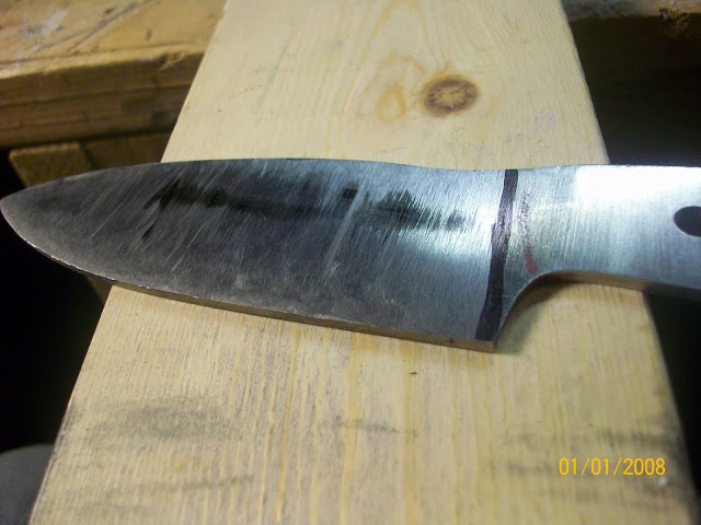

I did some more filing again tonight.
I got most of the gouges out, but I still have this one, and one much smaller on the other side
Also, I am yet to make a dedicated plunge line, but this is what I am thinking:
Maybe not quite that steep, but I think it looks better that way than any other direction.
Thoughts?
I know my file lines are pretty messy, but I have a lot of filing still left and all the sanding, so I think I have plenty of time to straighten up.
Please let me know if you notice anything that I have over looked or failed to mention.
Thanks
Cooper,
One purpose for the plunge line is to make the rear blade edge corner not sharp. Your finger rests right there , and a sharp pointed place is sure to bite you if you are not very careful. If you make the plunge angle above this area, the entire edge will be sharp, and there will be no reason for a plunge at all. There is nothing wrong with such an edge, as many kitchen and other slicer knives are made with a full flat grind and no plunge. I personally don't think the angled plunge will look good. If you want a full sharp edge, just start filing in the bevels and forget about the plunge. This can be done with the angle you drew as the starting place and will look good ( just with no defined lip or plunge).
It looks like you have filed in the distal taper pretty good, and now are ready to file the bevels to taper the blade toward the edge. Since this is CPM-154 steel, and will be HTed in a proper setup, you can take the edge to at least .030 before sanding, and down to .015-.020 after sanding. If it is even thinner at the edge, it will be OK for this steel type, as it warps very little in HT. Just don't sand it until it is sharp :) .
Keep up the good work.
Thanks for the clarification, Stacy. I didn't realize that if I did it right, there could be no defined plunge line. I think that will work better for this knife, especially considering how wide the blade is. Knowing that the blade can be thinner pre-heat treat for stainless is a relief. I must have overlooked that piece of information somewhere.

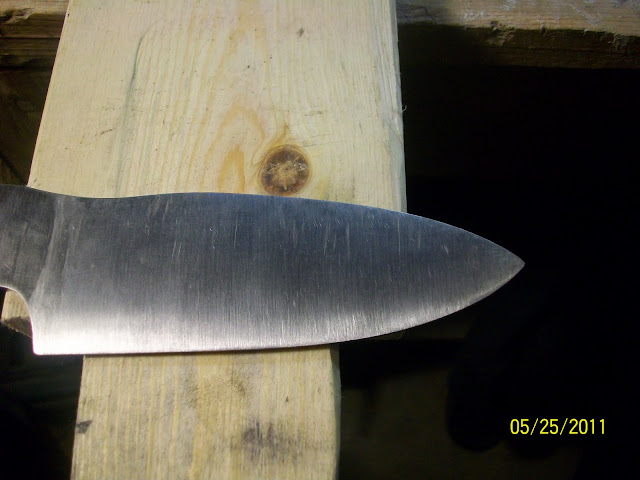

I did some more sanding today, but before I go any further, I have some questions. I started sanding with 180 grit, perpendicular to the blade and it looked just fine. Then I decided to switch direction and that revealed this:
I didn't realize how badly I had gouged the blade! The other side is not nearly as bad, but I am pretty concerned about this side. Maybe the metal shavings getting in the gouges made it seem worse, but I am still very concerned.
So, my first question is should I find some sand paper that is lower grit and try to take more metal off?
I don't want to do any more filing, because I think that I may make it worse, but it seems that the 180 grit isn't doing much good.
Second question: When I took the tape off the tang, the was what looked to be some pitting. At first, I try to sand it away, but it didn't go anywhere. Should I be concerned, or is this normal?
Thanks for any advice.
Use the 180 grit and switch the paper to a new area when it slows down.
Don't be too worried about the file marks, or the tang. The file marks will sand out and the tang is not an issue at all.
Ok. Stacy, maybe I am just a little too worried about it. I have been cutting the paper into strips and haven't quite used up a full sheet, so I guess there is plenty of time. The depth of the gouges just has me concerned.
