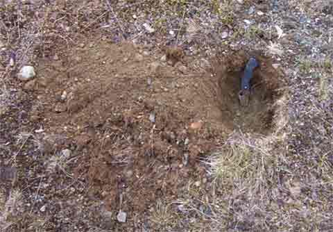

Yes, as you keep sharpening at 15 degrees the bevel starts becoming less and less micro and thus sharpening time increases. Once this becomes significant you just recuct at 13 with the x-coarse hone which again is very fast irregardless of the steel type.
For example :
http://i7.photobucket.com/albums/y269/CliffStamp/Spyderco/paramilitary/hole_paramilitary.jpg
After the above work, plus some harder metal chopping which left the edge actually visibly damaged, the primary edge was reset with an x-coarse waterstone in just a couple of minutes. Now a secondary edge bevel was applied near instantly, thus total sharpening time was minimal and this is obviously a very extreme case of blunting.
