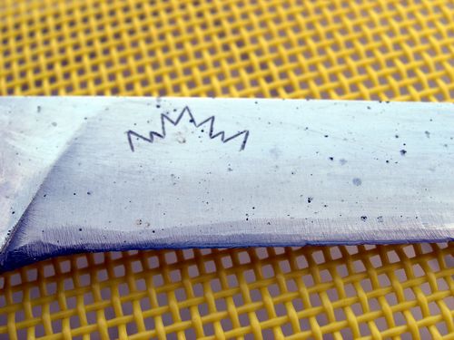

One has to explain why I should use a steel like D2 if it is neither fully corrosion resistant, nor it gets really sharp, it isn’t easy to heat treat or sharpen by easy means you cant make thin and blades and after a polish you see the ugly monster carbide structure with bare eyes.

I've never had D2 rust in any way, and I work outside in high temp and humidity every day. I have had 420HC rust in that, but never D2. No special care, just wiping the blade on my pants when I'm done.
http://www.messerforum.net/attachment.php?attachmentid=12438
I have had ATS 34 to rust.... mom used it the the way she does to all knives
Her the reason beside the sloppy care, the heattreatment is the cause.
Never make tempering around 550°C where the secondary hardening maimum is, when you want to have corrosion resistance...
D2 at the same place would have looked even worse, because most of the chromium is stuck in the carbides.
Pick yourself a medium/average grade steel(by todays standards mind you)440c or AUS 8a and get into the Zen of freehand sharpening. ;) Works for me.

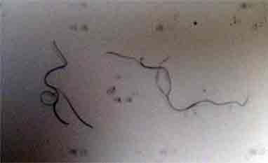

Here is shot of a few strands of hair whittled with a S30V blade :
http://i7.photobucket.com/albums/y269/CliffStamp/misc/hair_whittling.jpg
-Cliff
