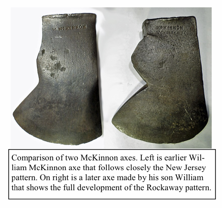

nope, that top one is a Jersey pattern. Its confusing and a lot of people think that the rounded lugs mean its a rockaway - but it has nothing to do with the lugs. A rockaway has a shorter poll and more of a rounded sweep to the beard, where the Jersey has a taller poll and more of a straight beard from eye to heel.
The plumb jerseys had rounded lugs so a lot of people think they are rockaways. I have seen a very few actual plumb rockaways though. The rockaway pattern is a pretty old pattern though. I don't think anyone has really produced one in almost 100 years. The maker most known for the rockaway pattern was McKinnon, and I'm super lucky to have one. I've also seen plumb and true temper / Kelly rockaway heads, and one other maker that I forget now.

It's worth noting that Rockaways are one of the most frequently misidentified patterns, not only because of the round lug issue mentioned above, but because Plumb also made a Rockaway pattern, but the Plumb Rockaway looks a bit different than virtually all other Rockaway patterns made by other companies to the point of practically being its own sub-pattern, and the original McKinnon Rockaway varied in form WILDLY to the point where it's almost comical.

The rockaway is in the middle - shorter poll and rounded beard. My Rockaway has pointed lugs which all McKinnons do. There was at least one other maker who's rockaways also had pointed lugs - maybe warren??? I forget.

Here's a sampling of McKinnons (again, not my images) to show just how wildly they varied. You'll note that some have very pointy lugs, others are pretty rounded, some have very curved jawlines, others almost straight...there's seemingly little rhyme nor reason to it.
