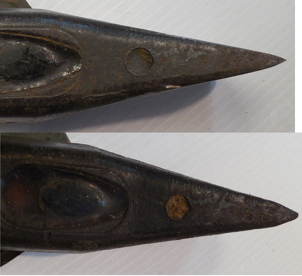

Prompted by a discussion on this site I elected to re-profile my big box store splitting maul. I found that it did split easier than before.
Beautiful job of that! Angle at the tip was too steep before. I am trying to imagine how long it would have taken to reprofile like you did had you only been able to use an axe file. Took me forever to do exactly what you did but on a steel splitting wedge with a similarly steep-angled tip using a portable grinder. When they're too steep they don't want to 'stick' and often they 'bounce out'.
