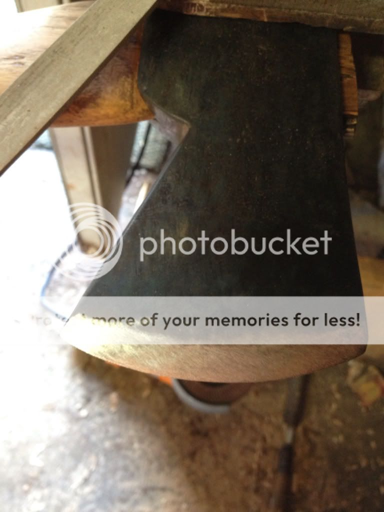

Here is a no name axe I saved from my FILs barn.
First things first. The head was already loose. Time to cut her off the handle.
Don't worry, the handle had a wicked bow and a twist in it anyway.
Next, drill the top
And the bottom
Ya, I know what you are thinking. It is time to change that bandsaw blade.
Then knock it out, piece of cake.
Now, I marked out with a sharpie what I wanted to cut off. I used an angle grinder with cut off wheels, grinding wheels, etc. I dunked it in water often as wrapped a wet rag on the bit too. Remember, power tools are dangerous. Wear proper safety gear boy and girls. Which reminds me, where is my face shield??
After a while, this is what I'm left with.
To 'hide' the fact that I cut and ground so much off this head, I gun blued it.
I started working on the bit while it was off the handle. (And before I blued it)
At this point, I ran out to the local farm store and picked up a boys axe handle. This will be the first boys axe for me. I have to admit I was surprised at the brand in the sticker. Is this the same one you guys always refer too??
I spent quite a bit of time sanding the THICK laqucer off this handle. I plan on staining it a but darker later.

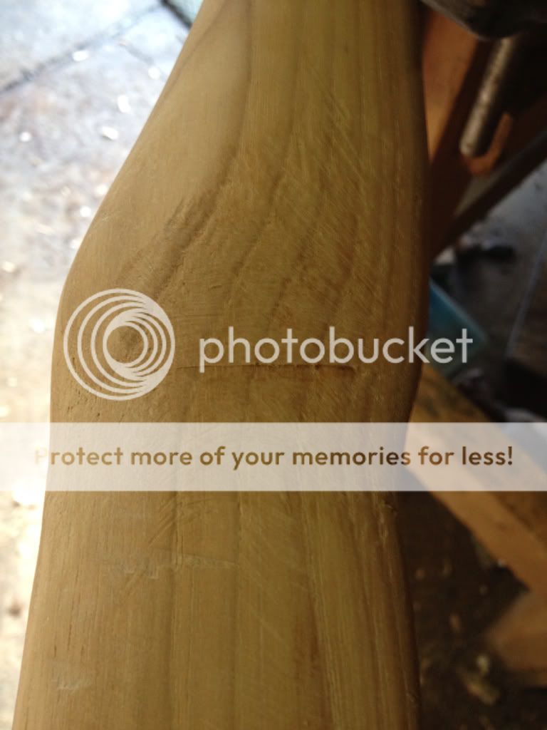

Two questions for you please:
1- should I set the head a little closer to the shoulder or is this ok??
2- is this enough room for the wedge or should I thin things a little more?
I appreciate any comments. You guys have some incredible experience. Hopefully I can finish things up this weekend some time.
Excellent work! Just my opinion, but I would set the head down farther. I know it's a lot of work fitting the lugs of the head over the shoulder of the handle, but I think it looks better and makes the fit more solid. As for the wedge- if the head comes off fairly easy, I think you're good. Drive it, and if you don't like it, pull it and reshape.
Looks nice! I would also take the time to lower the head down further. And ditto for jpeelers's tightness comment. It looks ok, but if it's really tight, it won't hurt to thin it out a little.

great job. Bring her down more on the handle. I would widen that slot a bit . But it depends on how thick the wedge is. Doesn't look like your gonna get that much of a spread to begin with from how narrow that eye is. I find house handle to have narrow slots and thick wedges. I widen and thin for a proper fit. How's the balance feel? Really does look great. :thumbup:
Nice mod!
Yes, bring is down further onto the handle. And then shave those lumps off the handle so you have a smooth transition from the eye into the haft with just a slight bulge beneath the axe head to hold it up.

I put it back in the clamp and started shaving things down a bit. I really need to get a draw knife. But my scandi helped for now.
Sanded down
And here we go. Its about 5/8" further down from the previous fit. Am I on the right track?
You're gonna hate to hear this, but I'd go a good bit more. The front and back of the handle, not the sides, are what should limit downward motion. This is why I hate hanging heads that have prominent lugs. My opinion though, it's your axe!

Lol! No prob. I actually agreed. What you guys were saying about the ears finally clicked. Every time I set the head back on, the ears would dig in a little.
So I stuck her back in the clamp and spend time flattening out the bulge to make the ears fit better. It just took time. No worries.
At this point the head sat down another 1/2 from the previous fit leaving over an inch sticking up top. I cut the kerf, obviously. (Forgot to take pics)
I was pretty happy with it, so I stained the handle after another sanding, mounted the head and cut off the excess on top, leaving about 1/4".
