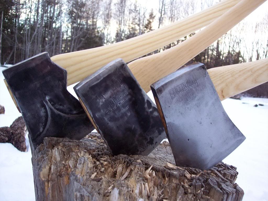

(left to right) True Temper Kelly Perfect Jersey, Kelly Flint Edge CT, Collins Legitimus CT:

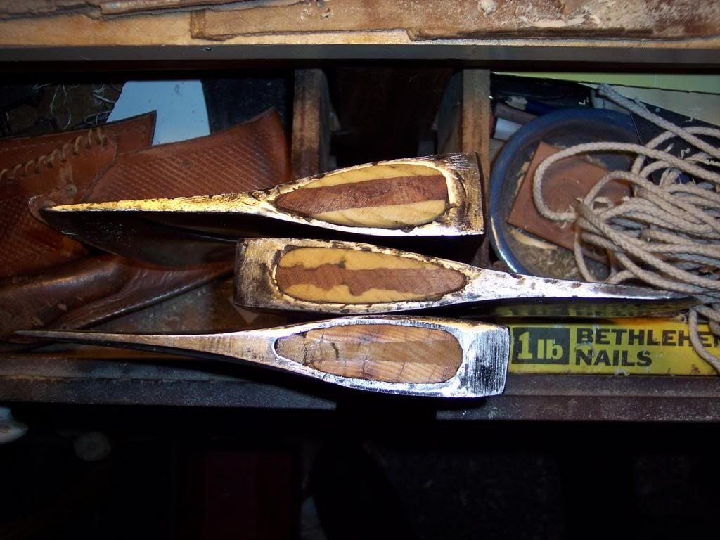

same order (back to front):
More beautiful work, coop. I'm about to finish up a loooooong, tedious, non-axe related project and am jonesin' to get back on the vise. Though neither my work nor my photos are as good as yours. Cheers to you!
Wow! Three great axes. You been busy.
I never find Connecticuts out west here.
Thanks Pegs and Vintage. The only one picked up locally was the Flint Edge. I have a lot of axe heads I bought last year. Still have a nice Red Warrior to hang. The draw knife and spoke shave have sped things up too.

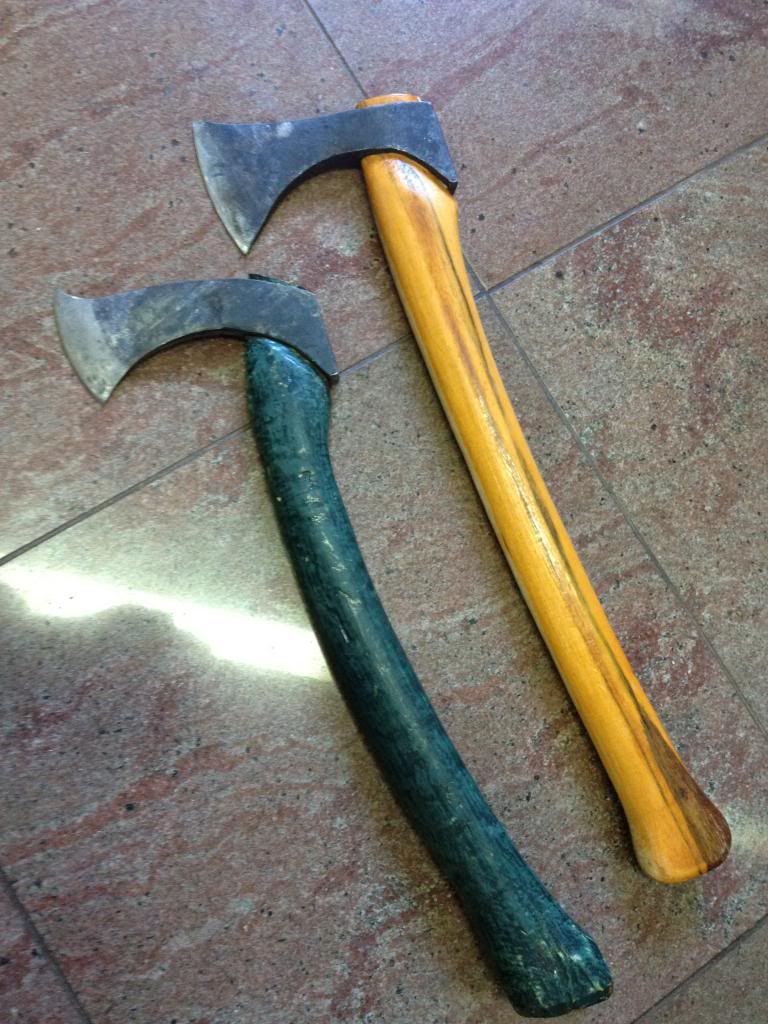

Cleaned up a few of my ladies in waiting. Both cleaned with a wire wheel and sharpened with bastard files

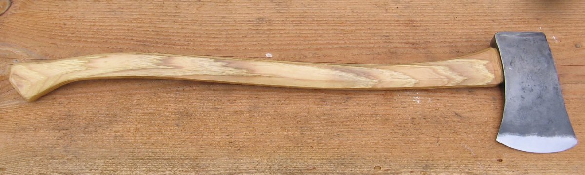

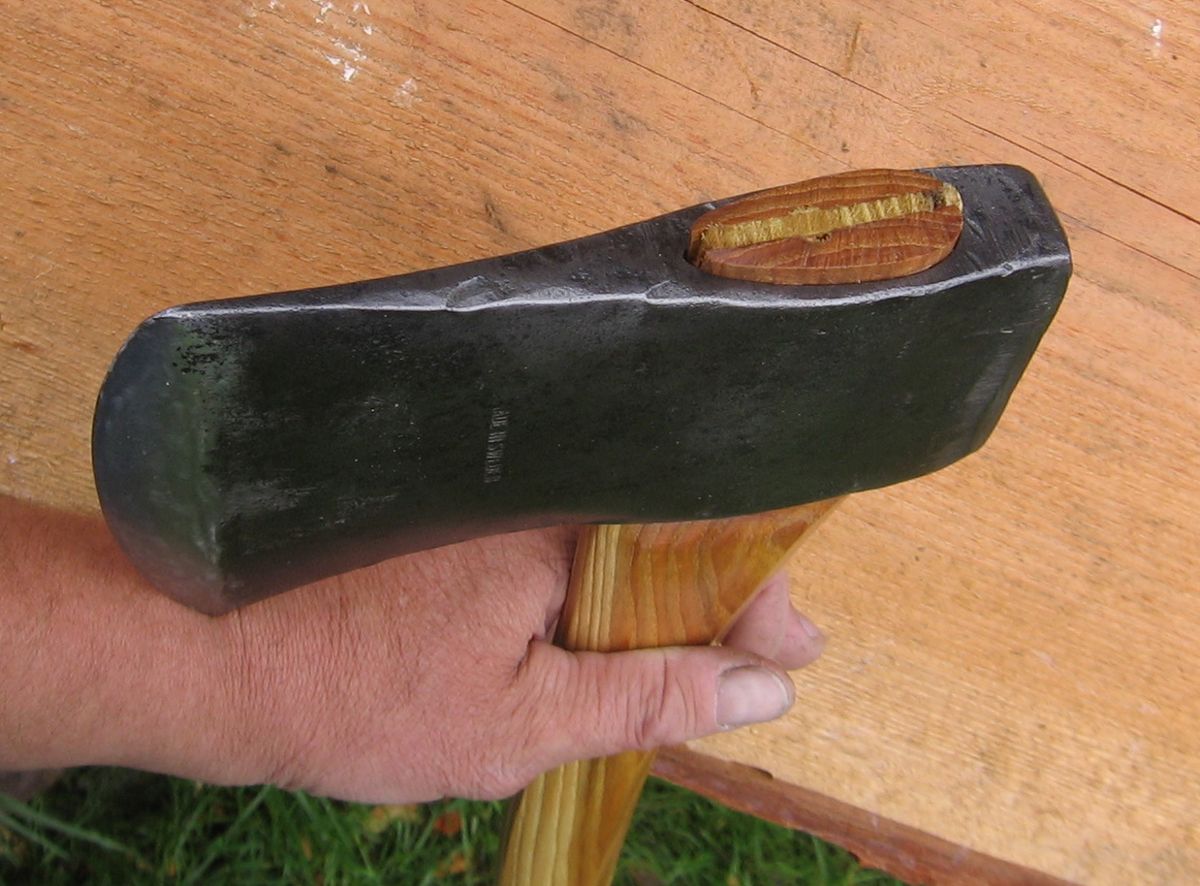

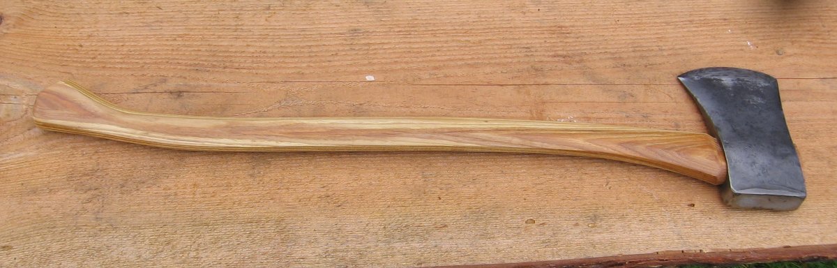

I finished this one for a friend over the weekend. It was his grandfathers. Made in Sweden but no maker's mark. It had a slightly deformed eye and poll from being used and as wedge. My buddy cleaned up the poll and I corrected the eye. Strange eye - 3-1/2 pound axe with an eye closer to boy's axe size than full size. I hung it on a full size haft but had to remove a lot of material to get a good fit. Haft is a 30" octagon from House which I did some serious spokeshave work on both for size and to get a more balanced look. Finish is 2 coats of BLO followed by 5 coats of tung.
