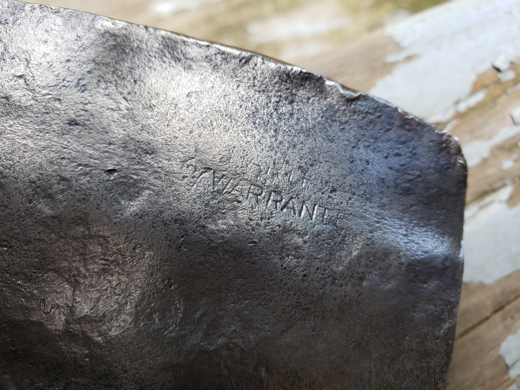

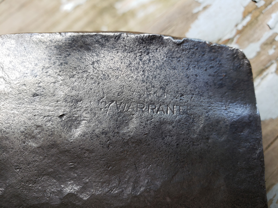

Well...turns out to be a Collins Crown and Hammer Hartford Legitimus Warrented, Connecticut pattern. Sadly i can't see how many points in the crown. I have my suspicions.

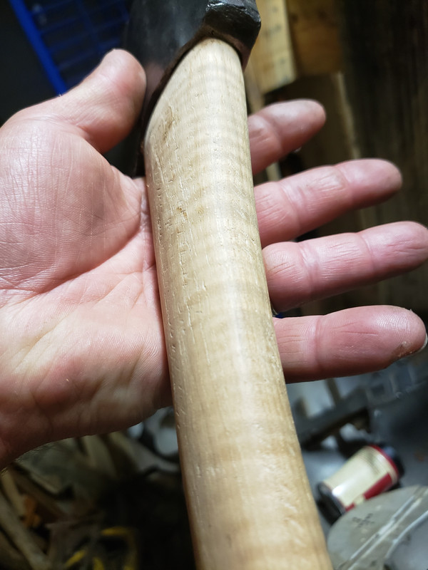

I think it will serve me well, back in service on this Link boys 28 that seems to have a light curly hickory action happening

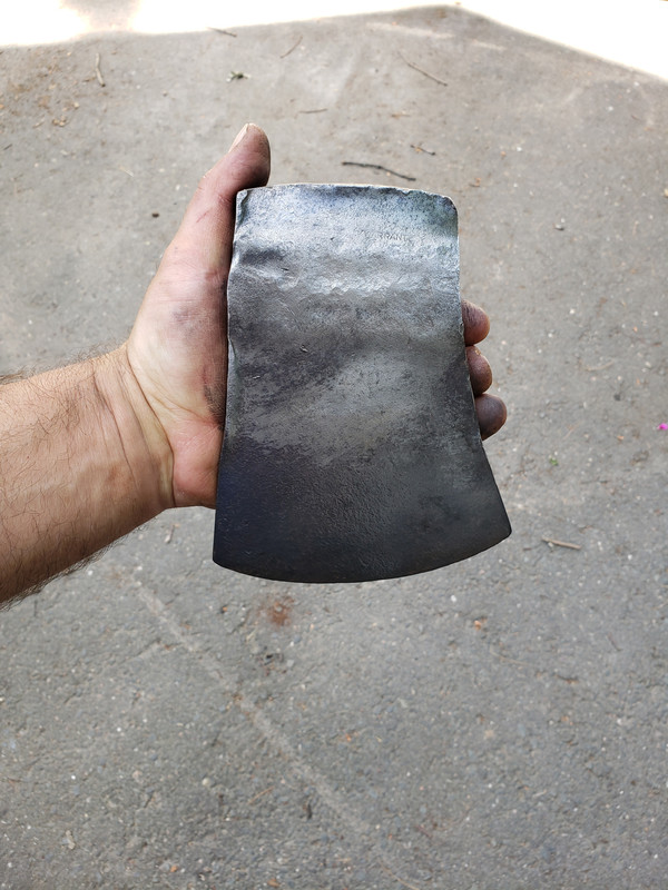

I soaked the head of the EC Simmons in vinegar, and this is what it looked like. Note, what I'm calling the temper line, between the rusty portion, and the gray area. Than there is black on the bit. Can anyone tell me what causes the black, after a vinegar bath?

I believe this axe has high carbon steel overlaid bit (grey steel). Black steel= that part was hardened.
Thank you carbon steel addict. I have never seen anything like the black portion of this axe head. It doesn't scrub off with soap and water but, when dry, it rubs off with a paper towel.
I would like to know if the "black" is carbon coming out of the steel.
