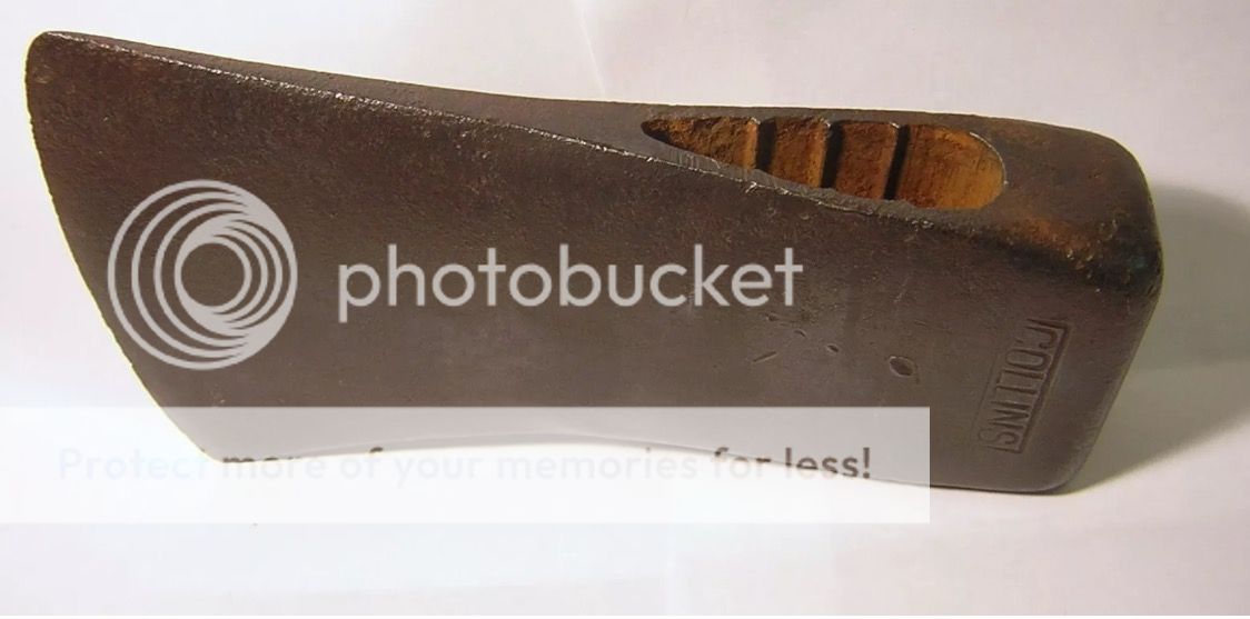

Axes with eye ridges....
So we have Kelly, Vaughn and Collins with ridges in the eyes. That does not rule out others, but I have no other proof.

I'll put this out for discussion: Are eye ridges alone enough to say who manufactured a head?
