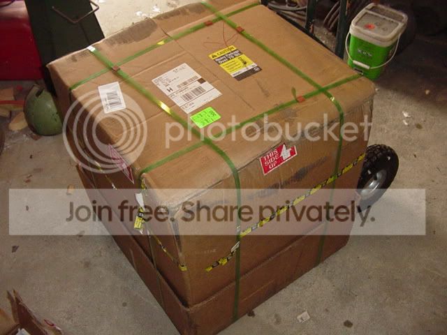

http://i43.photobucket.com/albums/e396/dimenickel/New Machine/DSC05027.jpg
http://i43.photobucket.com/albums/e396/dimenickel/New Machine/DSC05033.jpg
http://i43.photobucket.com/albums/e396/dimenickel/New Machine/DSC05034.jpg
Thanks again for the advice... the machine is incredible..!
so smooth.. and quiet..
tried to grind out a blade and i'm impressed with the control... it so nice to be able to grind looking down on the blade... not like my coote, where i'd grind a flat spot on my head if i leaned in too much..
the 1.5hp variable speed does have some nice power..
i love it..;) :thumbup::thumbup::thumbup:
Greg
