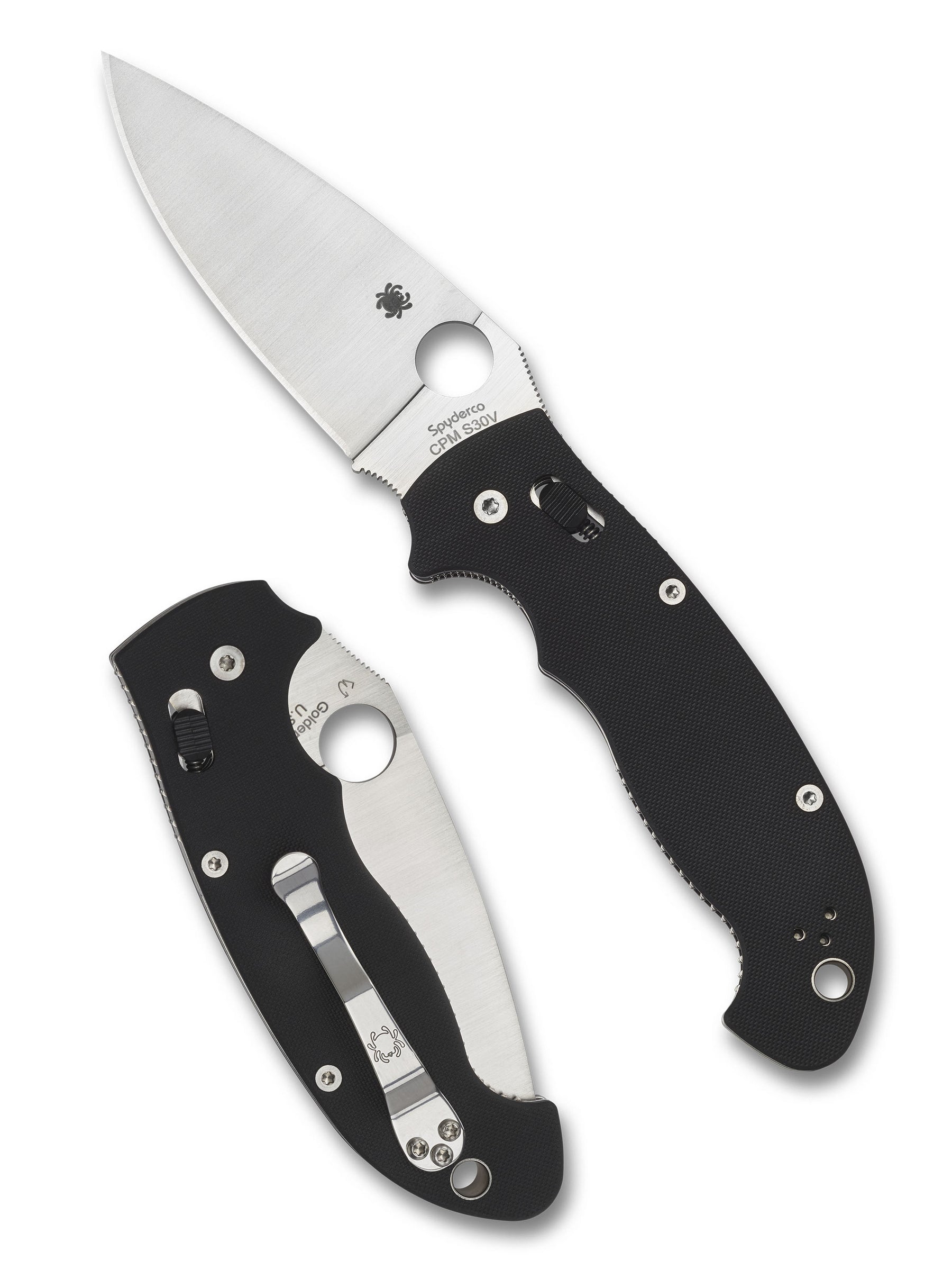

I noticed a review of a manix xl where the reviewer said after 2-3 years the lock would disengage just by trying to close it with two hands and without even touching the cage. I am curious if this has happened to anyone? Could this person maybe just need to clean out their knife? Or can the knife wear down in any way that the ball would stop staying locked in?

One of my original Dodos would fail like that until I did a little work on it, but that was the BB lock, not the Caged BB lock that came later. I know a lot of people think the CBB is too stiff and hard to disengage, so they take their knife apart and shorten the spring to lighten it, after which all bets are off. So my questions would be:
1) Is the knife genuine or a counterfeit?
2) Has the knife been modified?
3) How has it been handled? Two or three years of hard inertial openings will take a toll. So will opening and closing it for hours on end. Parts wear in use.
4) Why is he posting a video instead of sending it to Spyderco for warranty?

From that video, it looks like the spring is stuck and not pushing the cage ball bearing into the blade’s tang. Therefore it doesn’t lock. Likely there is something in the spring slot that’s stopping the spring movement, maybe years of debris & crud as you mentioned. Another possibility is the owner modified the spring by cutting a portion off to make it easier to “pull back”, maybe overdoing it & cut the spring too short.
