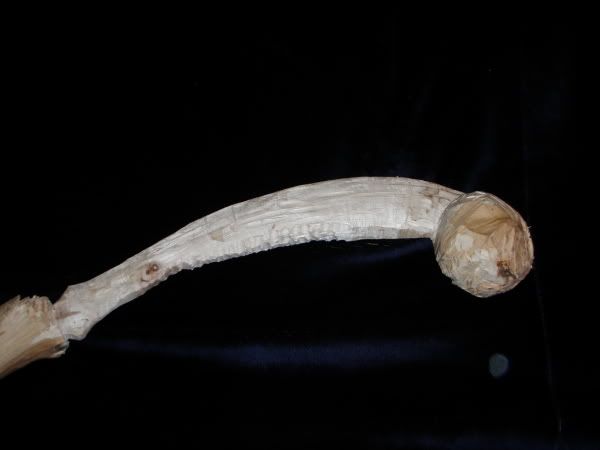

Ok.Here's my NEW club at it started out.......

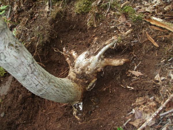

I was about 40 feet up the bank to get that one.The river has flooded hard over the last few years and totaled all the trees lower down.I got the tree on Friday....
That's what it looked like by Sunday.I have it drying in my room on top of my dvd rack.I'm thinking of picking up some wood stabilizer for another project and I'm thinking about giving it a good dousing when the time comes.It should harden it up a lot after it's dry and all sanded.I used my Aurora and some wood chisels to shape it with some help from a hand saw.
so the blank should first be dried, then rough shaped? or rough shaped then left to dry out? and when all is said is done, what kind of treatment would you recommend? linseed oil perhaps?
I love these clubs. I ran across some advice a long time ago for making a self bow. Harvest the wood in February when sap levels are at the lowest, hang in a cool dry place to cure for about a year I believe. Then start shaping.
On mine I use a couple coats of minwax stain followed by a couple light coats of satin polyurethane.

Your getting It Done "SavagesicSlayer", You got something started here In this Topic "It's Great "And your Ball Head War Club Is taking shape ! We got Ton's of exposed root system's here In Eastern Nebraska on the Bank's of the Missouri River, Most of the Tree's though are Cotton Wood's some Mulberry though, I wonder If Mulberry would be a Good Wood to use ?
We do got Willow's though and I did a seach on Google and In Wikpedia It said this on Willow Root's, This might be my Wood !
Willows all have abundant watery sap; bark which is heavily charged with salicylic acid; soft, usually pliant, tough wood; slender branches; and large, fibrous, often stoloniferous roots. The roots are remarkable for their toughness, size, and tenacity of life, and roots readily grow from aerial parts of the plant.
south of my town, cedar is abundant, very abundant. this seems to be a relatively hardwood. the hard part about this will be finding a long enough and straight enough tree to begin with. there is also oak, which should yield more profit. well see. i think this thread gave a lot of people a new hobby, like any of us need another. well done none the less
