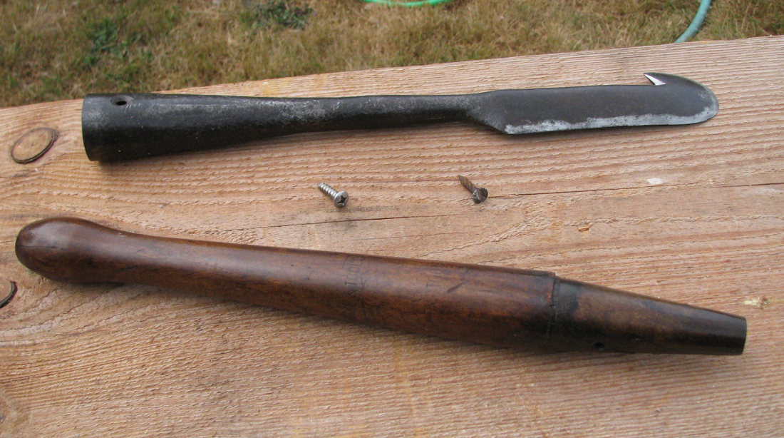

Not axes but these are another tool I've been interested in lately. I just finished re-hanging a pair of bark spuds. One of these came from a fellow forum member - thank you again.
Here they are before hanging. The one on the left is a Warren, the other is a no-name.
Here's another picture of the Warren. The head was slightly loose on the haft which had shrunk over time. Taking it apart was a challenge. It had a screw in it that was more of a twist-shank nail than a screw. I had to replace that.
Here's the no-name. It had a rusty wood screw in it which I replaced with another SS screw.
Here's that twist-shank nail/screw thing I had to remove from the Warren. To remove it I had to re-cut the slot with a Dremel tool and then reshape a large straight-slot screw driver to fit the new slot closely. Even then I barely got it to turn. But it came up enough to get a pair of Vise-grips on it. Then I twisted it out the rest of the way.
Here's the pair of them re-hung. We use these on trail projects when we have to peel cedar logs for use building trail structures.
The Warren bark spud will join his brother, my Warren Cedar spud, on trail work projects.

I wish I knew what those screw/nail hybrids were called. I've found them in a number of tools and they just about always seem factory. It was likely so they could be hammered in but removed with a screwdriver by the buyer if need be.
Doesn't help that half the time they're rusted in pretty good.

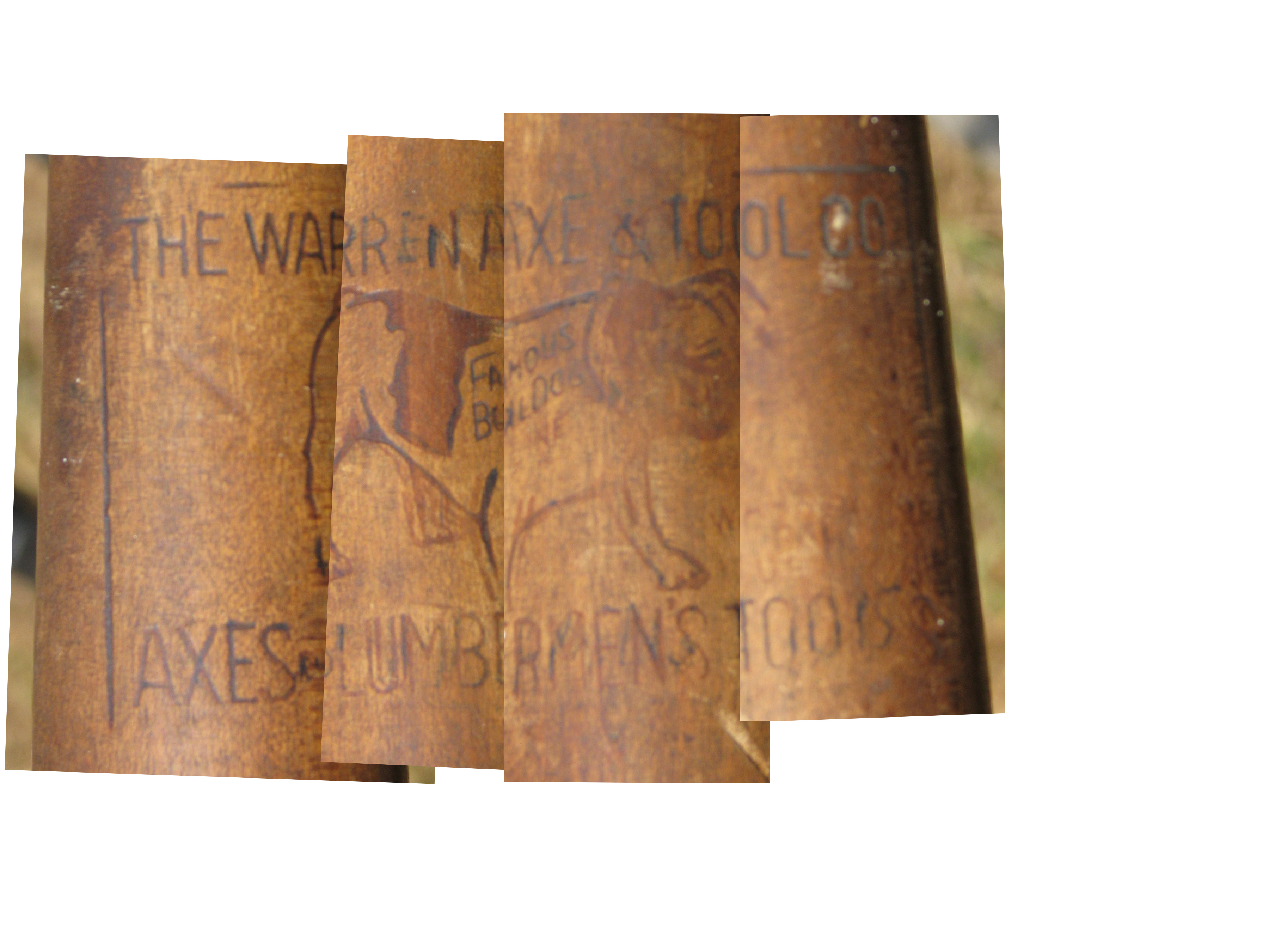

There is a really cool Warren stamp on that handle. I've never seen another one. Refinishing with BLO has made it less visible. But for posterity I photographed it before refinishing. I've assembled 4 images to capture the whole stamp across the curvature of the handle.
It reads,
THE WARREN AXE & TOOL CO
FAMOUS BULLDOG LINE
AXES
AND LUMBERMEN'S TOOLS
Does anyone have another image of this bulldog? Operator?

Here's a bulldog image from the 1937 catalog but it's only of the head.
There are also some sketches of spuds and peaveys in the catalog with a paper bulldog label but not with it stamped into the wood.
Thanks for sharing that stamp. Its not often you can read the old handle stamps and that is an exceptional example.:thumbup:
