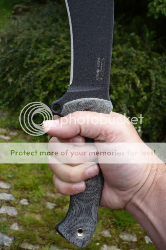

I didn't mean to imply that it was some kind of major flaw in the knife, I was just curious about what your plans for it were. having not used it, I wasn't sure if it was going to be too sharp or not. 5 minutes of sand paper work on the handles slab isn't anything to be worried about :thumbup:
I was'nt meaning you LVC .... I was worried I had caused HISknife to feel "devastated" over the handle issue .... and did'nt want to start a rock rolling down hill just before these are released ....
My thoughts on the TTKZ handle being "ideal" I know are shared by you .... but the KZII should still be "up there" handle wise if tweaked ....
On a preference thing I may re-shape the pommel area .... I prefer a "single" grip and weight forward "feel" .... I may grind back the handle at the rear to take some length out of it to alter the balance forward and reduce the over all weight .... I also might curve the spine to one fluid shape as per the TTKZ out of personal asthetic preference .... but none of this "needs" to be done .... I just want a lighter more blade heavy balance .... then strip it .... anyway .... first things first .... I will sand that edge and see how it chops and do a review then ..... :thumbup:
I would love to see a head to head when you are done playing with the KZII compared to the TTKZ.... and what your thoughts are, and I'm sure everyone else here would too... Good job!
Sorry, I didn't want to sound so melodramatic. I'm pretty sure when I have the KZ2 one day, I will be able to mod the handle as well. I was just thrown off balance, as my experience with Busse were almost exlusively with Mistresses (except for one ASH-1) and handle was one thing I took for granted when it came to Busse knives. I mean my last NMFBM's handle was about as ideal as I could have experienced on a knife. But I await further review, sir, with bated breath. And I do immensely appreciate them.

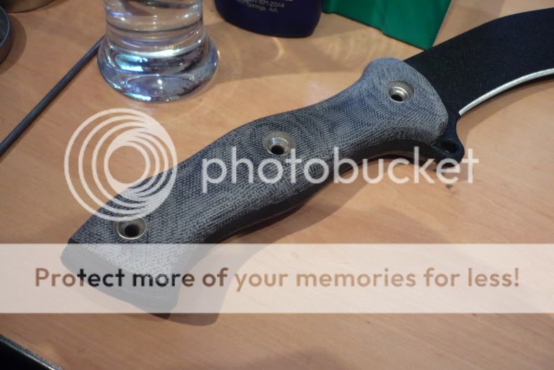

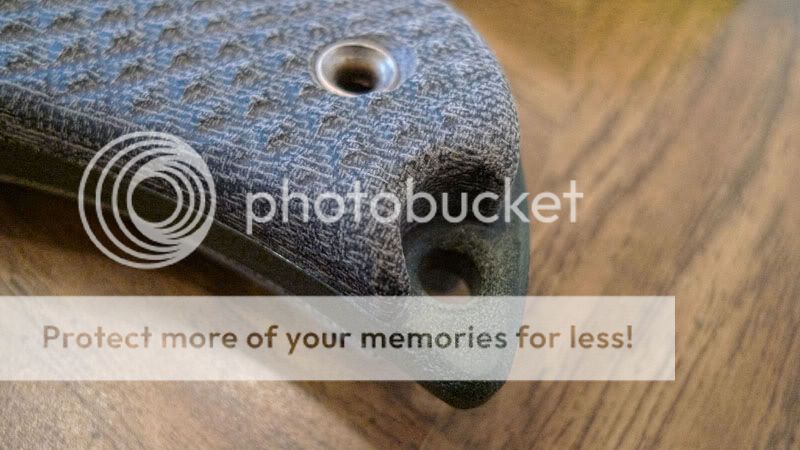

This is what I've done to the scales on mine, it's not much but it keeps it from biting in at the corners.
If I had to modify the design without just replacing it with the TT version (:p) I would just cut the palm side of the pommel flat. I may end up seeing if garth would shave it off and round out the lanyard hole. I wouldn't necessarily slope it as severely as the TT, just get it to where it goes straight back instead of curving back towards the palm.
When I made the handle for my HI ang khola, I had a very similar flare at the bottom and after using it I ended up shaving it flat. The idea of the new design was to give you more control, people felt that the TT version was going to roll out of the hand. By having it flat you get that, but without the potential for it biting back into the palm on the down stroke.
The biggest thing to remember with this 'issue' is that it is mostly felt when you hand is choked back. when your hand is in the middle of the handle it's less likely to hit the pommel flare.

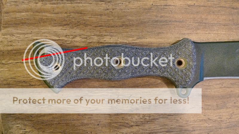

Wish I could use this "red line" skill .... but if you bend the red line down so that the total eyelet is removed and the curve goes back to the spine .... that is what I might do .... the handle would still look proportional then and almost like it was done that way originally ....

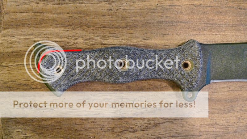

I edited the original to include the rounding to get rid of the cut-in-half hole
and here is the no-lanyard-hole flat from the palm swell version :D
gotta say, it would pretty good like this. not as severe as the TT, but more than enough to remove the pommel swell issues. actually, it looks a whole lot like the ergo handles, but with less difference between the index and pinky positions.

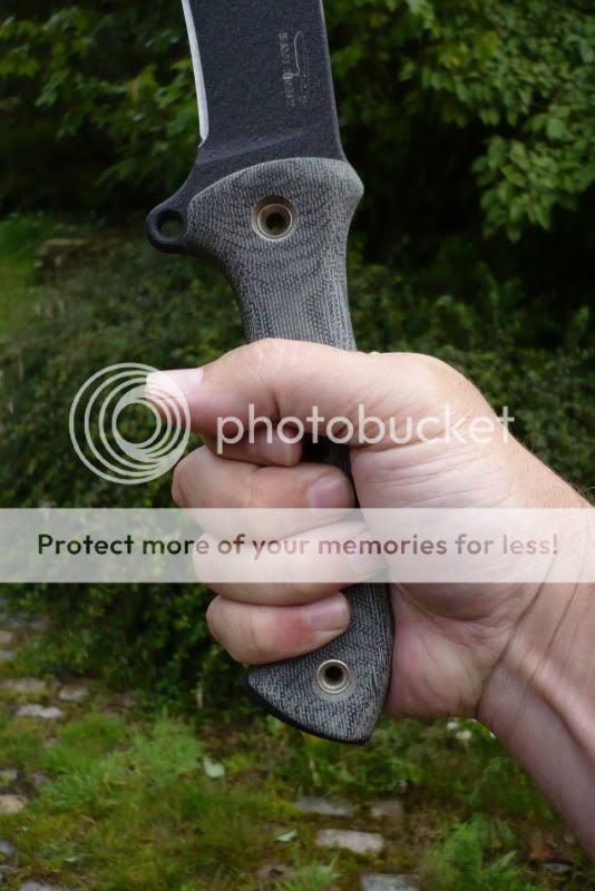

No. There are two issues at play, the sharpness of the micarta, and the nature of having a pommel flare that curves upward toward the palm. The part peter was talking about causing blisters is mostly the sharpness of the micarta, which can be rounded by sanding.
However, the pommel swell will still come up and hit the wrist/palm on the downstroke. this is most noticeable when you grip downward. in order to avoid having the pommel swell come up and hit your wrist, you have to keep it slightly angled so it comes up past the wrist on the palm side.

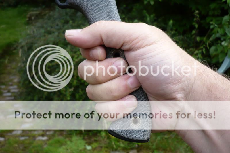

When you grip it from the center the pommel swell isn't that big of a problem, but when you grip it farther down:
that pommel swell becomes much more noticeable. The only way around this is to lessen the upsweep by taking off metal like the picture in my previous post with the red line on it. my understanding of how pommel swells interact with the hand is based on past experience with khukuries rather than the kz2, it is inherent in the khukuri handle design. The kz2 is basically a traditional khukuri handle shape, and thus has some of the inherent flaws in that design. I think peters modification, where the palm swell is continued on it's downard slope so that the rear lanyard hole is removed is an ideal solution. It would make a handle shape that is very similar to the older ergo handles, but much improved. You would still get the long handle for multiple grip positions and the wide curve/berth for wrist snaps, but without the pommel flare in the wrist problem.
In a normal or choked up grip, you probably won't notice it. It's a traditional shape that is good as it is, it would just be more versatile with the pommel flare clipped off on the palm side.

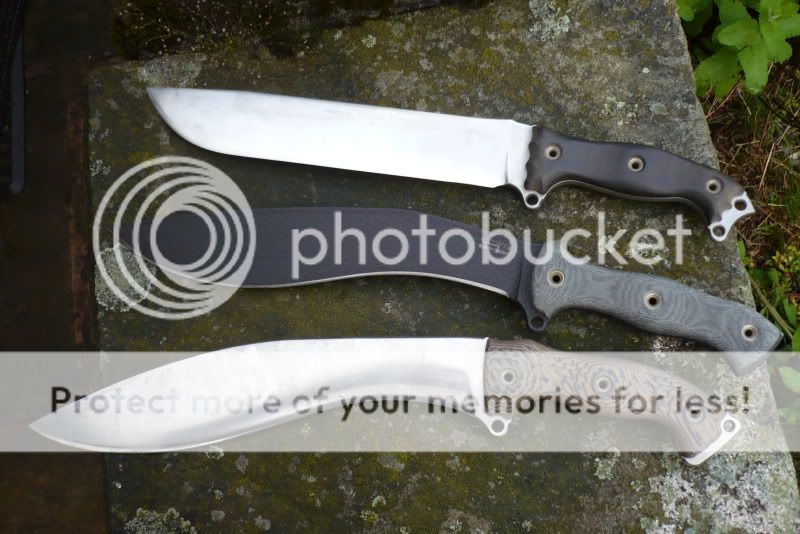

So taking the plunge I decided to re-grind the handle pommel as per the discussion above ... and then I went ahead and curved the spine and stripped the blade .... here are some pic's of the results ....
The downsweeped grip on the handle spine certainly feels better for me when chopping .... there is no "catching" at all on my palm or wrist ....
