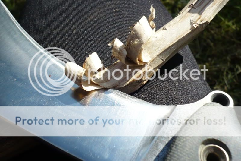

I did a bit of work with the knife using the forward grip for delicate stuff like fuzz sticks and the blade shape works really well ....the shallow area just in front of the grip has a lot of control ....
Even using the forward part of the blade and the tip was good ....

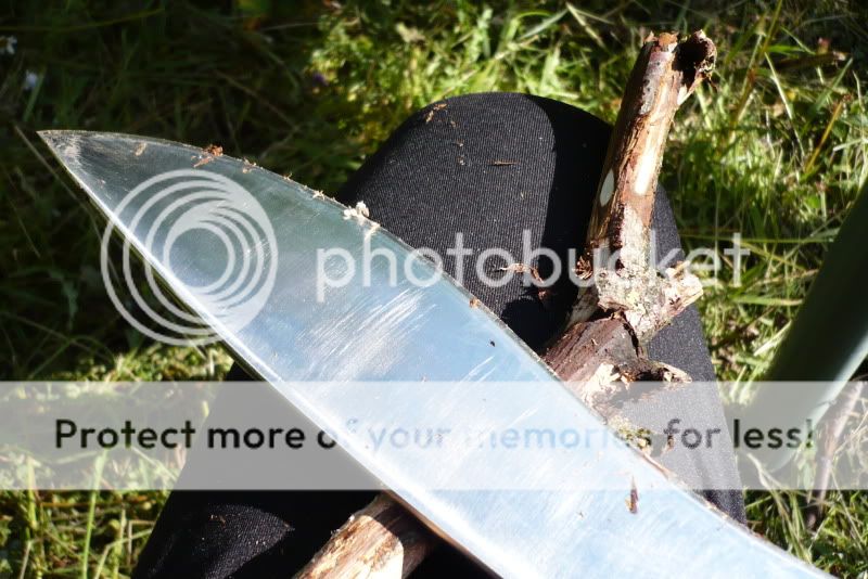

Whittling off wet bark from odd shaped sticks is a good test of using the point to get into the awkward bits .... and whilst there is obviously a fair distance from the handle to the tip the control was still there and it was'nt a case of the tip feeling too "remote" .... it definately scores better at these tasks than the TTKZ .... the lighter weight helps considerably ....

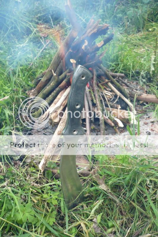

Once I had whittled enough sticks to get a fire going .... I sat down and gave some thought to how it had done and prepared a brew ....

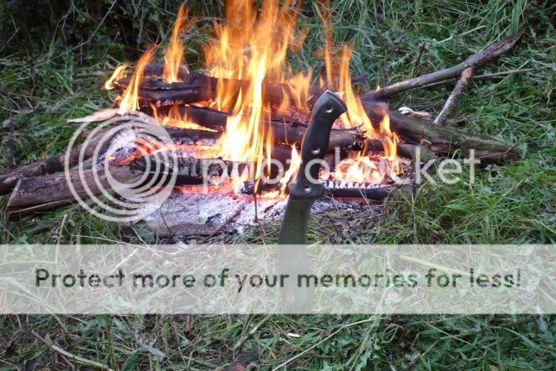

the wood was a bit wet with the rain and the fire took a while to catch ....although the smoke served to keep the midges down .... later on as I did a bit of limbing walking down the trunk of the tree the fire really got going just burning a few of the smaller ones off ....
Got a brew on and life is good ...:cool::thumbup:

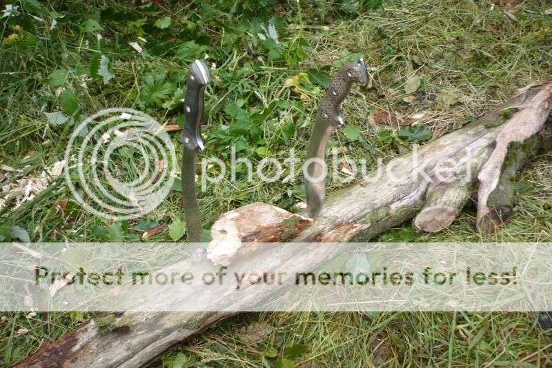

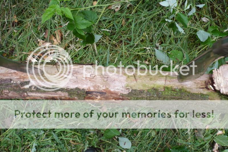

Well after sorting out my photobucket account due to bandwidth limits .... I can now upload some more pic's from the weekend where I decided to do a chop off against the TTKZ and the KZII.

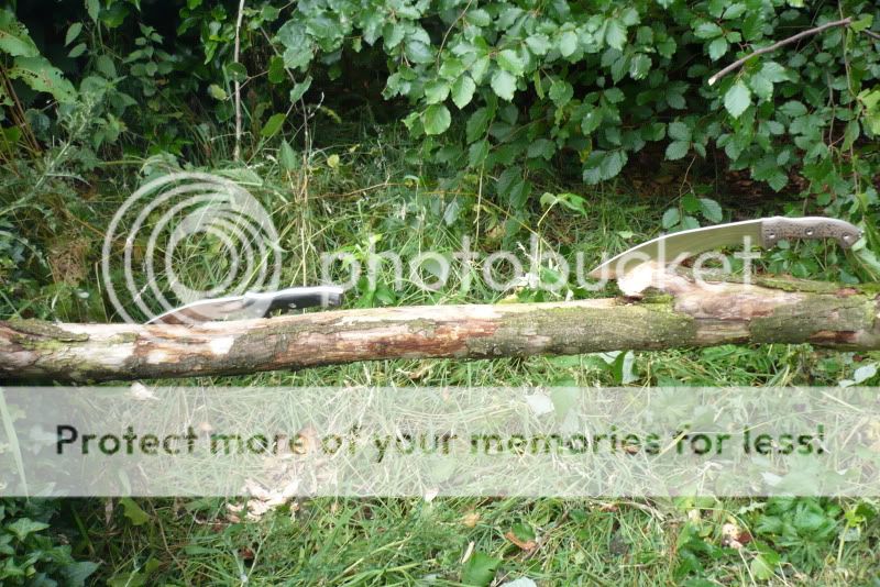

I used the trunk of the tree I took down and tried to line up the most even section so both would have the same task ....
I marked off two sections which had the same depth and the KZII is on the left and the TTKZ is on the right. The marks are tighter than the depth of the log ... usually it helps to go for the same width as depth as that gives you a 45 degree cut but when actually doing the cutting I widened out the marks .... the marks were mainly a guide to two areas where the depth was the same.

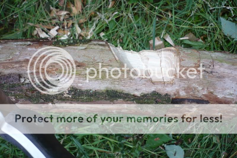

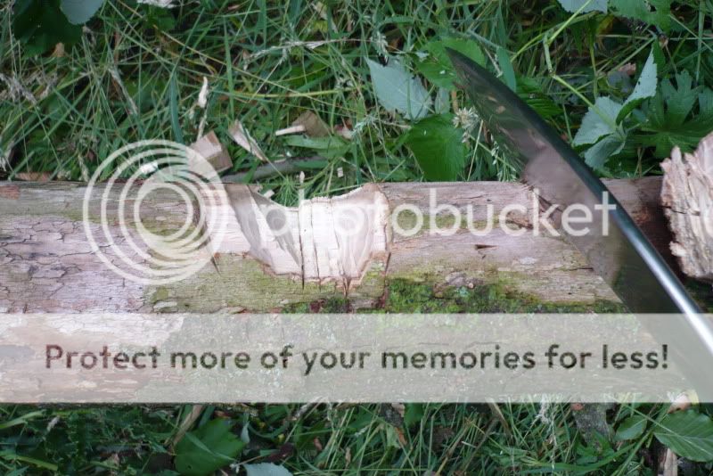

I started with the TTKZ and decided to go in multiples of 10 alternating.... so I could take some pic's and to make fatigue a gradual thing for both .... anyway here is the pic of the first 10 strikes with the TTKZ ....
Here is the 10 with the KZII ....

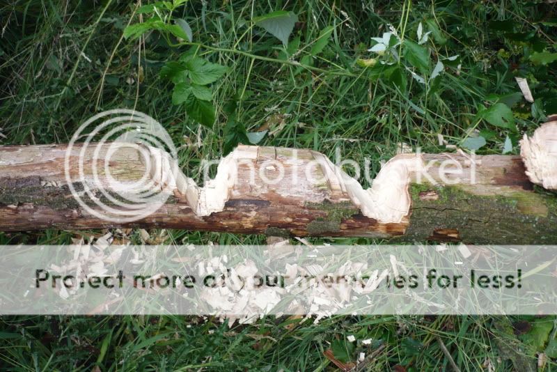

Then 20 with the TTKZ ....
20 each and it is still looking like both are "even stevens" ....

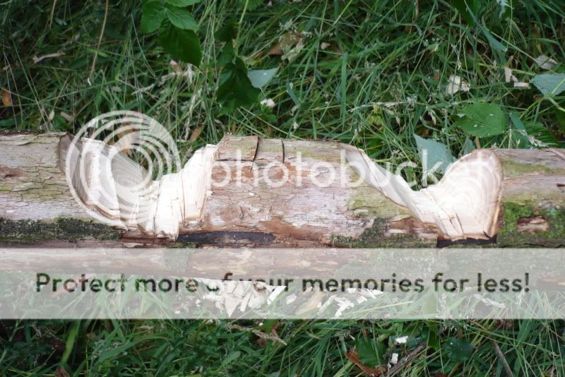

30 with the TTKZ ...

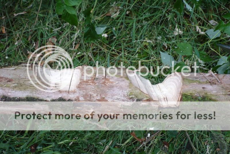

Then 30 each ....
Things are still looking more or less even .... maybe a slight depth advantage to the KZII :eek: ...

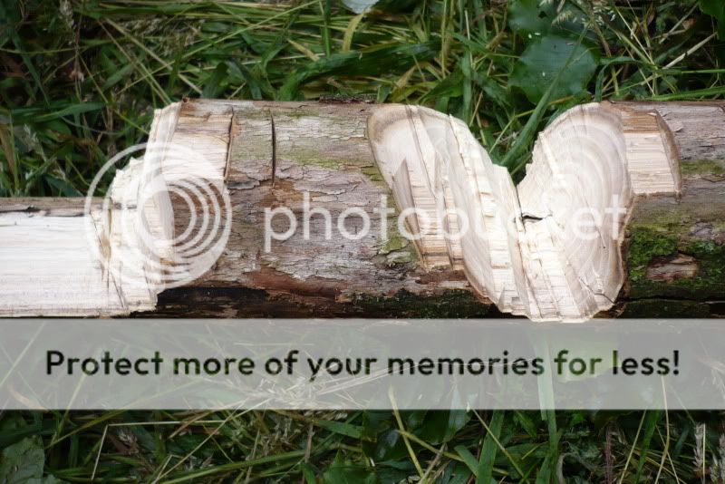

Well doing the next 10 for the Zilla had an unusual event happen .... I got a few strokes into the next 10 and then the log snapped .... but snapped on the KZII side .... :confused::D ....
So what do you make of it when that happens ???
I guess you could say the TTKZ and the KZII are both so close it is very hard to seperate them .... cleaning off the balance of the wood on the KZII side and the strokes needed to finish the TTKZ side were the same or there abouts ... I got to say I was so flumexed at what happened I did'nt take a detailed view of things after that ....so from recollection and going off how they felt I actually think the KZII does bite slightly deeper ... Jerry has certainly done a number on this one .... having re-ground my TTKZ which I thought was close to the grind on the KZII ...I think I will do some mic'ing of the KZII and see how the TTKZ matches up ... it still felt ever so slightly thicker to me in comparison .... which possibly makes the difference when the KZII can go deeper than the spine on follow up hits. The first 10 when they both had'nt gone too deep felt identical .... but as the cut got deeper the KZII seemed to be able to pull ahead .... but only ever so slightly ( to use that word again :D ) ... and my guess is that at the spine the TTKZ is a bit thicker and this forms more of an obstacle than a benefit ....
Anyway ... they both chop like demons :cool: Very hard to make a call on this ... but as the KZII is 5 oz lighter I am going with this one as the winner .... the new "king of the hill" :thumbup: :D
