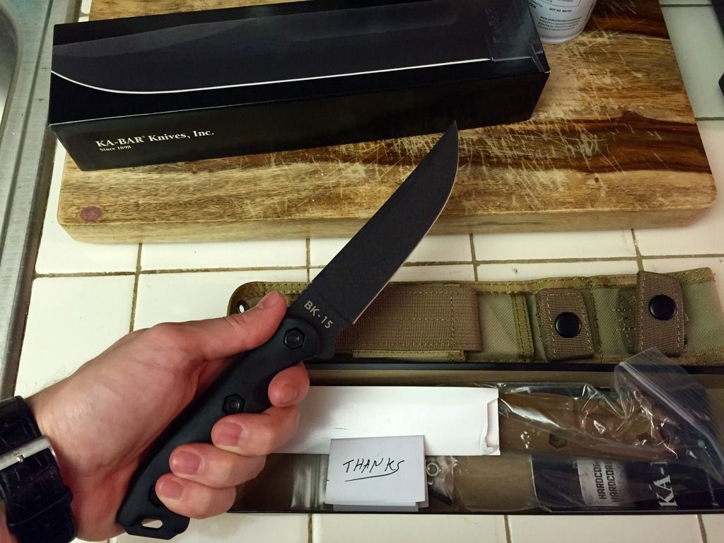

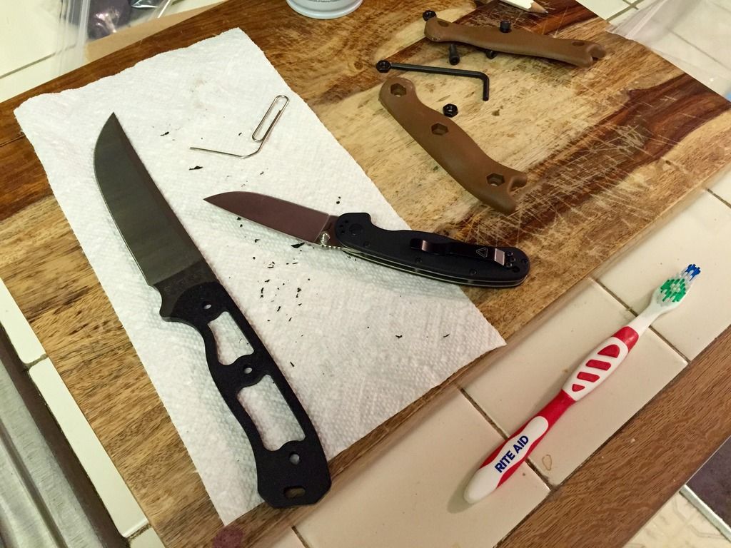

THE KNIFE:

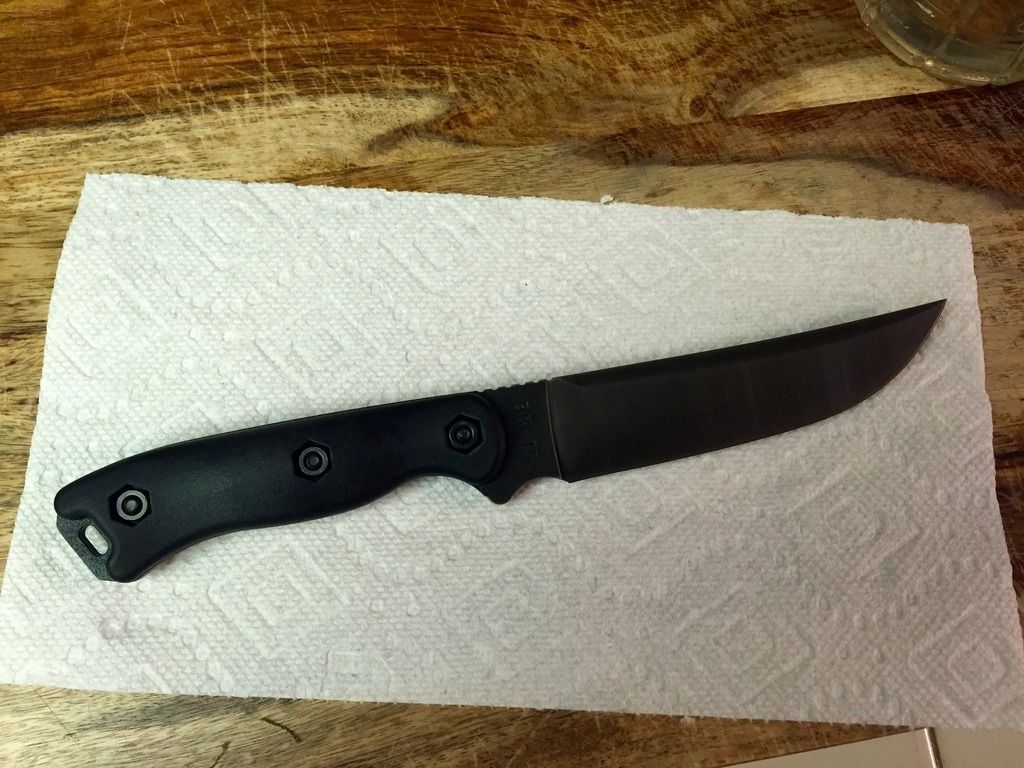

The BK15 isnt actually the first Becker I ordered, but it is the first to arrive. I ordered it specifically to mod. Once in my hand, I suddenly get why the Beckers have such a loyal following. It feels solid and quality. I feel really guilty that Im going to risk that quality by futzing with it.
Okay. Ive had it for a couple of hours. Now lets take it apart.

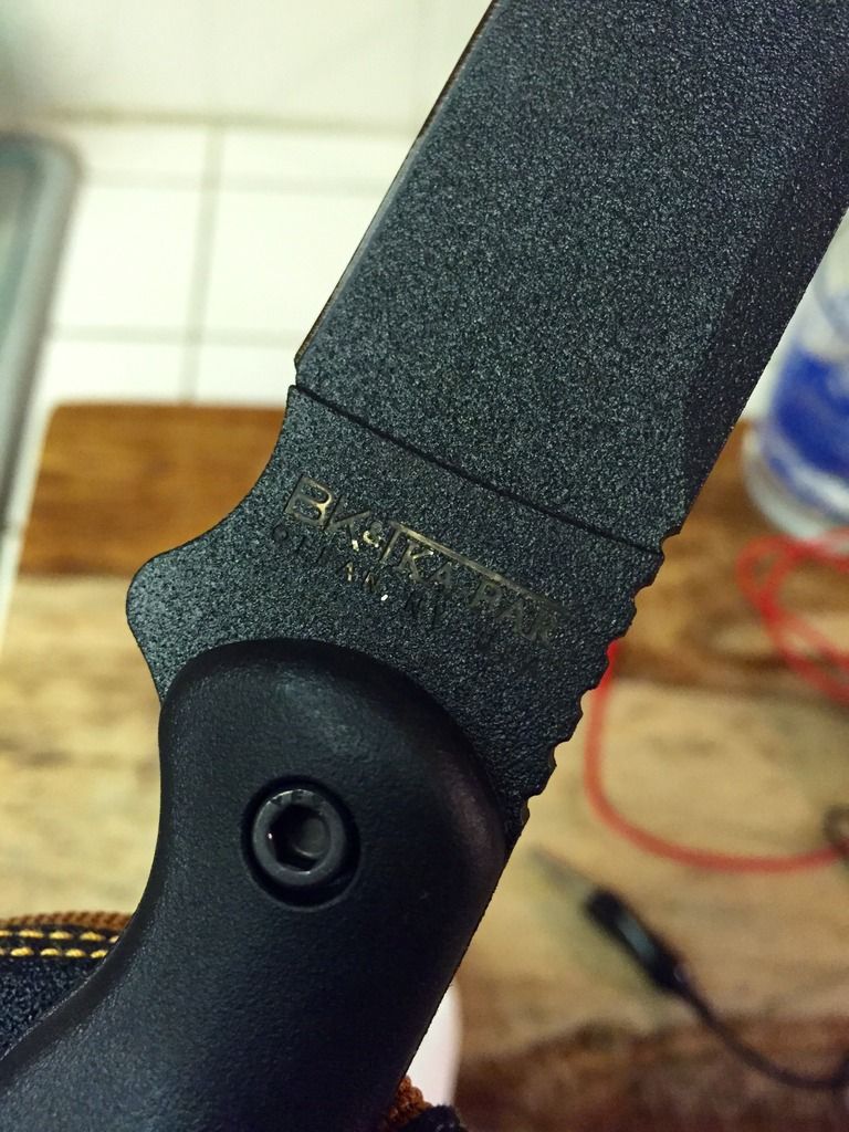

ETCHING:
Here are the relevant threads written by people more knowledgeable than myself:
1. A general thread on Becker etching:
http://www.bladeforums.com/forums/showthread.php/1303830-Becker-lazer-etching
2. granitestateofmind walks you through making a DIY electro-etcher:
http://www.bladeforums.com/forums/s...r-and-using-electrochemical-etching-on-a-BK12
3. A discussion of PCB (acid) etching vs. electro-etching:
http://www.bladeforums.com/forums/showthread.php/1306049-PCB-vs-Electro-etching?highlight=pcb

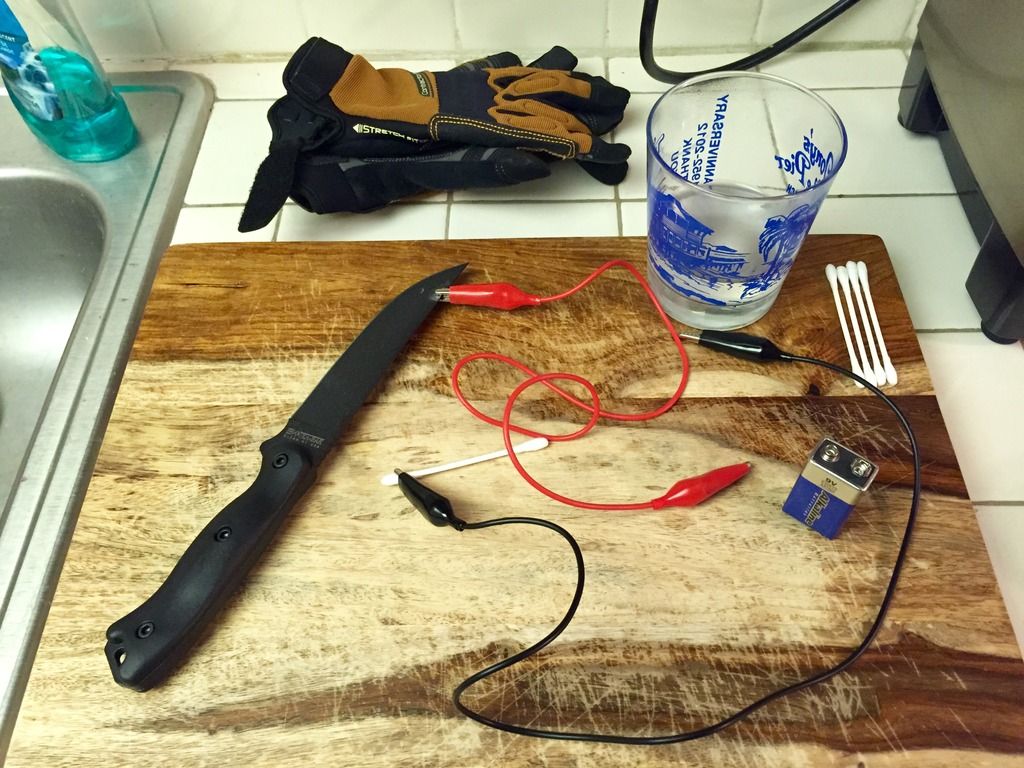

granitestateofminds thread is a wealth of info, but Im not up to building my own device. Instead, I find a video on the first thread about using a 9-volt battery (posted by TravisH about half-way down the first page) that I follow.

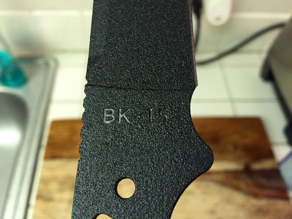

A touch of stripper so I can get better contact with the steel beneath:
My set-up. I recommend connecting the wires to the battery.

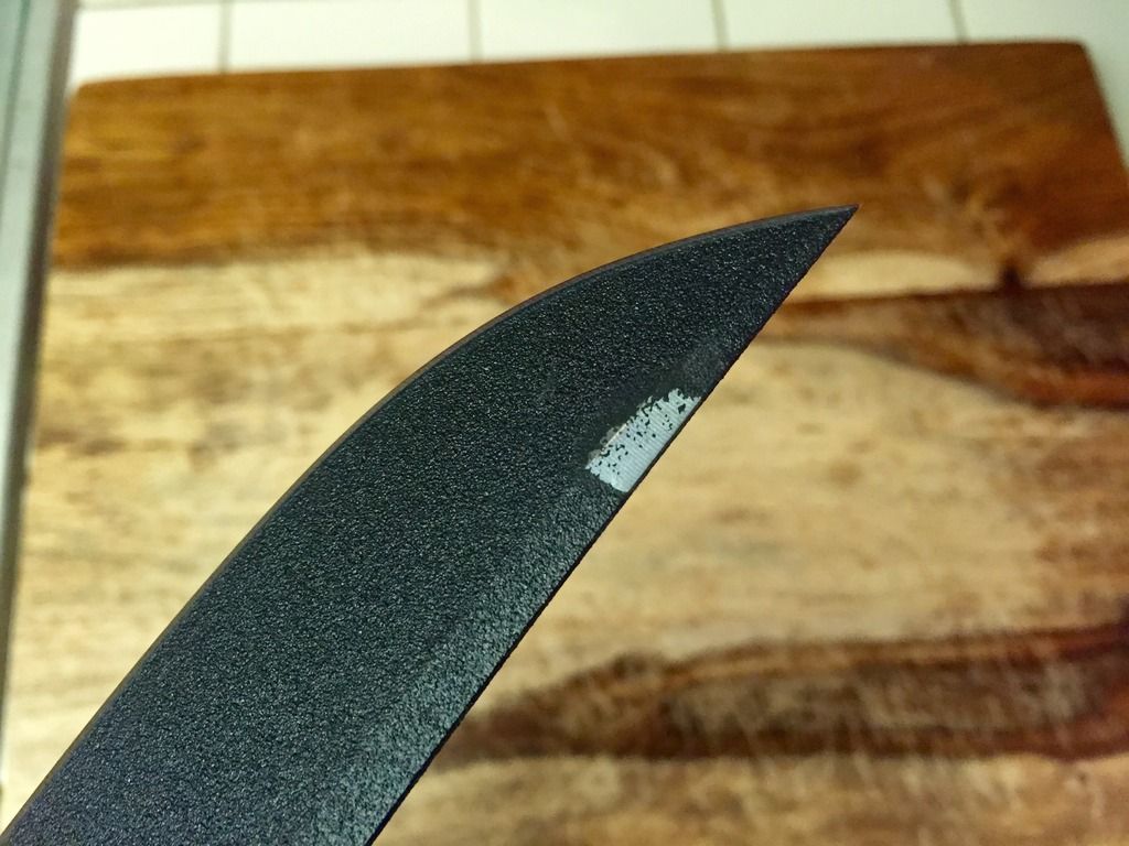

Its a little hard to tell when youve etched deep enough until youve gone through the process. I did 4 q-tips (8 ends total) until they were black and gross. Ended up plenty deep.
You can see the variation in the color of the etched steel from my DC-only approach. I could probably darken this with AC current, but Im okay with it like it is. (As it turns out, this will be a moot point anyhow once I add the patina.)

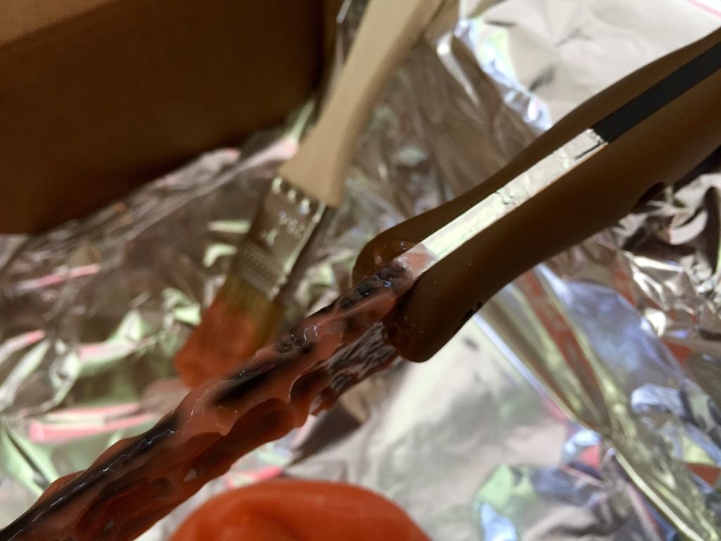

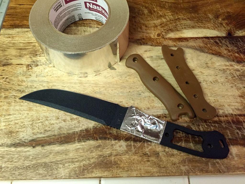

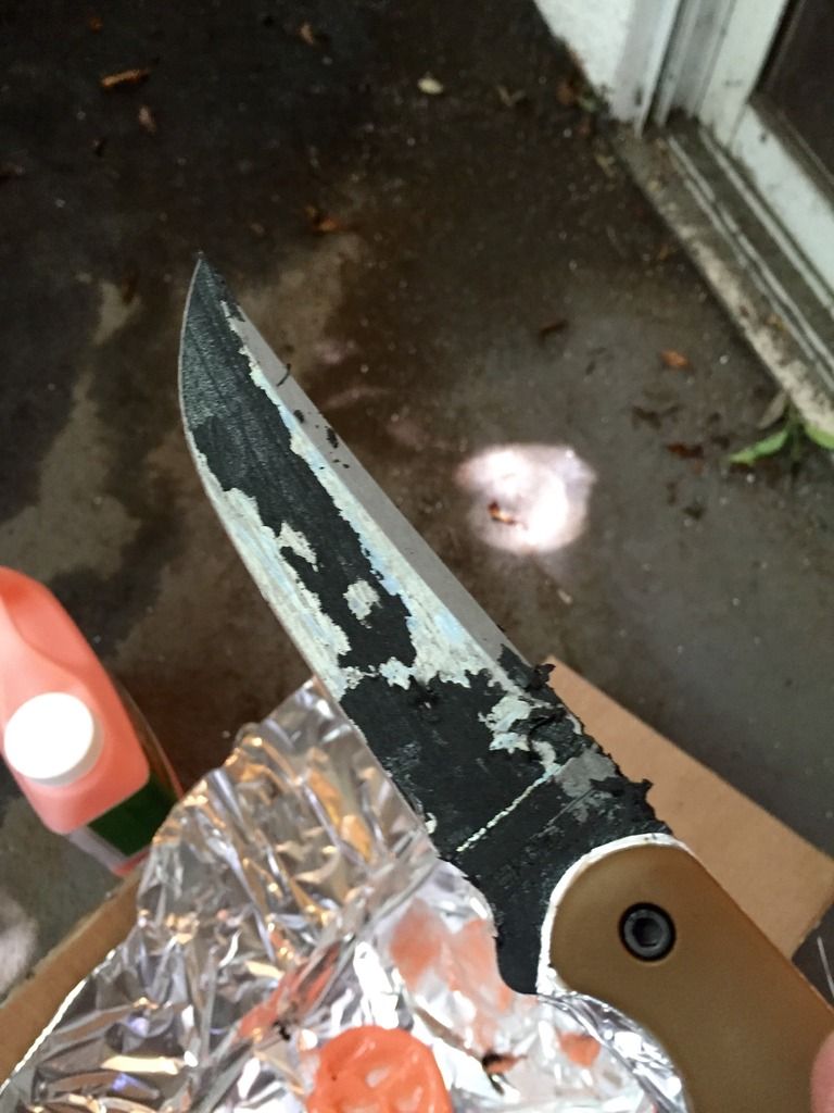

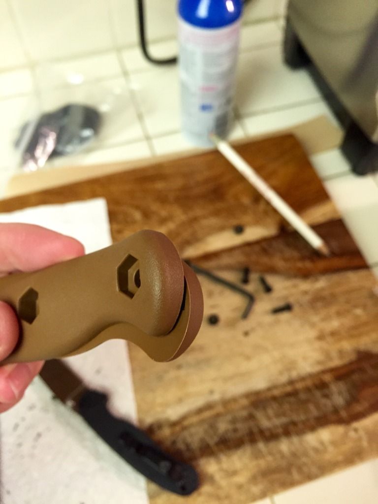

I took the Citristrip route. But for extra credit, I decided to try and keep the coating around the handles (with a little buffer room). I didnt know how strong the Citristrip would be or what kind of tape it might eat through, but I had heard foil tape was used when stripping paint from airplanes. So I picked up the cheapest roll I could find
Gave it a little shape with an Exacto-knife
And slapped on the Citristrip.

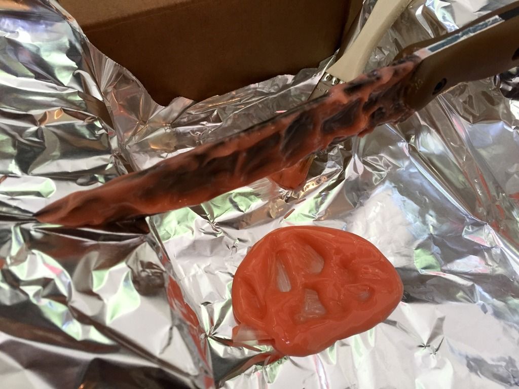

I make a point to get the stripper all the way up to the handles to see (A) will the tape hold and (B) will the Citristrip cause any damage to the handles (a question that came up a time or two).
I leave the Citristrip on for about 3 hours, then scrape it off with a plastic putty knife.
After that, I clean around the jimping and other details with a paperclip and folder.
The foil tape protects the coating beneath just fine. And the handles show zero damage.
Im no Channing Tatum, but I now know how to strip.

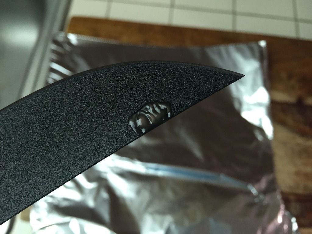

SANDING:

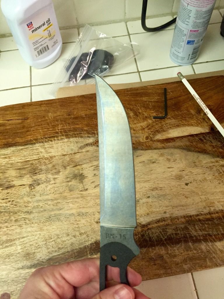

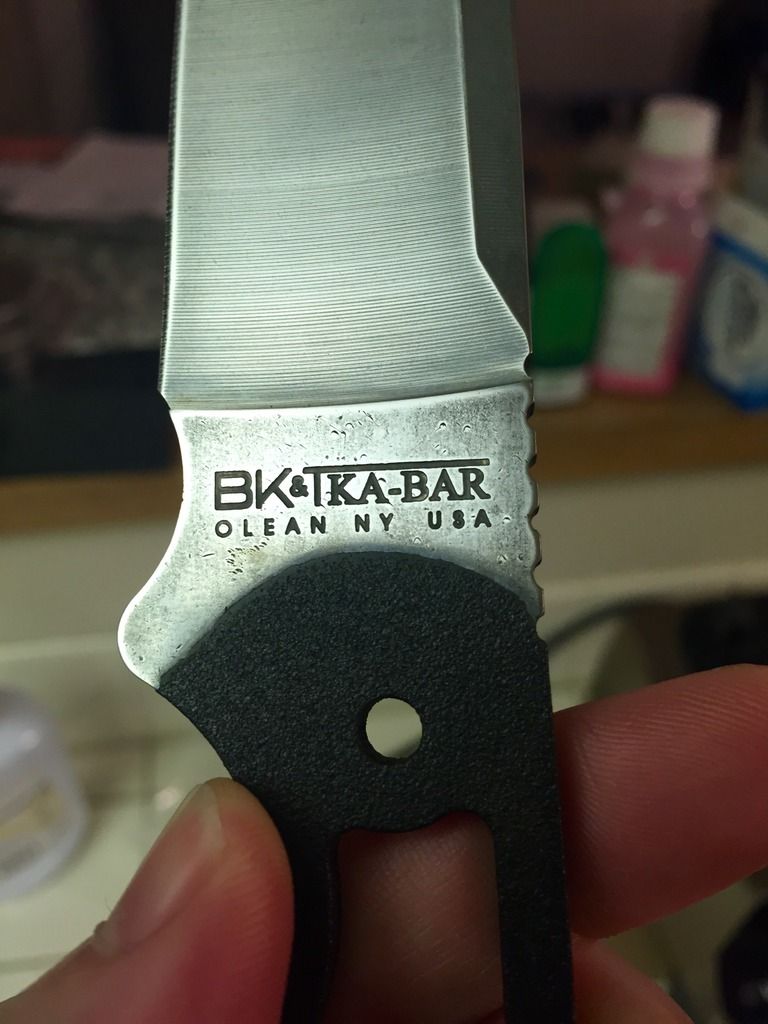

I have two different plans for sanding. One, to smooth down the coating Ive left around the handle (for no reason other than to experiment). And two, to remove the patina added by the Citristrip so I can add a different one.
Okay, so using 1000 grit paper, I start sanding the coating on the butt of the knife. After about 4 seconds, I see bare steel at the corners. Uh-oh. So this experiment has failed. The spots of bare steel are miniscule, though. Too small to actual be visible in a pic (so no pic provided). No worries, Ill patina those and no one will ever know theyre there but me.
The Citristrip patina is just fine. I could totally be done if I didnt want to keep playing. It looks like this:
Sanding the citrus patina off goes easier than expected. About 5-10 minutes with the 1000 grit on each side and Ive got nice clean steel. Not high-polished or anything. But good enough for me to move on.

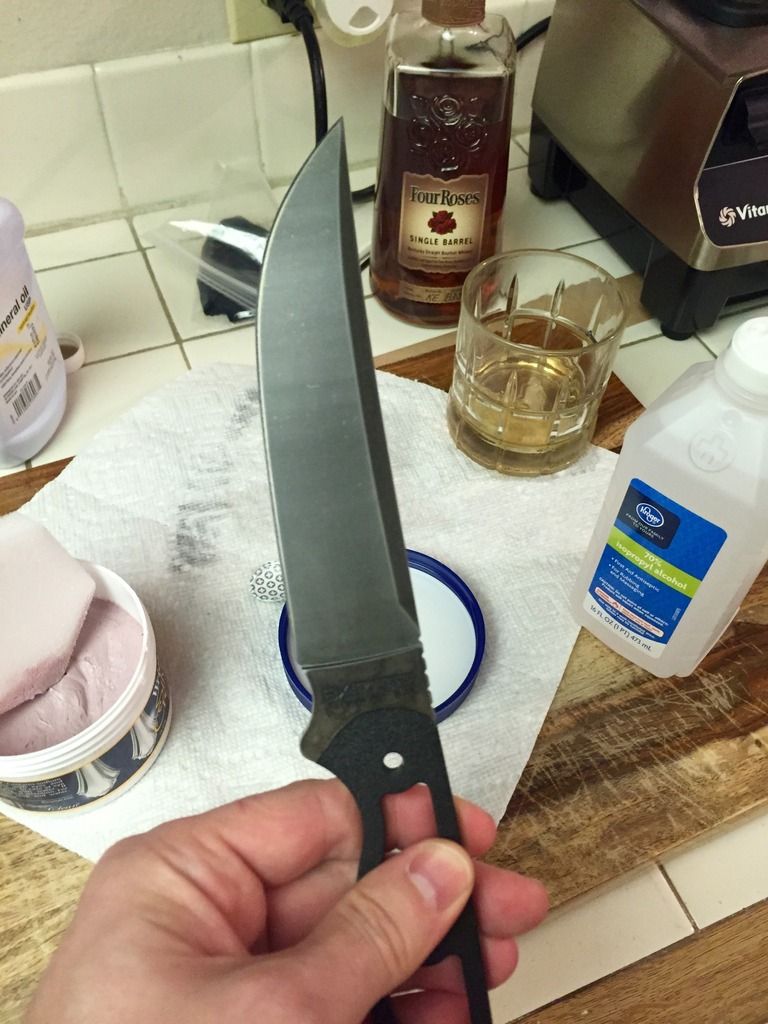

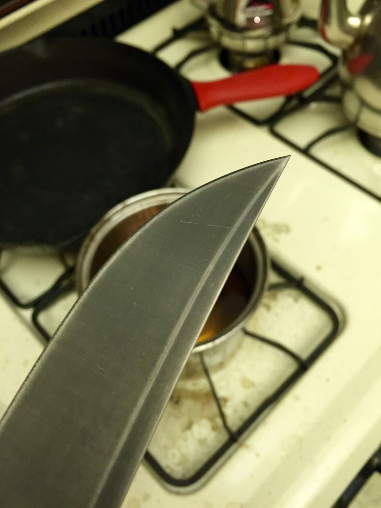

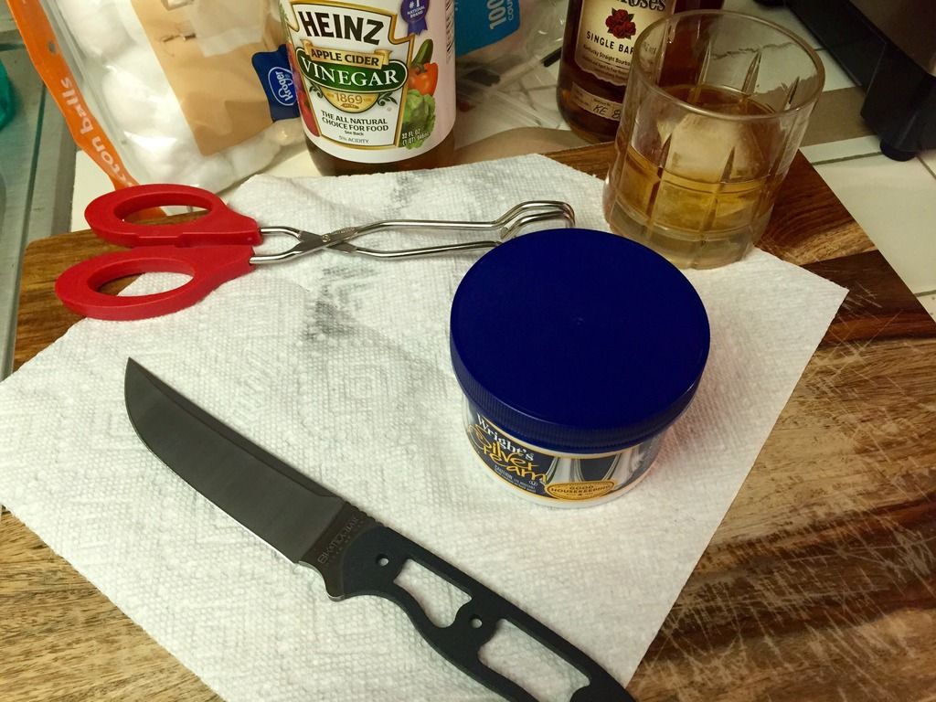

Man, I couldnt help it. Once I saw those dark patinas in that fourth thread, I knew I had to try it.
The ingredients for the dark patina called for a cleaner such as rubbing alcohol. But I could have sworn it said Four Roses Single Barrel Bourbon alcohol. Only after I purchased the bottle did I realize my mistake. Ill just have to find another use for the Four Roses.
After a couple of rounds of following all the steps, Ive got a decent but somewhat blotchy patina.
After four or five rounds total, were getting nice and dark. I stop using the silver polish because things are looking pretty even now.
With each pass, its getting darker, more even and consistent, and I find myself admiring the knife more and more. So I just keep working.

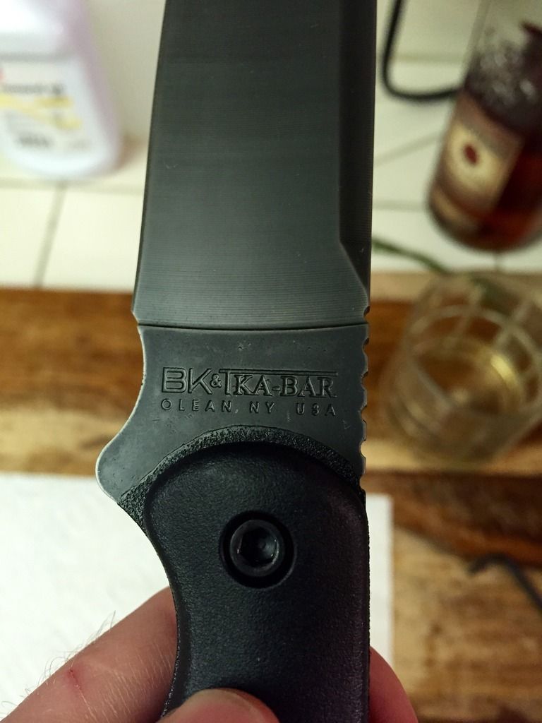

If youve ever had a fast food job, you may remember that golden fries dont come out of new grease. You need the grease to cook and burn a bit before it can add color. I think theres something to that here. As the vinegar burns and darkens in the pot, it seems to have more effect. So I keep working until Ive burned off, spilled, or applied all 32 ounces of apple cider vinegar in the bottle. I lost count, but its more than ten rounds and fewer than fifteen. Id guess twelve.
My place reeks afterwards. Not just of vinegar, but of BURNT vinegar. If my fiancé were in town, Id be dead meat.

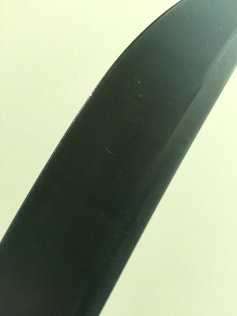

What I end up with is a dark slate gray blade. It is BEAUTIFUL.
There are a couple areas where the patina was slower in darkening and a few tiny flecks that just dont seem to take color at all.
But this patina is going to change over time anyhow. If I ever want to try to get it 100% black, I can always buy some more vinegar and keep going. I dont need to do that though, because you dont need to change the ones that you love. And I firmly love this knife now.
