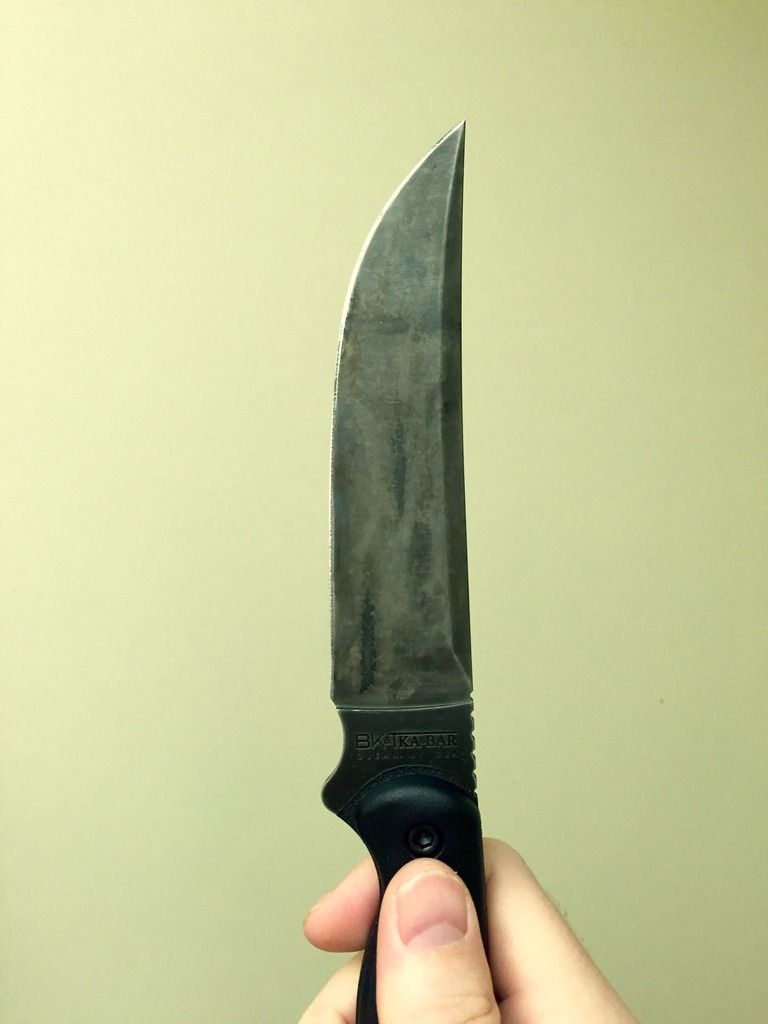

I love how you put so much effort into removing the black coating just to turn it black again! :) But, really, the end result looks top-notch.
Thanks! I eat too much citrus and vinegar-based condiments for that to last though.
If I host a fancy dinner, 5 minutes of sanding and another bottle of vinegar will spruce her up. But this patina serves its purpose just as well as the purty black one.
Very nice work. I bet that black patina would look nice after 30 minutes or so in a tumbler for a nice distressed finish ;)

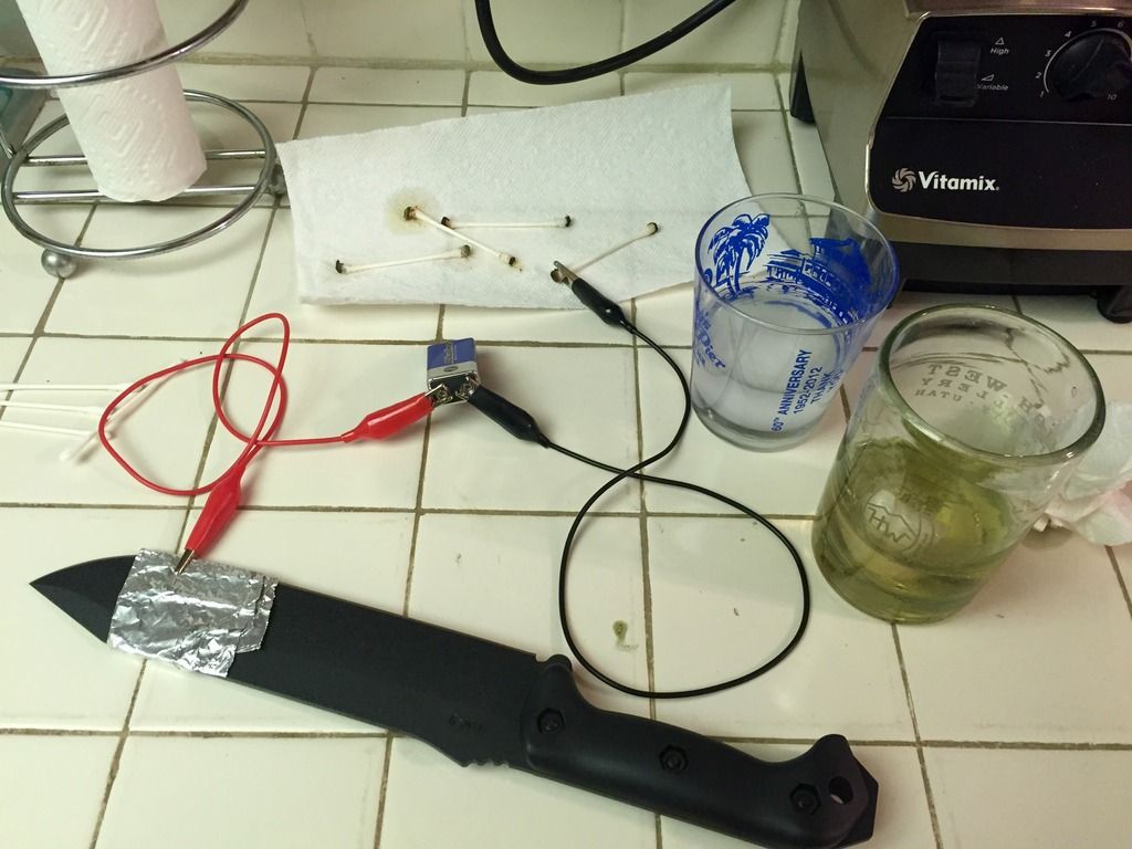

Quick question about electric etching - is it necessary to remove some of the finish for a good contact or is the finish conductive enough without stripping the contact point?
I've only done it the one way (stripping an area for better contact). You can also try to clip to the blade edge where there's no coating, but that's a little tricky. Or you can experiment and try to clip to a coated area and give it a whirl. It will either work or it won't. You should be able to judge as you're doing it.
The coating is fairly nonconductive so you need a good metal-on-metal contact. The bolt holes may enough contact space. Try using the nut-n-bolt to secure the electrical lead. If not or can't get a secure grip there or on the edge then you'll need to scrape away a spot.
I'll just scrape away a spot - I'm stripping the whole blade anyway so it isn't a big deal.
It'll work easier this way. Of course you could prolly make it work as well with the total, er - backyard engineer? - method with a bare wire duct-taped to the edge.....

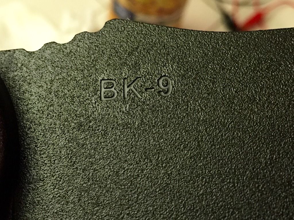

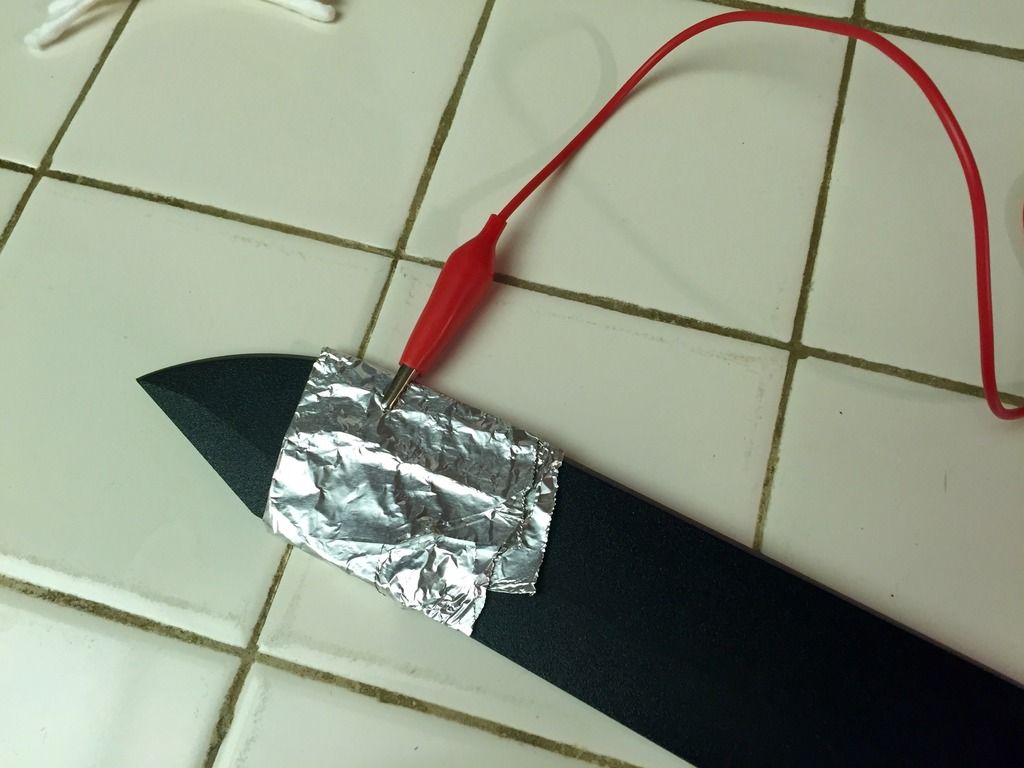

Well this got me thinking. I wondered if there was a simple way to increase the surface area of exposed metal on the blade edge without removing any coating. I don't know much about electrical work, but I did take 8th grade physical science. My experimental technique was NOT a complicated one:
It looked like it was working. But see if you can spot the big mistake I made here:
That's right. I let my Four Roses get too watered down. :grumpy:
But the aluminum foil worked like a charm:
I'd been meaning to future-proof this 9 anyhow. No plans to strip now, but I'll want to once the coating starts to wear. And now I don't have to worry about scratching off any of the laser engraving before it was time to etch and strip.
Well, that's a smart idea. I don't want to strip my bigger knives until the coating wears too, now I know what to do!
But first a return to basic questions: what the heck size are the tweener hex bolts? I had assumed they were the same as the big knives, I assumed wrong. 3.5 mm?
And btw I stripped a spot on my 15, and etched it just as instructed and it worked great. Thanks for gathering all of this info in one spot!
