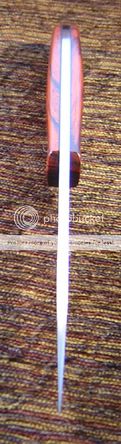

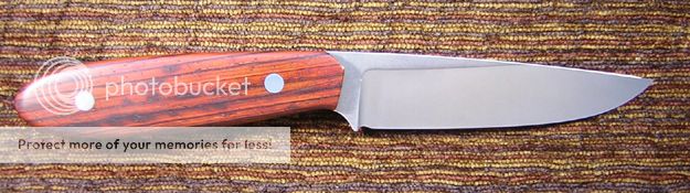

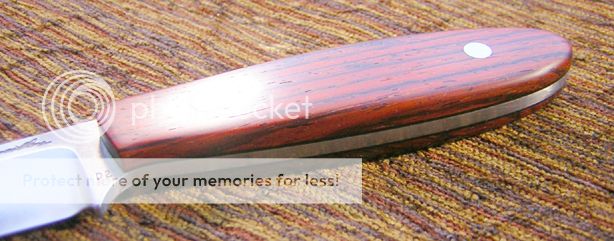

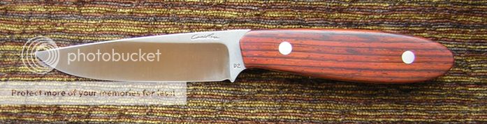

Basic drop point D2 hunter/skinner. Cocobolo.
Nathan the Machinist
KnifeMaker / Machinist / Evil Genius
Moderator
Feedback: +143 / =0 / -0
Feb 13, 2007
19,549
Blade is 3 5/8" hollow ground, 7 3/8 OAL. $140 Sold!
D2 with cold treatment and tempered to HRC 62. This is the perfect steel for this kind of knife (IMO) and this is a high quality HT that has been proven to perform. 304 stainless pins. Comes with a nice basic leather pouch sheath.
This has a high thin hollow grind taken to .018" at the edge, which is relatively thin, so it is not for rough use, but it cuts very well and will still withstand some abuse. It will be sharpened for your intended use before I ship.
I take checks, cash and money orders. I'm now also taking PayPal.
Thanks for looking,
Nathan
