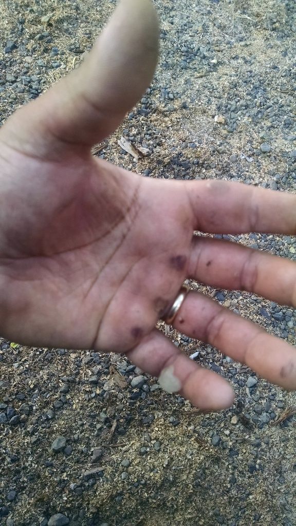

Maxiflex ultimate gloves will help with the blisters. Thin and comfortable, they provide amazing grip while keeping your dexterity. I wear them for any striking tool work now.
Nice, I figured the blisters would heal and my hands would be tougher.
Good looking out on the gloves though

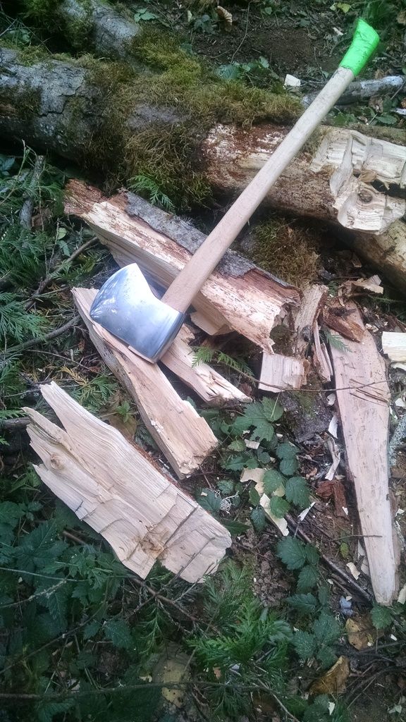

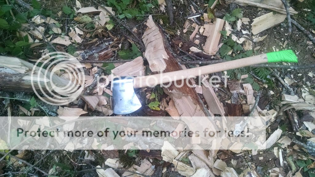

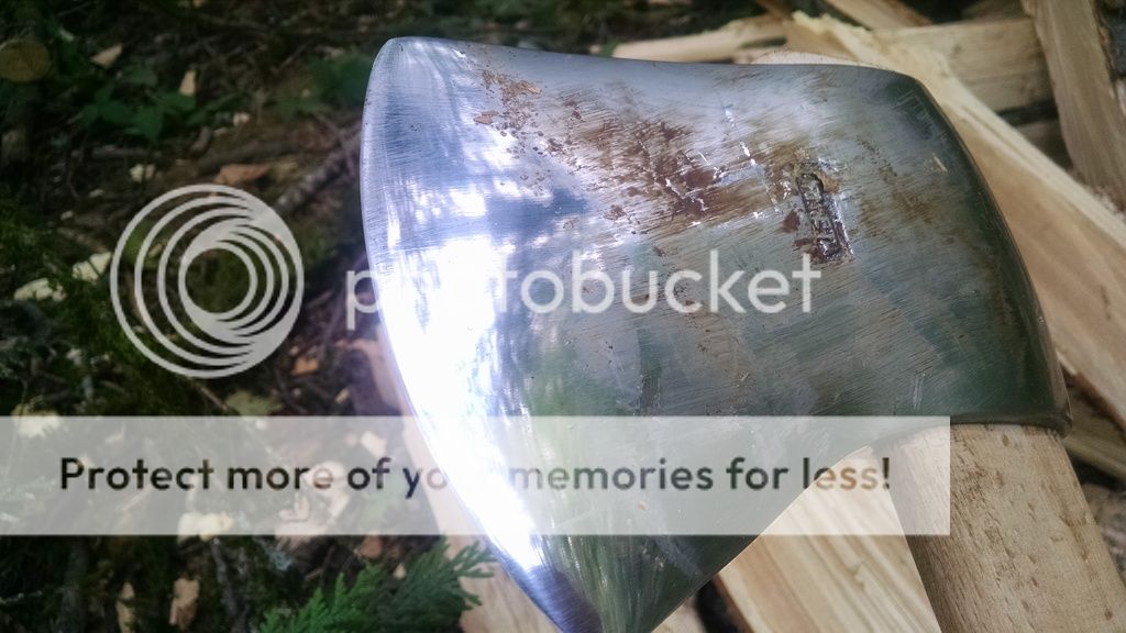

Pulled out the ol'miserly whip and made some rounds
Basque up some Firewood

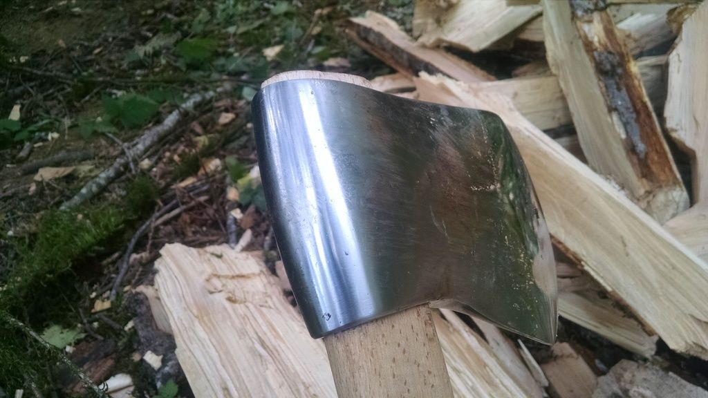

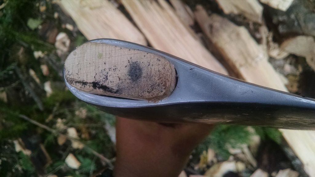

Sweet, thanks for sharing. How do you feel about the swell on the handle after using it? I've never used a haft with a swell oriented that way and it has always looked backwards to me, but there must be some reason for it.
When I'm fondling it. It feels anemic. But when I swing I don't notice it.
I think if I was doing more tree Felling I'd notice it more. But splitting and bucking I can't tell.

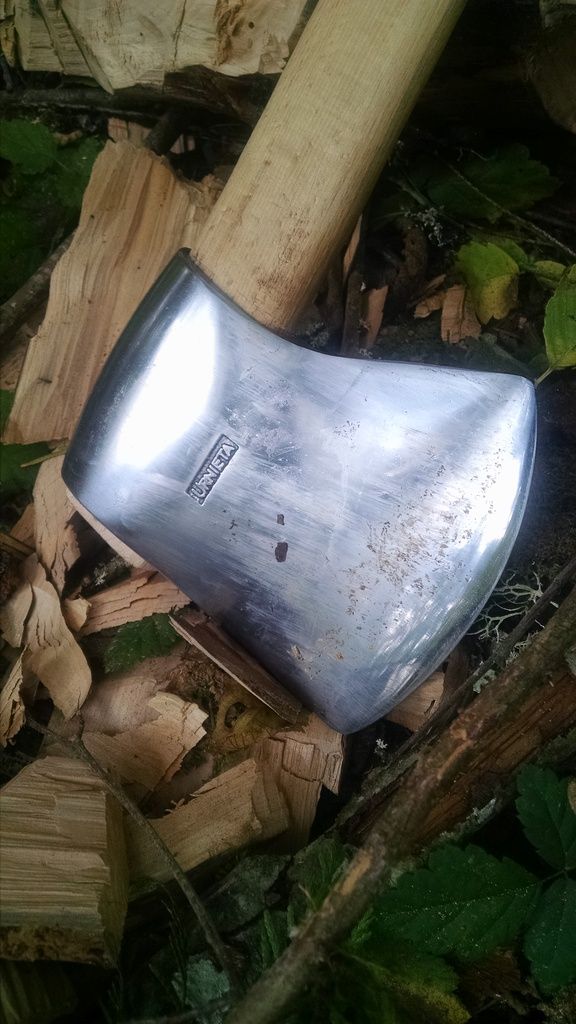

Glad to see these getting more attention! I love my basque axe, fantastic craftsmanship and quality. Especially at their selling price.
Haha dang it! Is that the 1.5kg from Lamina?
I went to purchase it last night but they were out of stock :O
It's a slip-fit haft so it can't have a proper swell. The little hook gives you a place for your pinky. I imagine the corner above that is what raised the blisters. A good swell will continue on past the heel of your thumb. That way the corner can't raise a blister. This is the problem with clipped fawns feet. It's why vintage hafts are better (or those made custom by guys like COTS).
The big reason for the gnarly blisters is the duct tape. I put a crack in the handle from trying to unseat the head like a tomahawk. The problem is that the bottom of the handle is at an angle.
I was hitting it at the wrong angle. Crack it, glued it, and reinforced it with duct tape until the glue set.
Of course I couldn't wait until the glue set and had to start swinging right away! Hahahaha

In all seriousness, if you wanted to keep a slip-fit head able to be rapidly disassembled and wedgeless, you could do a nicer version of this. I just hacked this out in about 45 minutes for giggles just to see if it'd work.
^ That's funny, of course you could [probably] still hang the head on a traditional handle using a real fat wedge and some fine tuning.

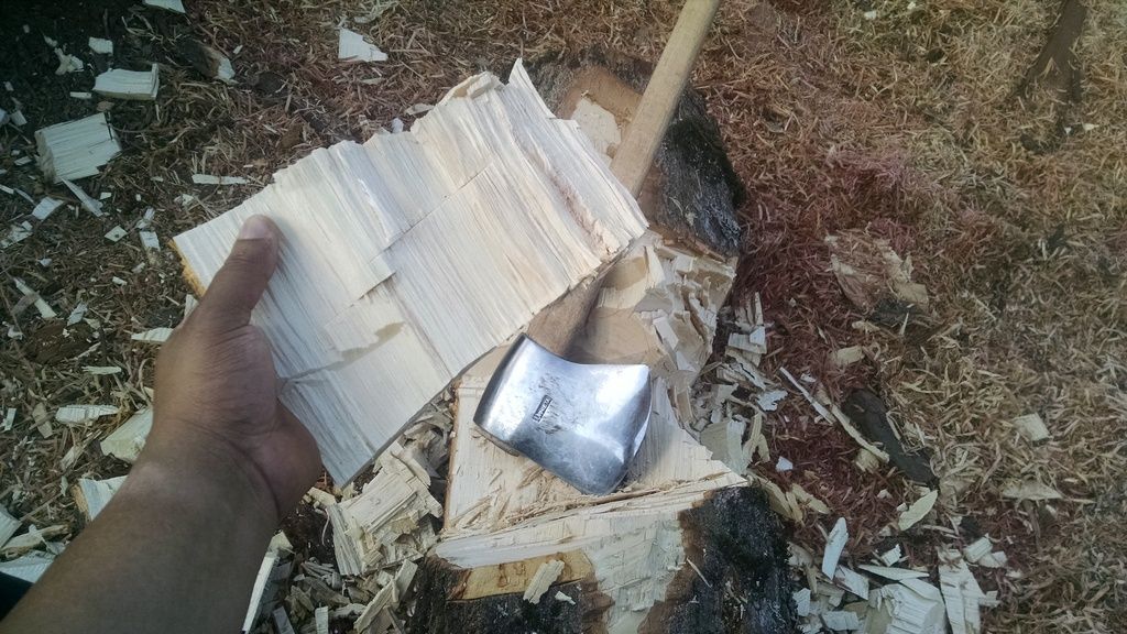

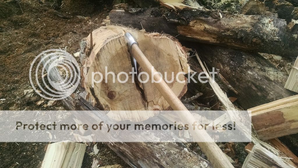

Time to share some more with you guys, I've been very selfish and have been just enjoying using this axe without caring to share.

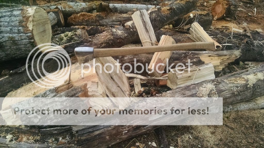

I've really come to appreciate this axe for wood splitting, its great for precision work but can be swung rapidly with the short 30" handle without sliding up and down. It really shines when using a Tom Clark "buster" technique on big rounds or laying knotty pieces on the sides and going straight in through them that way.
The handle is holding up fine, I have not really been giving it the TLC like my hickory handles but it doesnt seem to mind :D
