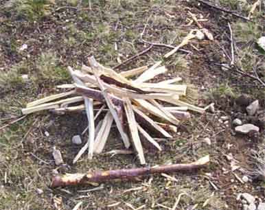

Locally most times you can find dry fresh woods, alder is common and it is both small and frequently dead. However in some places I have walked quite awhile (like an hour) and have seen little dead wood and thus scouting to gather wood for a fire would be problematic. Most local woods tend to burn poorly when fresh.
This is a bunch of birch split fairly fine :
This is a pitch bark fire, I use the finely split birch just as a test burn. It is rare around here so it is almost never burned. The tar actually boiled out of it, it didn't burn as much as just slowly char. I left a few pieces fairly thick and they actually ignored the fire and remained when the others had turned to ash. It is kind of ironic when you consider how great the bark is for fire starting.
