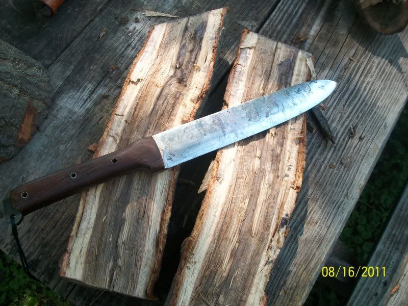

The wood wouldn't exactly co-operate today. (As in, it is wet, and the tree fell within the last 2-3 weeks.) As far as grinds, I prefer convex, since as previously mentioned, it tends to want to split the wood faster.

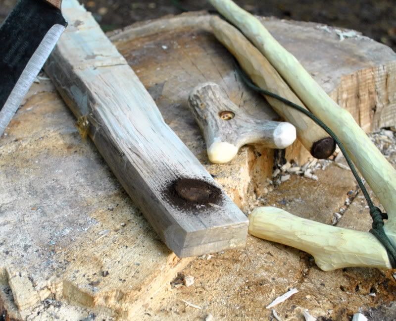

Thing is, batoning is - I think that I fail to get this across- batoning isn't a replacement for an axe (though I'm MUCH more likely to have a folding corona and a 4-6 inch leuku than an axe with me at any given moment and I NEVER ONCE used an axe when doing tree trimming/removal work). Batoning is a whole set of techniques for splitting and notching- chiselling- materials.
I would be happier making a chair using baton techniques than anything else- be the batoned item a chisel, axe, or knife. I'd probably pick a knife because draw cutting and scraping with an axe suck rocks, and both items would be involved in making a decent chair. This is something I've done- and it's not part of the minimum stone age throw-away-all-comfort emergency mylar survival packet. But it sure beats witting on a stump full of ants.

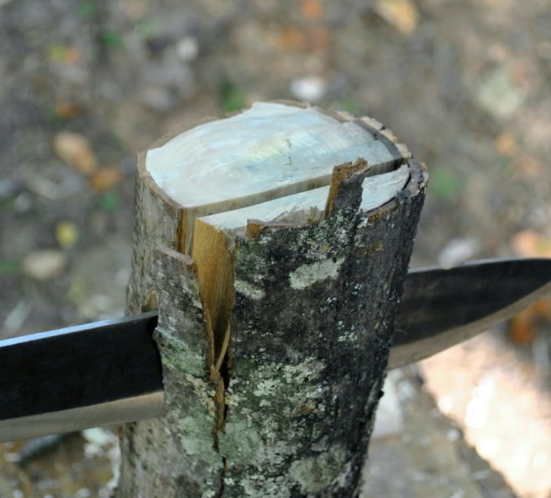

While 500 bushcraft savvy folks might well give 450 different answers, mine is that you baton when you need to make a fire. If what you find on the ground is wet, then you baton some of the wet wood to get to the dry wood. That seems fairly straightforward to me.
I like that one, is that a Koyote or Culberson ?

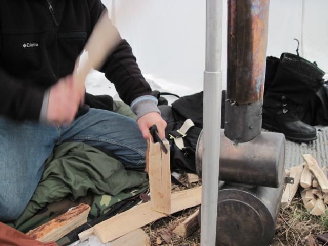

I use a Bic 95% of the time when in the woods because it is simple and works. Granted I can start a fire using all sorts of methods including fire steels. I would hate to be in a northern forest during winter without an axe.:( In any case batoning is also “holly mother of pearl its –22F outside and I am not going to the sled to get my axe”. :D

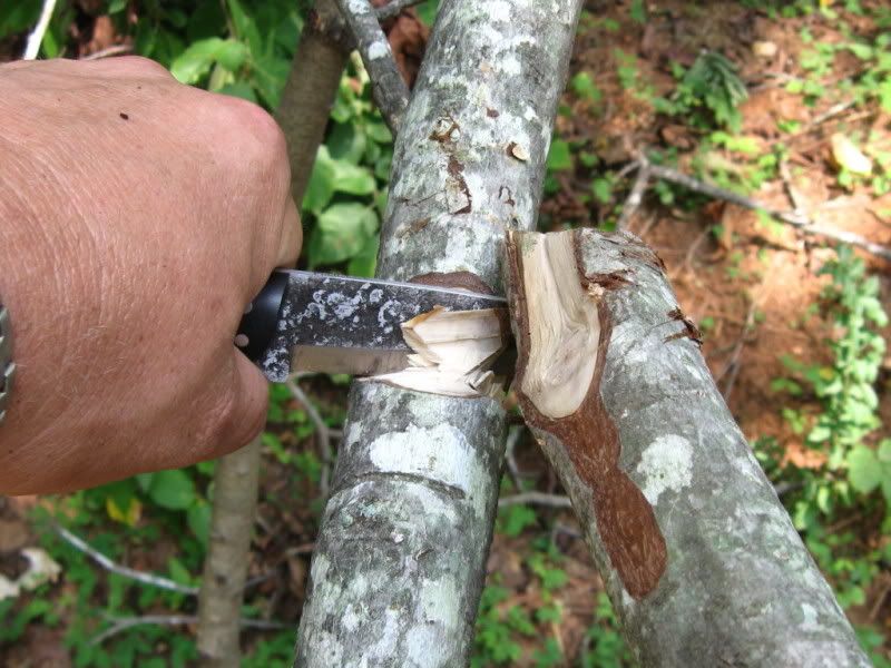

This was my friend’s first batoning. He used a KA-BAR because it was the only fixed blade in the tipi and volunteers to run outside and brush the snow out of the sled in –20ish Fahrenheit looking for the axe were few and far between.
Darn nice results for his first time.

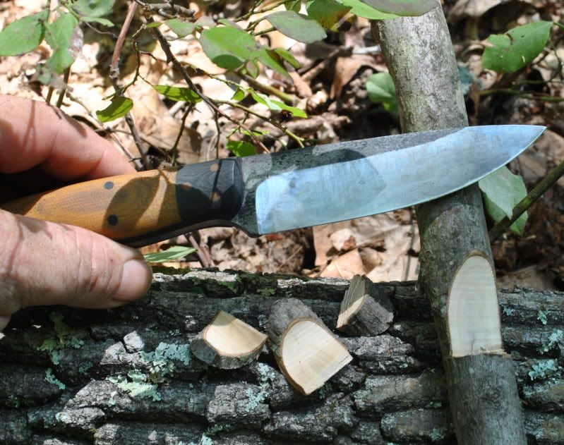

I'm by no means an expert when it comes to grinds, but if you wanted to get some insipiration for making a batoning blade grab an axe or hatchen and look at the blade from the top down. You'll notice that the overall shape is concave, but the edge is convex. I've wondered if someone could (or perhaps already had) made a blade with that same basic format. Start with some super thick stock and the thin it down drastically untill you get closer to a good blade thickness and then put a convex edge on. Good idea? Bad idea? I don't know, but I'm not a knife maker. All I know is that I have a cheap hatchet that takes a shaving sharp edge without too much work and retains it surprisingly well even after some serious abuse (It is my beater hatchet so it gets used to cut off old roots that I'm tired of pulling on, breaking down pallets, splitting firewood that likely has a nail or two in it and cutting fruitcake)
Funny thing is, I spent about 20 seconds trying to figure out if I did a profile like that and then realized the forge finish was Culberson and not me.
NICE PIECE.

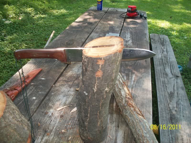

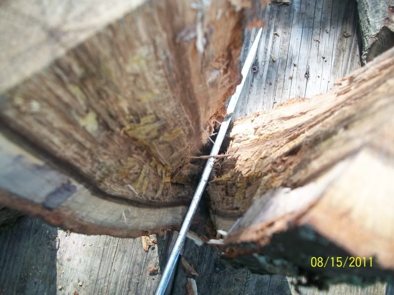

Well, I guess since Christof started the thread, I should post a Koyote splitting, too...
For just splitting wood (when actually using the wood for fire, not testing out a knife) I really don’t have a preference on grind or thickness. I seldom split anything thicker than 2 or 3 inches in diameter. I know that, as Ken pointed out, thinner blades do the initial penetration easier and are smooth all the way through but they have to travel further through the wood to actually split it so take more strikes. Thicker blades with steeper grinds are harder to drive in initially but don’t have to travel as far to split the wood, so you do have to strike harder to start with but less strikes on the whole so either way probably about the same amount of energy used. Besides I’m married, have two kids, and work multiple jobs…sometimes I like hitting something a little harder :) But I’m good with having a thin blade too as long as the heat treat and temper are good.

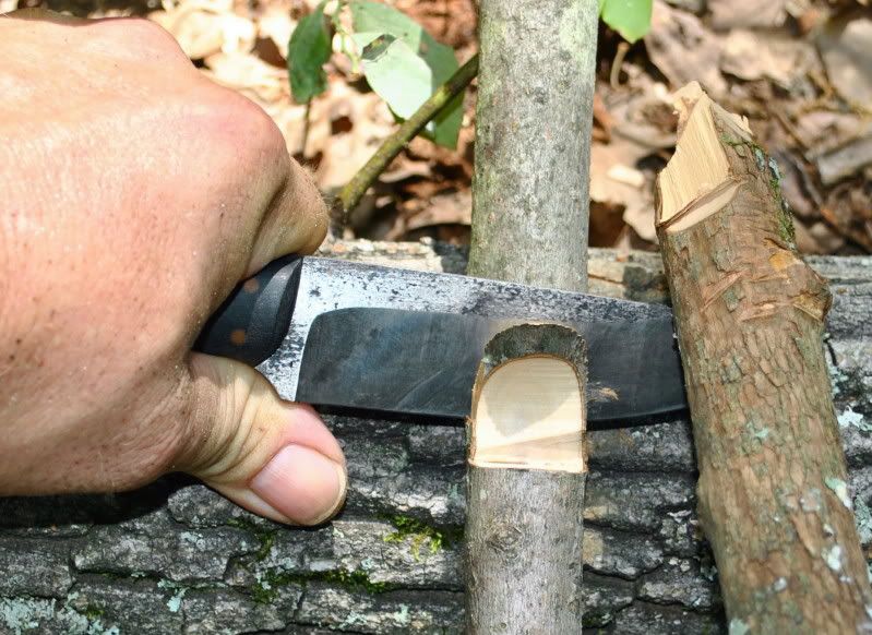

As for actually crafting things I prefer thinner blades and if they are thin grind doesn’t matter all that much to me. I have used machetes to baton larger pieces of wood
I can function with a scandi grind on a thin blade on a lot of things.

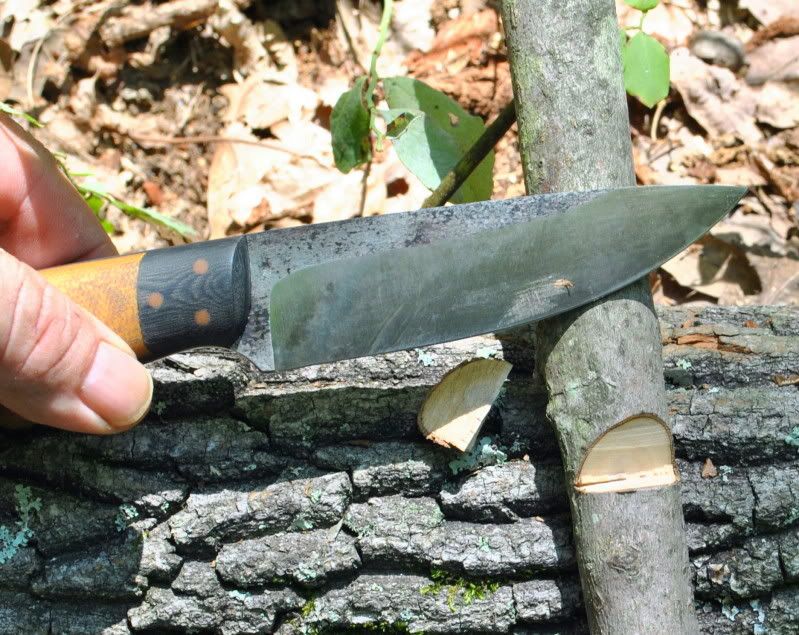

But if I do have a favorite grind and blade style then it is a high-saber convex with a shallow radius on a narrow-ish blade for a good combination of some strength of spine, strength of edge, and still has good slicing ability as well. It penetrates easily both with and against grain and is good for controllability in making small notches where wider blades can be a pain.
