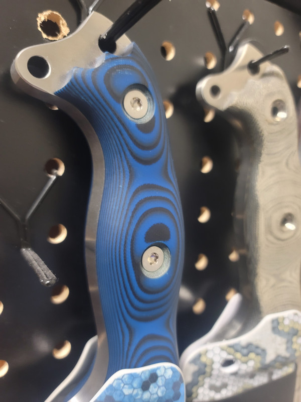

Hey! I picked up this Battle Grade Fusion Steel Heart the other day and it appears to be rusting underneath the cerakote/scales. See pics -
I threw the FSH in my friends sandblaster and gave it hell for 15 minutes - it came out looking like this. The rust is cleaned up and it looks like there is some faint pitting where the rust was the worst.
I'm guessing underneath the scales the rust is pretty bad? Anyone been here before?
Just my .02, if it bothers you just drill out the rivets, cerakote under the handles and use female standoffs and screws to reattach the scales. Be careful drilling out the rivets take your sweet sweet time you don't want to hit the scale or crack a scale.
If you can see it. Guaranteed it has seeped under the scales.
There's other knives with the same issue. Rust under the handle.
With the only way to prevent it is the sealing off of the scales between them and the metal. Epoxy.
What it really needs is removable screws (rivets), that allow the scales to be removed for cleaning. Then you could just keep it waxed.

Just a heads up the screws and posts come in various lengths, you want to get a female post that goes all the way through the scales and blade AND seats just below the recessed 1/4 part of the hole in the handle scale. Make sure the length of the screws you buy are just under 1/2 the length of the post. If they are over 1/2 you may have to grind them down or they will bottom out into each other and your scales wont be tight.
Also the screws are Torx Plus, it is a lil different than a standard torx bit and harder to find, definitely get 2 bits from the same site so you can hold one screw still and torque the other. A regular torx big works, but will leave a bite mark in the screw head, the proper bits will leave it unmarked for the cleanest install!

In my bag with 20+ Busse Kin there’s at least six fully stripped Battle Grades, including a THICK BGFSH, that have all been used and I doubt any have rust. That’s literally after YEARS of having them. Only one of them has a mustard patina I did, a BG Boss Jack. I guess I’m lucky.
I’ve said it a dozen times. I bought a LOT of Battle Grade stuff and my only regret is not buying more. The value in that caliber of Busse Kin won’t be seen again.
I say strip it, patina it if you want and then beat/use the hell out of it. Don’t re-coat it.
I am wholly impressed with this FSH. It deserves to be cleaned up and given a fresh outlook on life. It appears I'll be needing some 1/4" OD tubing. The material I drilled out looks like stainless. My options are stainless, brass, and copper. I might have some scrap 1/4" copper tubing laying around somewhere. Any reasons to not use copper?
Taking the pins out was sort of a delicate situation but with a little effort it all came out smooth enough. I can see how someone could damage the scales during this process without much effort.
The matte finish is pretty awesome, I've got to say. I hate to coat over it but I want to prevent rust from returning. The sandblast/matte finish is coarse and I can see it rusting quickly.
Besides cerakote, what are viable options for rust protection? I can spray paint the handle under the scales. If I used wax, is there a specifc wax I should use?
