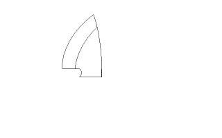

Here is my submission:
http://i544.photobucket.com/albums/hh327/dirtpig67/blade.jpg
My thoughts behind this blade would that it would be more of a skinner/game knife than the current blade profile of the RC lineup which are what I would call general utility.
Handle - I really like the RC-3 handle shape and size so I would pretty much keep this the same. I would use canvas micarta to provide a bit more grip when wet.
Blade thickness - .188" (same stock thickness as the RC-4 which would help with ease and cost of production)
Blade length - ~ 3.5 (exact geometry would need to be perfected after a prototype or two)
Color - same colors offered by RAT on their RC-3 lineup
Blade details
- Coated like all RC knives
- Would either have a scandi or flat grind (prototyping would help determine which would be better for cutting in this blade style)
- There is a small notch just in front of the handle before the cutting edge of the blade. The purpose of this is a dedicated spot to use a firesteel so you do not have to use the blade edge to use it. It would have to have a slight edge on it and would not be coated. I drew the area as curved but a straight edge may work better when using a firesteel.
RC3 with no choil and thicker scales. Perfect. Everything else is already excellent. dirtpig, send me the pic and I will post it for you.
This is from dirtpig.
You can also sign up for a free photobucket account and post from there.
