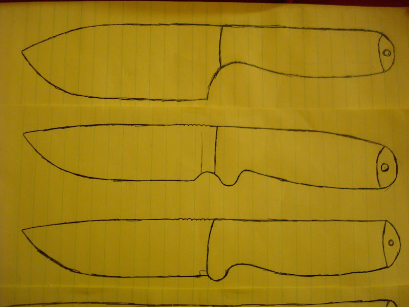

Here's my submission, revision 1.0 of the mckrob RC Scandi Bushcraft:
This is based on the RC-4 blank, with a 1/2" extension to handle, 3/16" removed from the blade tangential to choil, ground almost to handle, triangular RAT lanyard hole. Handle in Orange or Yellow G10.
I think it would have to be 3/16" thick for the scandi grind, but maybe 1/8" would suffice.
I think this maintains the "spirit" of of the Rat Cutlery design, with the handle and spine profile unchanged.
What do you think ?
