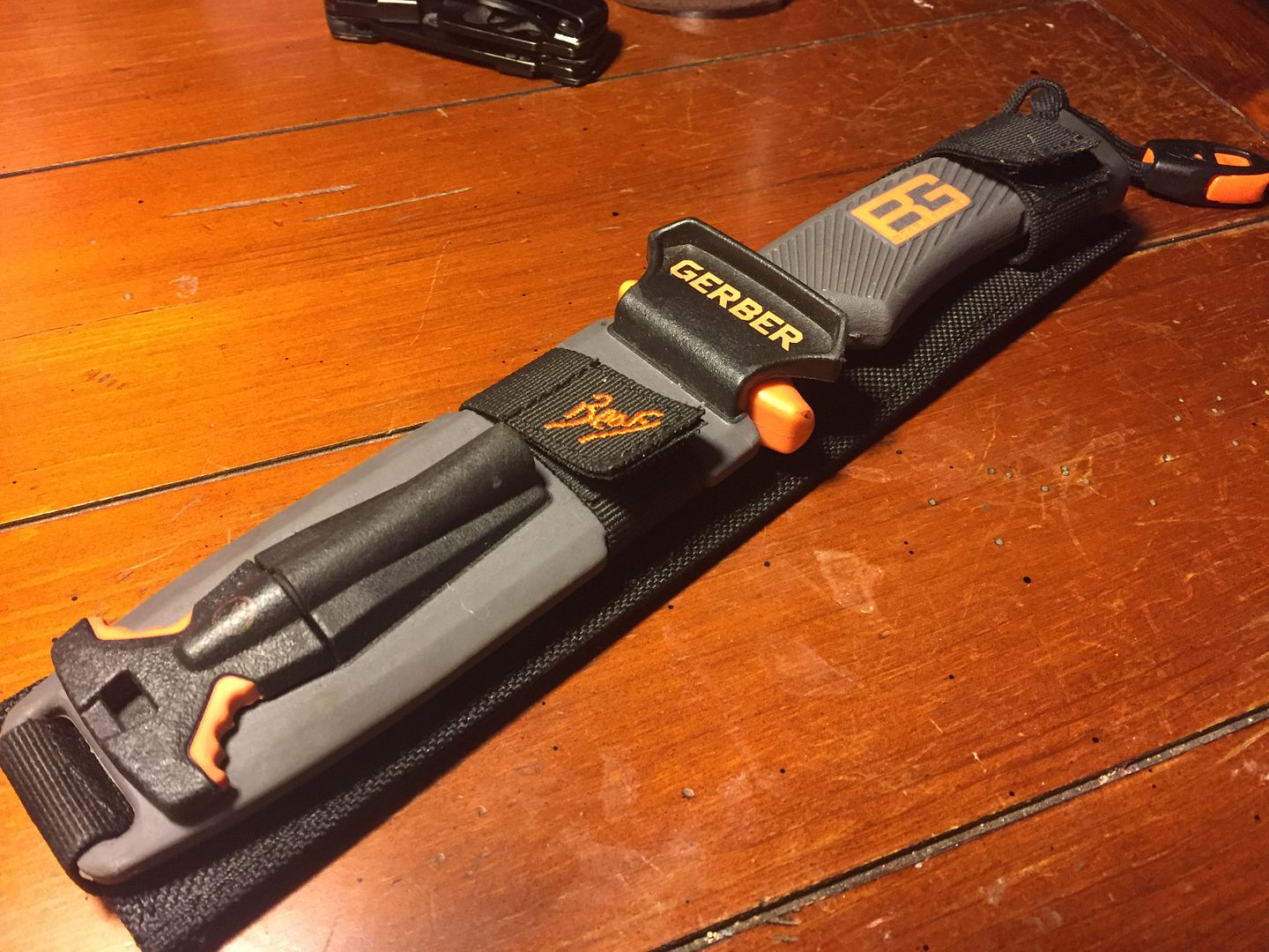

Yes...I know, it's Bear Grylls ;) BUT, it is actually not bad, especially considering the price point and how solid it is, so 'Bear' with me as I cover the particulars of this knife.
This is the updated version of his original Ultimate knife, the Pro being the part of the name that is suppose to help set it apart from the first. I've not handled the first version but seen some youtube reviews and while it wasn't bad, it wasn't all that great. Gerber has taken the stance to help better this knife and it shows.

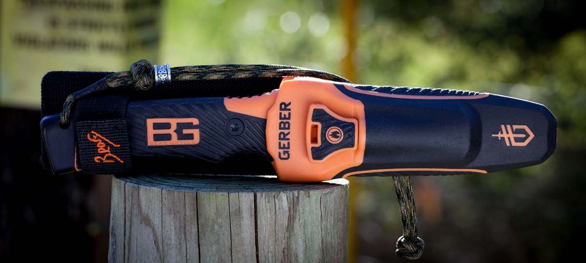

I've added a paracord lanyard, the whistle is not attached to the knife/sheath I'll carry it separately. It is quite loud and would be an attention getter, maybe not so often that you are lost in the woods and needing rescue, but there might be times you need to attract the attention of your friends while on a hike, or needing some assistance and your voice just won't carry as far as a high pitched whistle like this, plus you can save your singing voice for some campfire songs later on...:)
In the sheath you see the part below the Gerber name, that's the firestarter, it measures 1 3/4" long and about 1/4" round and it also has an O-ring to help keep the tube it's in from collecting water during carry.
I've not tried it yet but handy to have, most might prefer a larger one but having one right on hand may be of use if your other one is packed away.
On the back of the sheath is a place to draw the blade across some carbide bits to do a quick field sharpening if needed, you can also switch sides in case you prefer having them on the other side of the sheath.
Overall I probably would like to get just a very simple kydex sheath made for this, but I'll see how it goes.
The knife is retained by a velcro strap at the top of the sheath, but also the sheath has bumps that snap into place into the holes in the guard of the knife, holds pretty securely too.
The belt loop is probably the weak link in this sheath, being a bit short in length, while it measures 2" it is very tight to the backing, but my 1 1/2" wide belt did fit into it easily, you can remove that entire bit of belt loop by taking two screws out, might even add a better loop using the attachment bits that are beneath it.

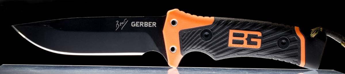

Blade Steel Type: 9Cr19MoV
Blade length is 4 3/4" long, 1 1/4" wide and 4.7 mm thick at the spine
Edge Bevel measures about .032" so not overly thin but feels thinner than that, pop cuts paracord easily and sliced cardboard as well.
The grind is a saber grind which would help with batoning if it was necessary but still ground down to a smooth transition to the edge which on mine arrived shaving sharp, surprisingly so. The new model boasts a higher grade steel 9Cr19MoV, supposedly on par with 440c steel or slightly below that level, I'll find out how well it keeps that edge.
The handle measures about 5" long with well positioned guard below and above, the tang is full on both of the guard areas so they are solid with a layer of hard plastic to help widen the guard for a more comfortable grip/protection, also there are two lashing holes in the guard as well as the lanyard hole on the end if you ever find yourself in need of making a spear of some kind.
The handle is for the most part flat sided but swells out slightly as it nears the steel pommel that can be used as a striking tool. Now that was the part that swayed me from the Buck Selkirk, while the handle on the Buck was very good and protected you from moving up onto the blade, it was still more oval and could twist in your hand in use, where a FLATTER type set of scales will provide better traction and overall control, much more secure feeling when gripping this knife! The rubber inlays are hard but have nice texture that should provide a good grip even while wet, I know a lot of people might hate the BG logo in the middle, but I don't mind it, if you set this down, you're going to find it pretty easily!

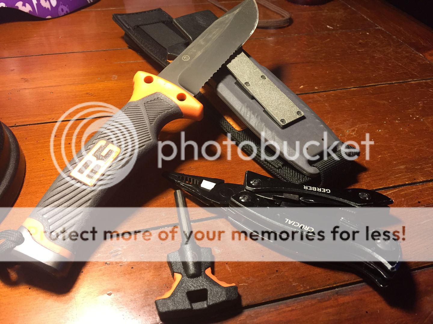

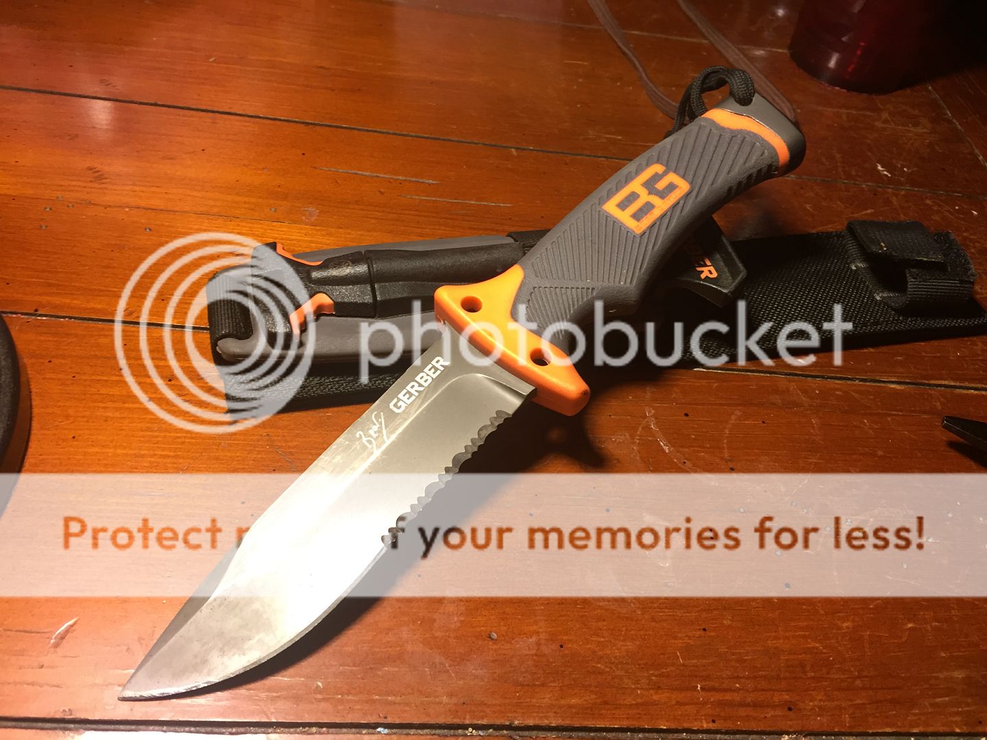

Here are a few images of this taken today;
BG_sheath.jpg~original

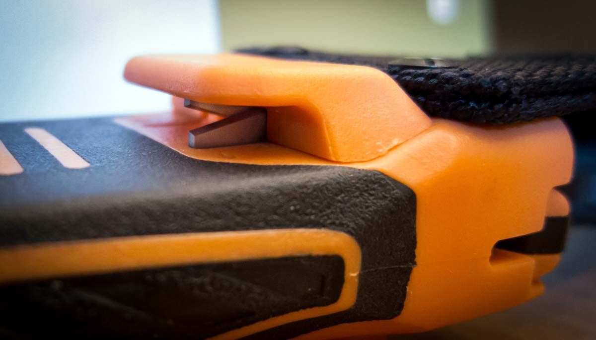

Just above the words Bear and Gerber on the blade, you can see a brighter area on the spine, that's a 90 degree part to use to strike against the fire starter.
BG_knife.jpg~original

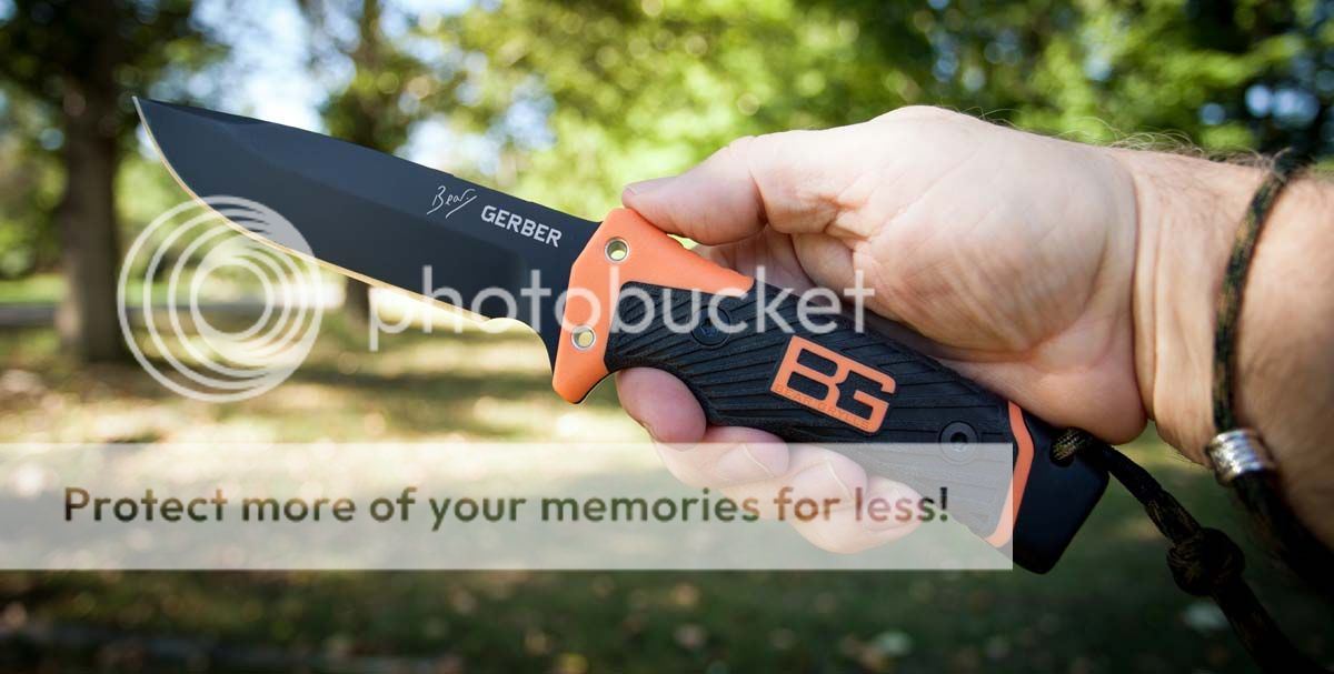

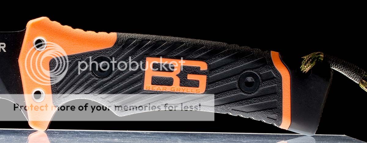

Handle does have some subtle contours but overall a flat surface which helps to keep the knife under control, in this photo you can see the texture of the hammer end of the handle
BG_handle.jpg~original

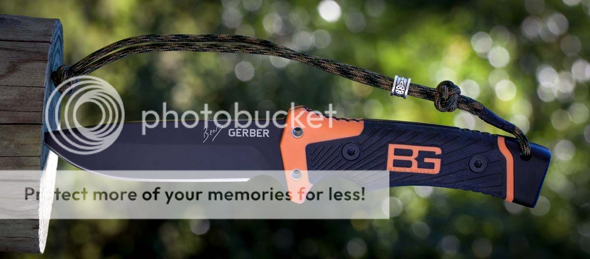

An in hand shot with my lanyard on, the celtic bead slides up to my wrist to act as a keeper, the black thread whipping near the handle helps to keep the lanyard out of the way if I need to use that end for hammer type strikes on what ever might need hammering, tent pegs, breaking up rocks for a fire ring...etc
BG_lanyard.jpg~original

One thing to note about the blade on this, the tip area from where the curve starts, they made that just slightly thicker than the straight part of the blade, giving that tip area a little more meat/strength behind it.
Also the handle, just noticed that from the spine of the handle, it slims down to the bottom edge of the handle as well, it's a very comfortable knife to grip and use, yet you don't feel like you'd lose control of it, just a good textured handle, well shaped.

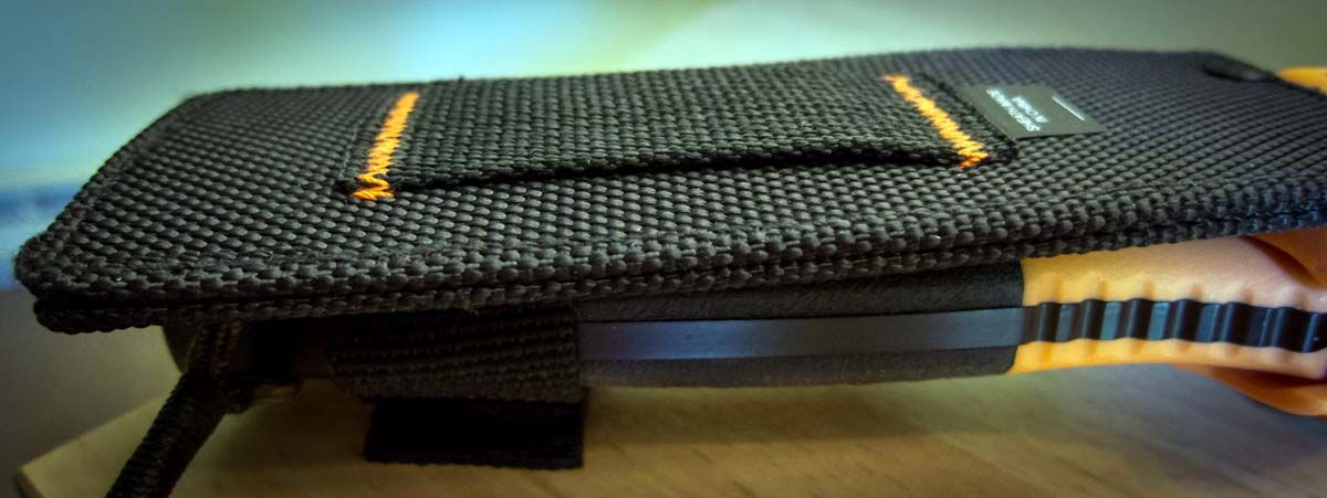

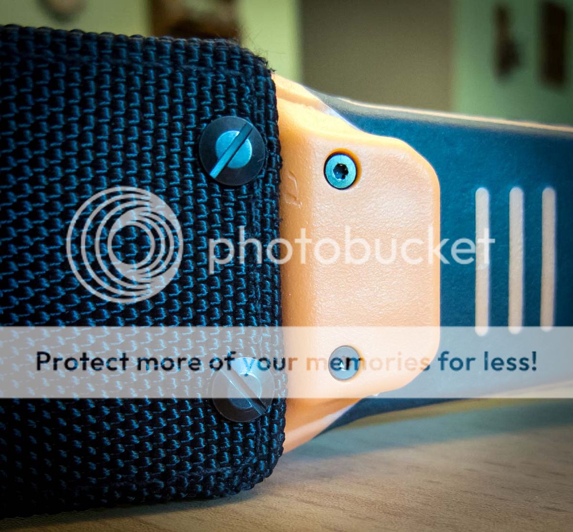

The belt loop is well stitched and my 1 1/2" wide belt fits through, snugly since the belt loop is sewn tight, the opening measures 2" but it would be a trick to get a 2" belt through I think.
Also the construction of the belt loop backing it's sewn to is very stiff, which is good as I've seen some that are just loose fabric with no substance, but being rigid, you can pull the knife out without it buckling, not bad at all.
BG_belt_loop.jpg~original

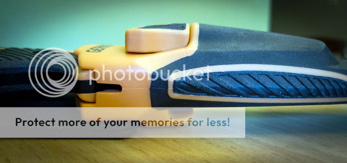

My one grump is how thick the sheath is but I can not see how they could have made it any trimmer and still provide the devices included, certainly well made and form fitted! but thick, it's about 1 5/8" so it stands out on your side pretty well.
BG_sheath_sideview.jpg~original

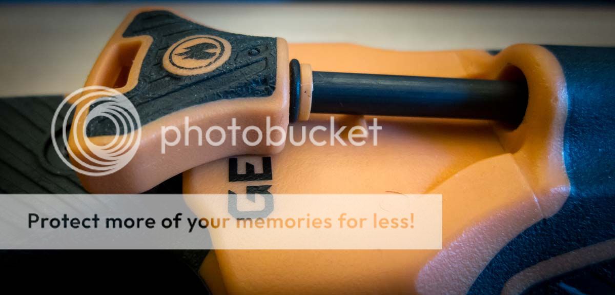

The Fire Starter, it's retained by the small wedge of plastic that it slides over and locks in place, making attaching anything to the loop end pretty much not a good thing, I did try putting the whistle lanyard on it and while it worked, it wasn't as secure in the sheath since the back of the fire starter is raised up.
In this photo you can see the O-ring they put on the Fire Starter to help keep 'stuff' out of it's socket.
BG_firestarter.jpg~original

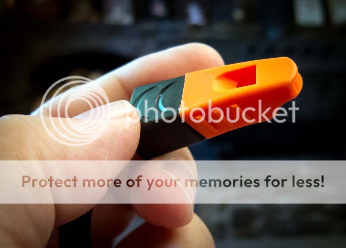

and the whistle, not too large but is quite loud, comes with a non removable lanyard cord attached
BG_whistle.jpg~original

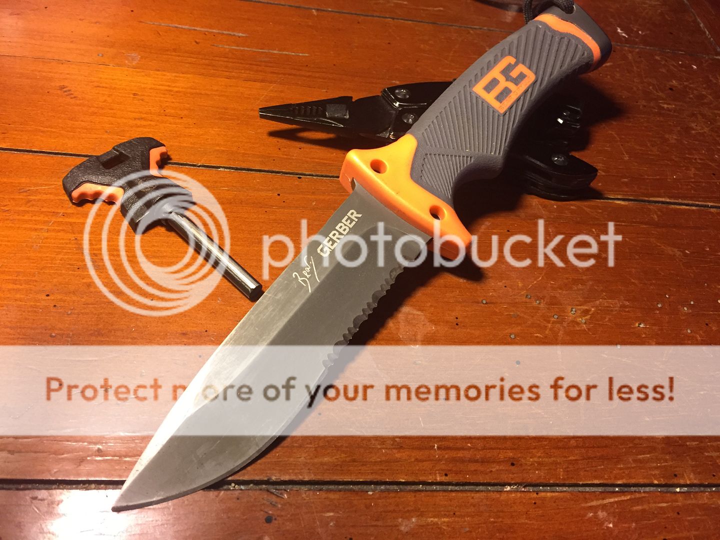

Pics for comparison:
In its sheath
Out
Sheath folded over for sharpening

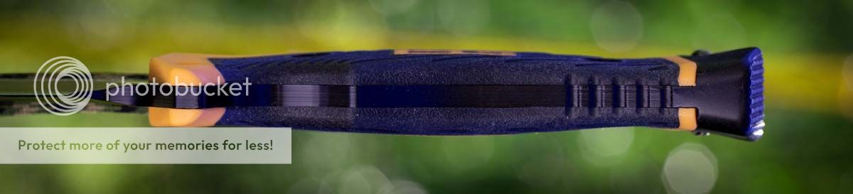

and here you can see the texture of this grip, I'm pretty hyped on how well it feels in use, very solid and a lot of control
BG_handle_closeup.jpg~original
