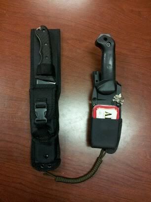

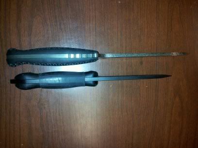

As it was mentioned by 42, the SCHF9 was designed by mistwalker. This knife is a sleeper at a bargain price. I haven't had any looseness or rattle - the tang holes are theaded and I put loktite in them just in case. You don't see many knives with threaded screw holes at the tang. The steel is 1095 - same as the BK2 - and it's a 1/4" thick - again, same as BK2. If you spend enough time hand sharpening your tools, a recurve blade should be no problem. On the sheath: I was really impressed. The plastic insert actually grips the blade via inside channels, thus eliminating rattle. The pouch is attached by velcros so you can remove it if you want a bigger one. I had no problem stuffing a small altoid with fire goodies and a vic bantam. The back has straps for MOLLE attachments and the belt loop has a velcro for easy removal without removing the belt.
And you get all this well-thought package for less than 40 bucks.

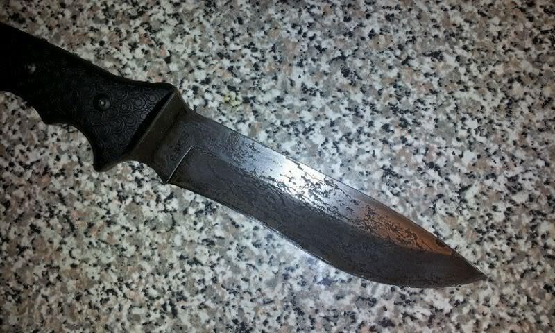

I cliched mine just preserving the cool griffon logo and the model number, and I will get down to find something to destruct with it :D
search for "clich" or go to the becker sub forum, plenty of info. After stripping and some light polishing, dab the blade with gun blue and then dip in bleach for a couple of hours, then pull out, spray with windex, sand again and then blue. Mind you, this is a permanent scarring of the surface of the blade.

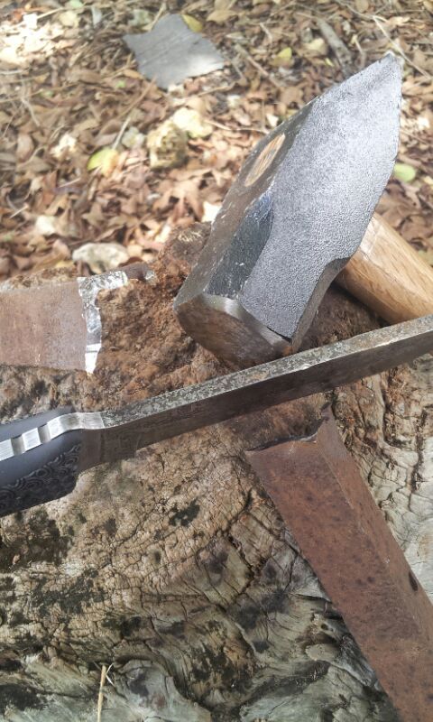

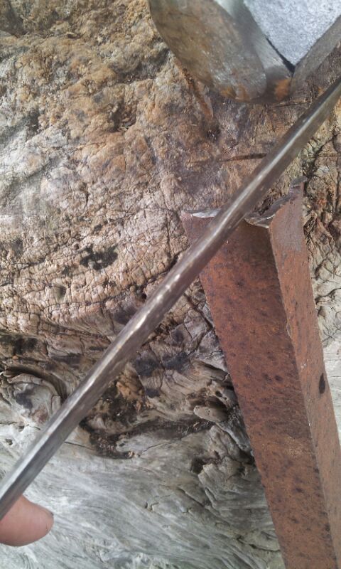

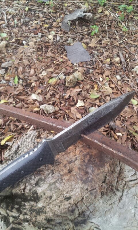

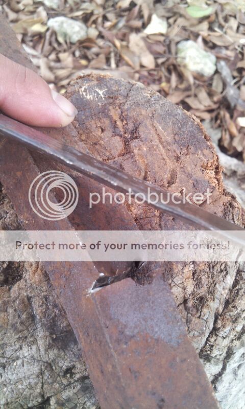

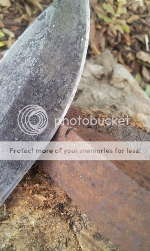

did some destruction today with the schf9. After processing a lot of branches (the recurve is excellent at snagging them, kinda like a kuk) I found a piece of rusty angular steel on the backyard. The wood batton didn't last much so a sledge was brought to finish it up.
some bending and rolling, but no rips nor anything that 5 minutes on the belt didn't fix. I didn't measure the steel thickness but it's over 1/8".
Gotta get me some other stuff now :D
That's pretty dang impressive for just about any knife.
Thanks for sharing that, Zulu! I like rooting for this knife because its an underdog and (like you said) kind of a sleeper, and now that you're showing what kind of abuse this 40 dollar knife can handle, maybe there'll be a couple fewer haters out there!

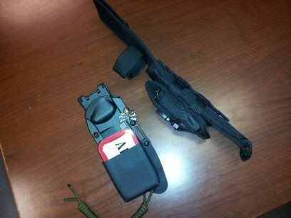

lol. yesterday after I took it to the belt I spent some idle time with a coarse, medium and fine grit diamond pads and then a thorough stropping, this thing shaves so easy right now, no signs of damage anywhere. Oh, and I forgot to mention - the strap is adjustable. I've only seen this in Spec-Ops sheaths. I still have to find something about this knife that I dont like.
Do you mean the snap strap that wraps around the handle? Or are referring to folding the main (vertical) sheath strap down for a high hip carry?
